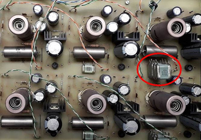

I don't know, I haven't tried other types in the RIAA circuit. Worst - soundwise, or measured?I take its not part of the RIAA stage? I was reading that silver mica are the worst worst to use in an RIAA circuit. Not sure why, but it might be something to do with their ESR?

Not the ESR, but dielectric absorption, which is particular loss mechanism having a very small global impact on ESR, Q, tan delta or whatever you name it, but capable of creating very specific problems, for example equalization inaccuracies, smearing of signals due to settling time and lagging effects.I take its not part of the RIAA stage? I was reading that silver mica are the worst worst to use in an RIAA circuit. Not sure why, but it might be something to do with their ESR?
In a RIAA circuit, it will degrade the equalization accuracy because the LF value of the cap is larger than, say its 1kHz one.
If you use nominal values, the LF's will be overcorrected.
The circuit might be designed around specific mica caps, taking into account their imperfection, but even so it cannot be perfect because the capacitance is not pure.
PP caps are accessible, and show very little dielectric absorption.
Keep mica for HF applications

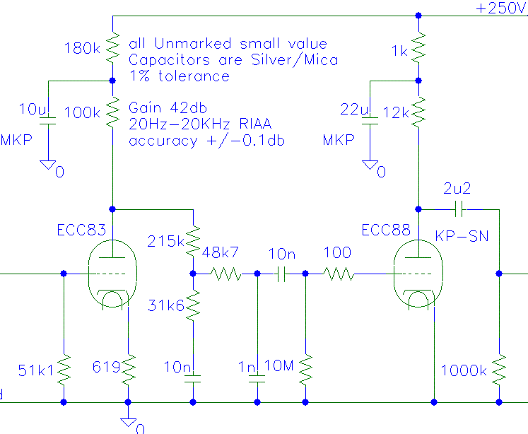

Just throwing it out there, this is an extremely nice sounding phono preamp from the legendary Thorstens
Looks tempting to build! I dont know what one to go for now lol I was told by a mate that the other one was a very good design.
I believe its a bit of both, all i know was the guide said it preferred polystryene, film second and stay away from mica or ceramic.
the quote below seems to shed more light on this.
Some schematics do specify mica after looking at a few.
OK, interesting to hear, the schematic shoog posted appears to be a well regarded design and specifys mica caps.
