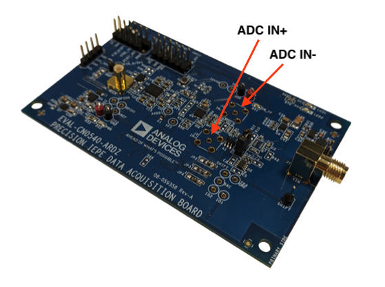

So although this is a single channel version of the 8 channel 7768, the board has some hidden features:
Firstly - single and differential:
These two ports marked are the differential input, straight into the ADC.
Second - the ADC digitises from Vref- to Vref+ and in this case using a 4.096Vref chip this is a decent voltage range for the differential. The single ended has additional hardware setup to cope with up to 10V, plus has programmable offset from 0-5V.
Lastly - the maximum performance is 1024Ksps, although this depends on the digital filter used within the ADC.

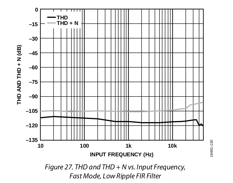

The performance is a decent THD/Noise and the sampling noise (given the rate) is neatly above the audio spectrum.

I'm considering creating a spectrum analyser using this ADC7768 based development board - at 256KS/s 24bit:
https://www.mouser.co.uk/datasheet/2/609/cn0540-2256468.pdf
This seems to provide a very good starting point for an Arduino based ADC for analysis software (ie python or other) that could run via USB.
Any thoughts?

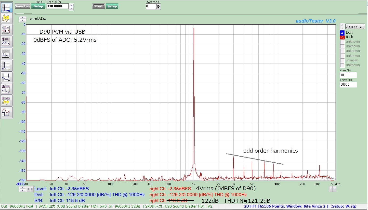

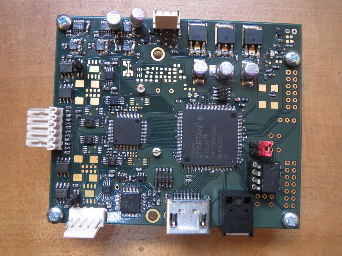

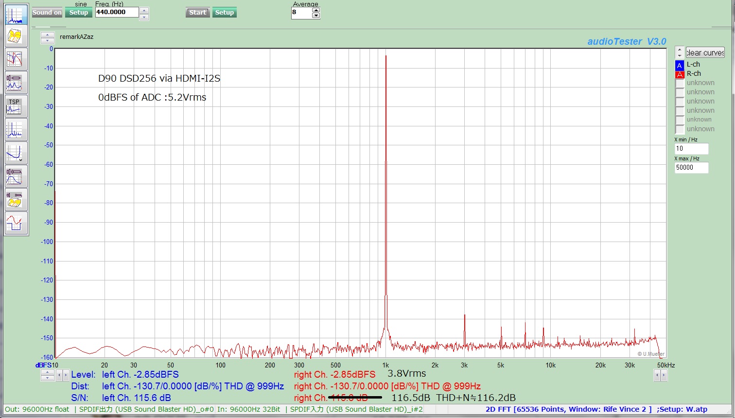

I have designed an ADC board with AD7768, where four ADCs out of eight are active. After trial and error, I gave up using eight ADCs because the THD of eight ADCs is inferior to four due to the difficulty of simultaneous driving of eight ADCs, though eight ADCs mode has better SNR. But four ADCs one has excellent results. The output is SPDIF(96kHz) or I2S(LVDS via HDMI).

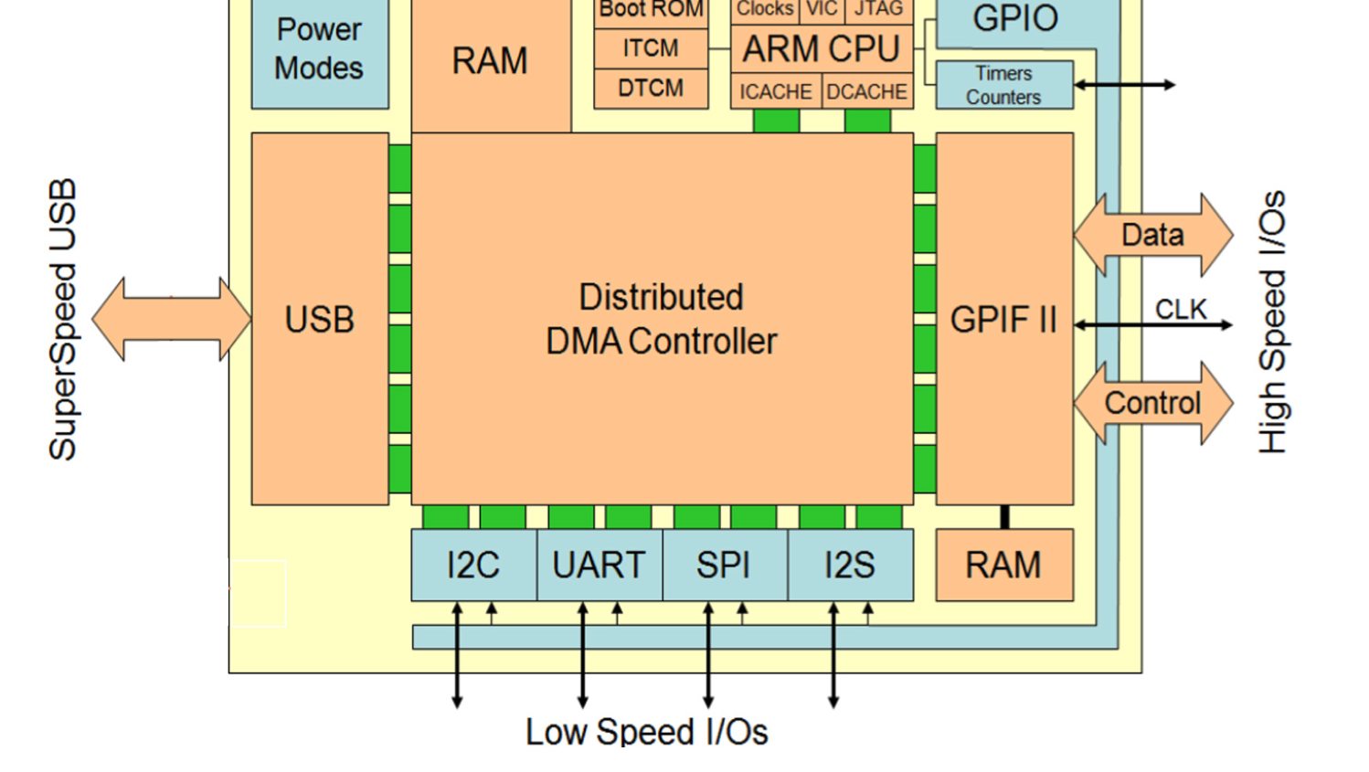

Something like this could offer a hardware controlled FIFO'd parallel byte port for the CPLD: https://www.cypress.com/documentati...sb3kit-003-ez-usb-fx3-superspeed-explorer-kit
I would expect that without the hardware to support the DMA, it wouldn't keep up with a direct SPI connection to the ADC. So the CPLD would only need to convert the SPI to parallel data (I would assume 8/16/32 bit width) and handshake the FX3.
An application note here: https://www.cypress.com/file/136056/download
This shows that the interface clock is 100MHz, the cypress has a programmable hardware interface so you can create waveforms and the system will operate those on the pins in realtime (I used this for the data transfers for the camera).
Makes me wonder if, actually, the FX3 could be programmed to read SPI at the rate required for the ADC by itself 😀
In default SPI functionality, you can operate the SPI up to 33 MHz (mentioned in the datasheet).
But in case of Big-banging, you will get in the order of ~ 500 kHz.
The regular SPI clock frequency can be configured using CyU3PSpiSetConfig() function.
SPI-clock calculation: The maximum SPI clock supported is 33MHz and the minimum is 10KHz. The SPI block needs to be clocked at 2X the interface bit rate. The clock for the SPI block is derived from the system clock through a frequency divider. As the hardware only supports integer and half dividers for the frequency, the firmware uses the closest approximation to the desired bit rate.
So the answer is 33Mhz using the hardware SPI interfacing. 😢 so the only way todo high speed is through the GPIF (ie the configurable waveform interface) which has a clock rate of 100MHz. The bit-bang above is where the ARM core is toggling the signals rather than the hardware GPIF.

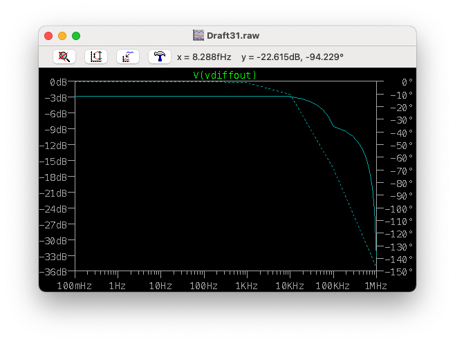

A quick check of the schematics for the CN0570 board and it shows there's a filter in place:
However that's to offset the frequency response of the ADC driver, so I think the entire talk about filters and 54Hz is a little moot.
