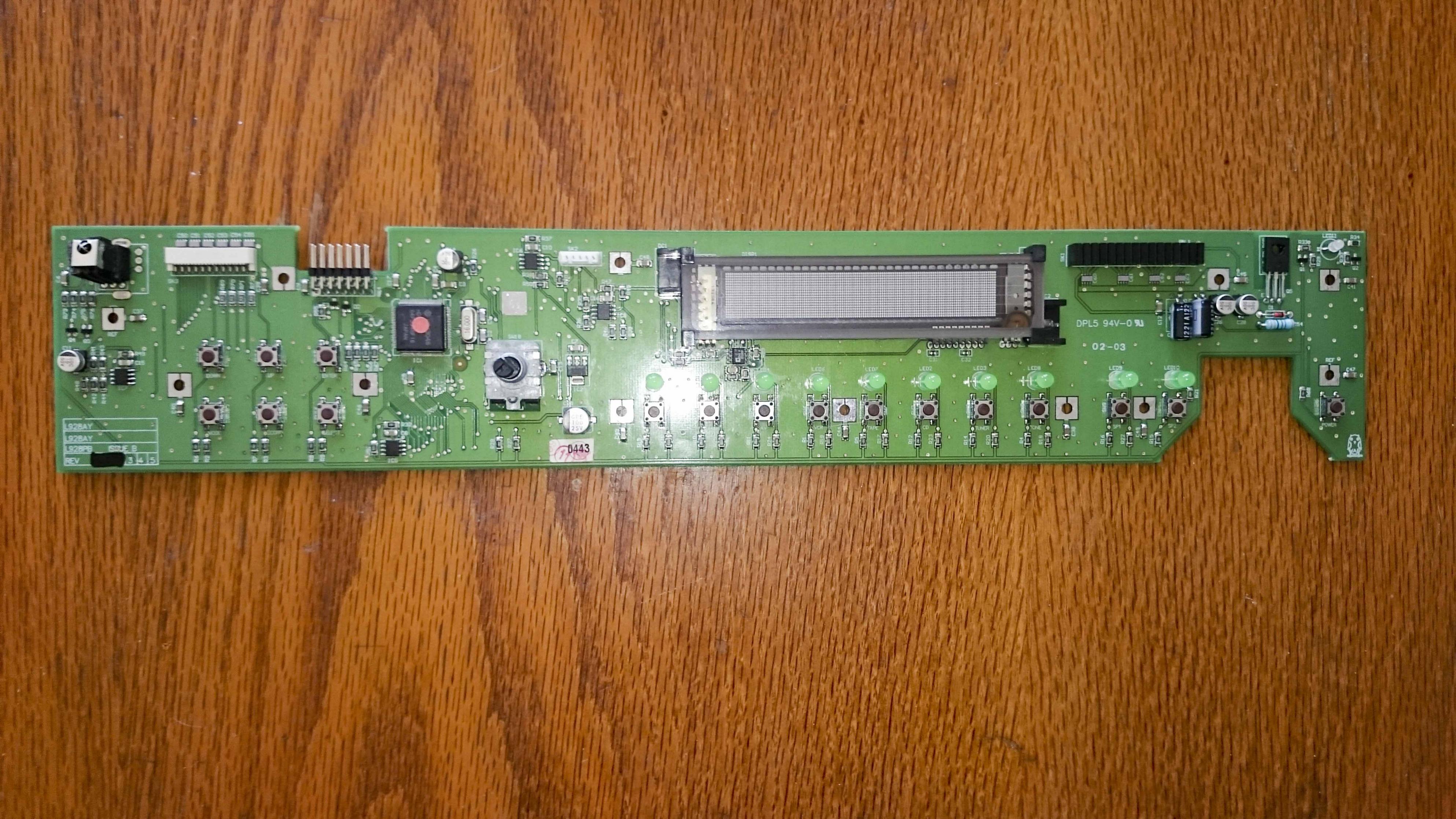

This is my 2 project I worked about a year
arcam fmj a32
and
denon dvd 2900

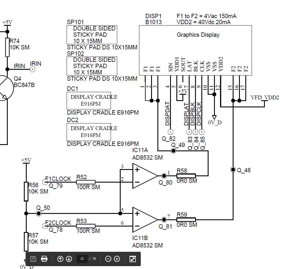

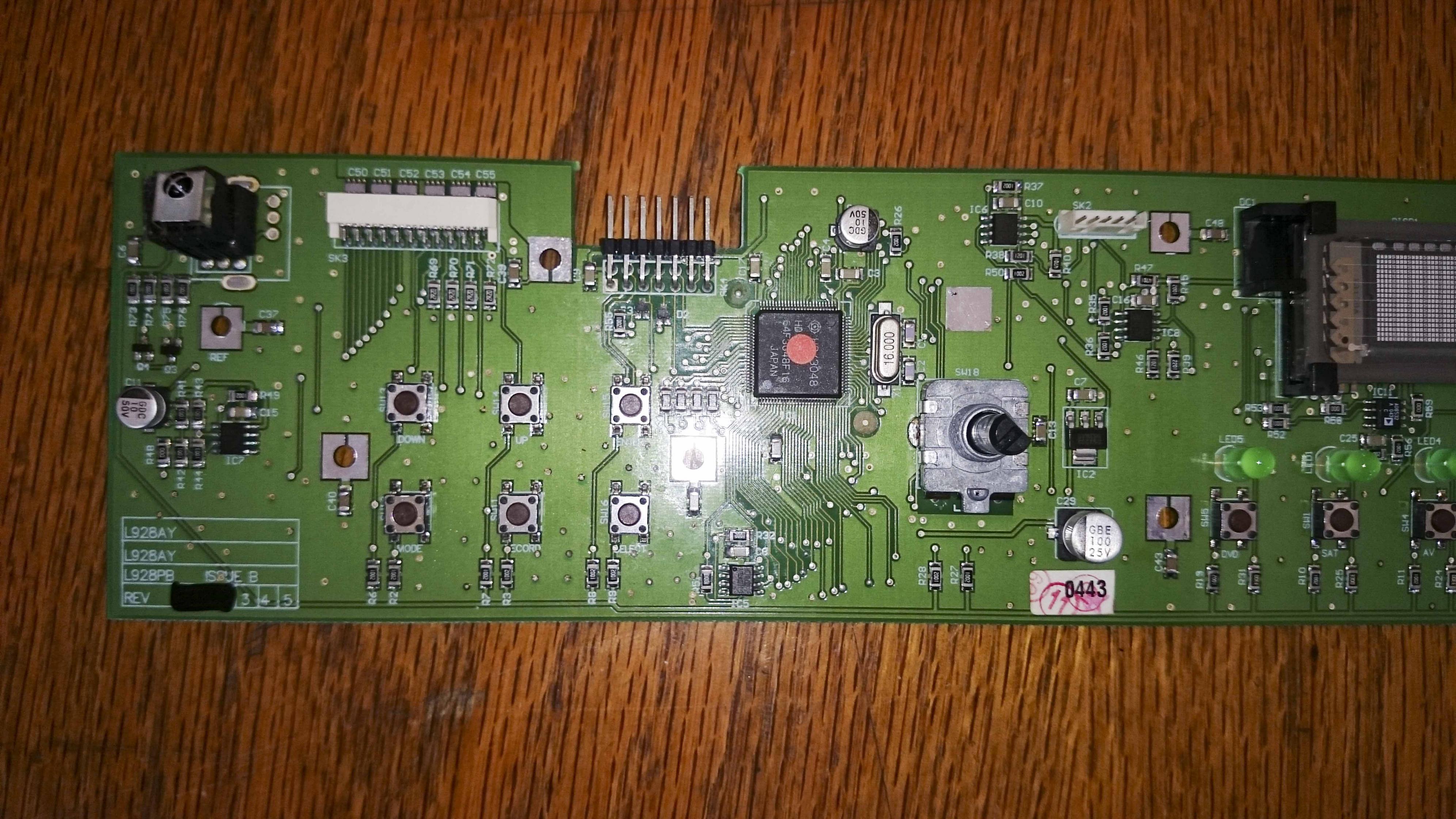

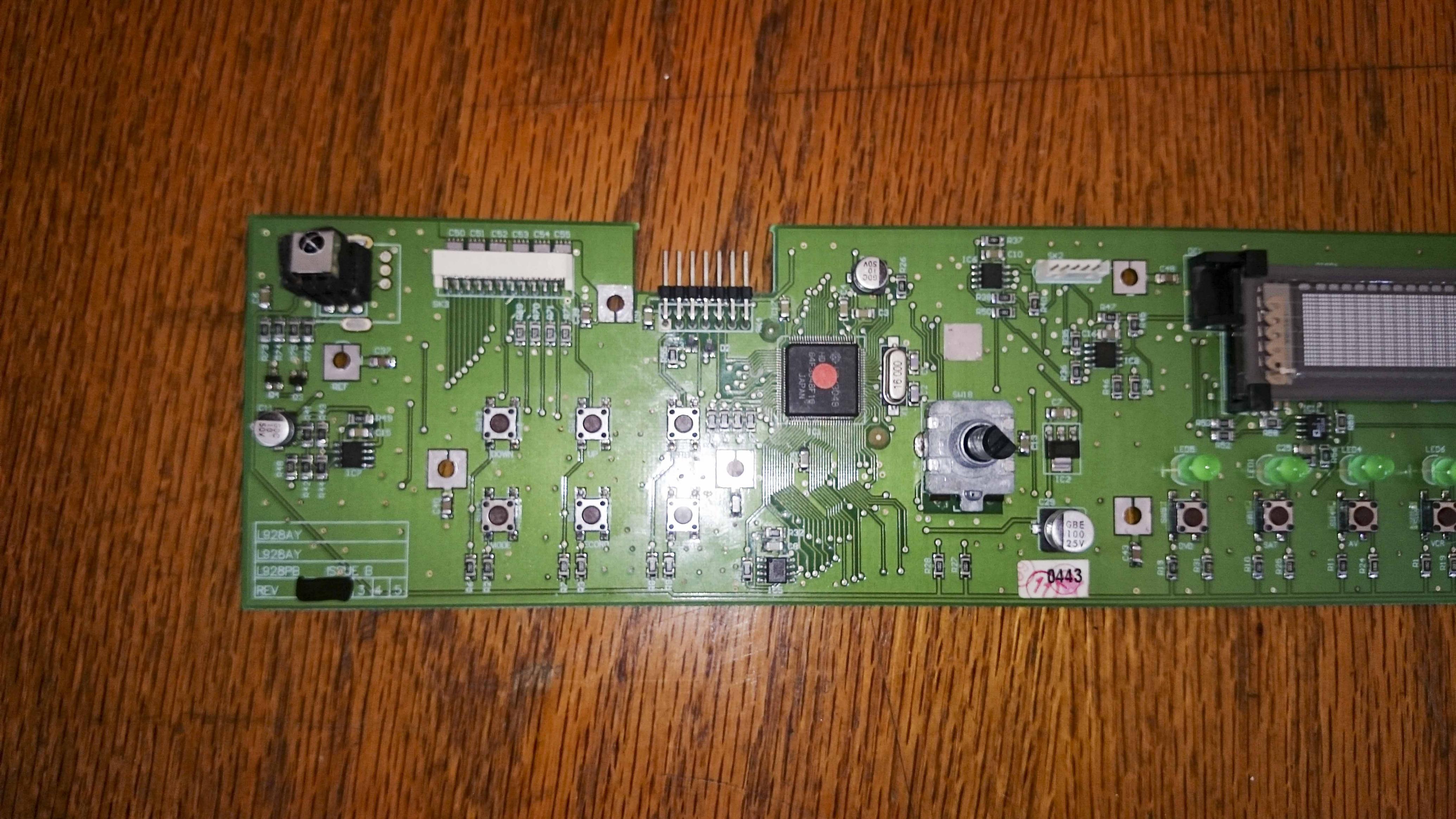

I still have a little problem amplifier
When the display to dim mode
There is a little noise from the speakers. High frequency
When the display is turned off or in full light
Quiet.
I tested the amplifier ground.
All the star ground
All chassis connections.
5V voltage display clean.
From what I know from other products SMD capacitors
Can introduce oscillations to the display circuit.
Again little problem that everyone arcam amplifiers have
If someone has a tip how to solve it, I'd love to hear
I shot this video of the noise
Link to the video on YouTube

Decoupling on the digital ground I expect.

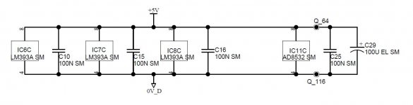

The noise is only a dim display on.
I was able to significantly bring down the noise level
By addressing circuit 5 volts.
But the noise still exists, though weaker
I guess it has to do SMD capacitors
In the display circuit

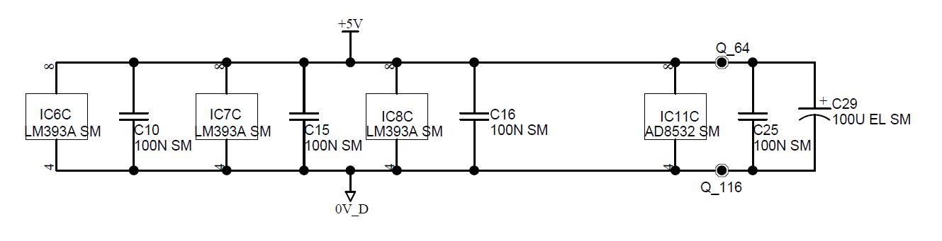

I was able to resolve the shrill noise
Almost completely
By replacing the op amp from LT072 to OPA1662
Z111
Z113
At the input of the pre-amplifier
Shrill intensity Reduced About 50 percent .
The most important problem of Small clicks sounded from the speakers when I up and down the volume completely disappeared 🙂
I later Also replace the op amps
Z112
Z114
to OPA1662
I only had two units at the moment
I will order another couple and see
If the problem is completely solved.
(Usually I really like the sound tone of the op amps JFET-based But they are much more noisy )
Input Bias Current of the OPA1662 bigger 600nA
Compared to the LT072.... 65na
But because of the resistor values in this part circuit
low
So I was not to worried About offset error.
