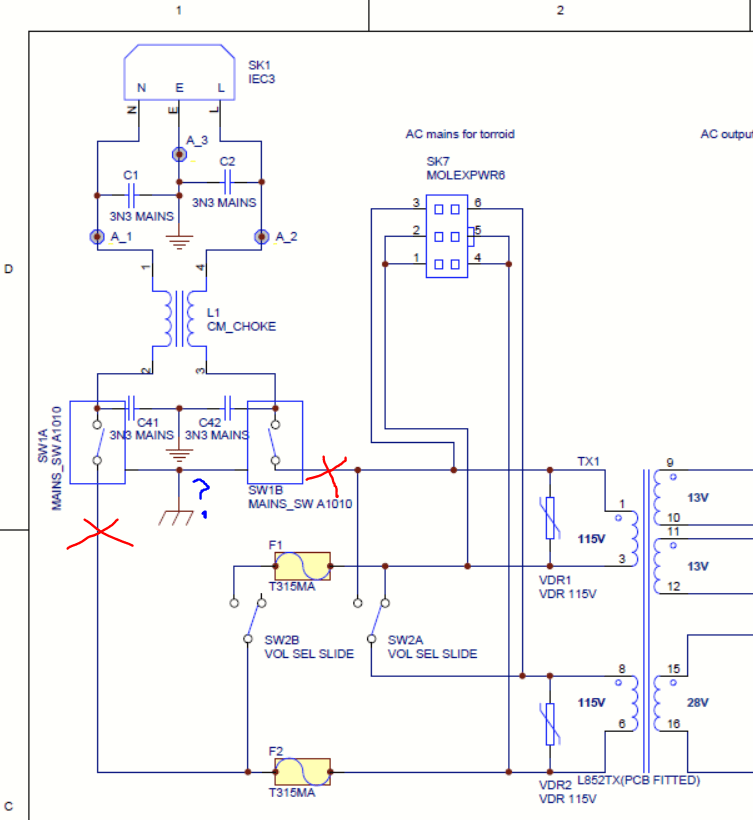

I then started to unplug all the power cables from the board one at a time untill the PSU was stand alone and I still had the hum. Image attached shows both boards completed isolated. I then disconnected the ground wire from the chassis, now all is quiet. The PSU is grounded to the PCB from the earth pin through the suppressor caps to the transformer, there is also a grounding path through the board so when screwed to the chassis the chassis is grounded.
So my question is what do you think this could be, my guess is its RF from the toroidal transformer. Do you think replacing the 4 suppressor caps and common mode choke would fix it?

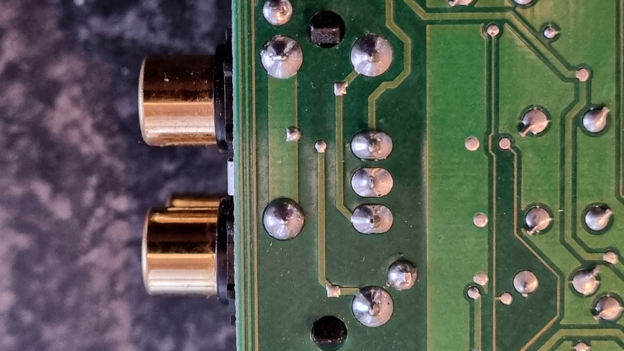

Thanks for your reply extreme, I have touched up the pins on the rca outputs with fresh solder. I've tested continuity between the Earth pin and shield striped down and there's no direct link. The rear panel screws directly to the shield so grounding through chassis once assembled. It's a 20 year old unit that up until now has been on point, that's why I think it's a failed component. However my experience is limited.

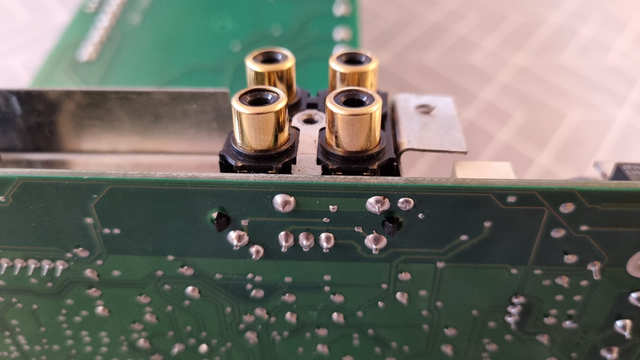

The buzz is heard as soon as the mains is plugged in to the power supply. With all internal cables disconnected so both boards are completely detached from each other a hum is still the same with the short earth strap connected to the chassis. Once the earth wire is disconnected the hum goes away. So this must be 'through the air' as nothing is connected. Looking at the drawing the choke and suppressor caps as well as the front panel power button are the only things to powered in this state. I have attached an image of the socket as well as the service manual. I have swapped out RCA cables and also tested on another amp.

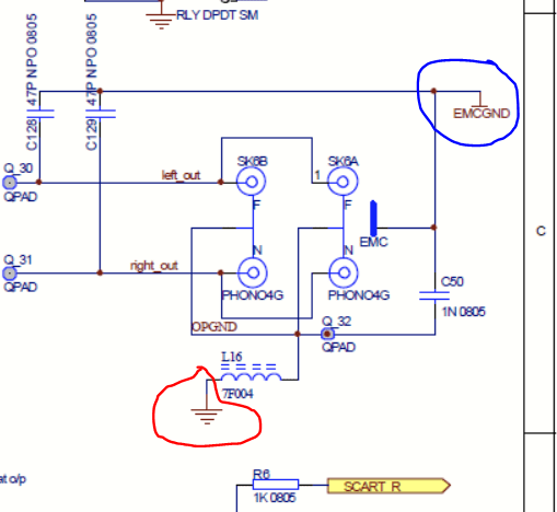

Check the RCA sockets' common potential vs. chasses potential... see if you read zero ohms. Check the result vs. what the schematics is saying, i.e. the RCA sockets common (outer metal ring) might be AC coupled to DVD chassis.

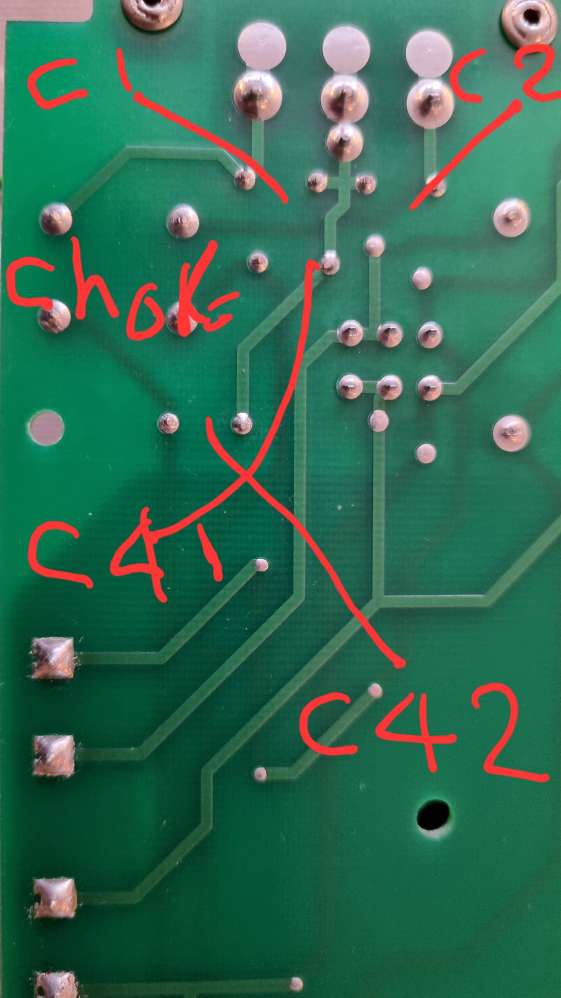

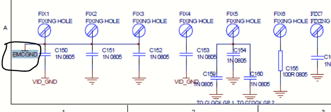

Remove the wires marked with a red X. Still buzzing/humming? If there's still buzz, your Y capacitors replacement did not work. Please provide the photos of both sides of the PCB where the capacitors are soldered to it.

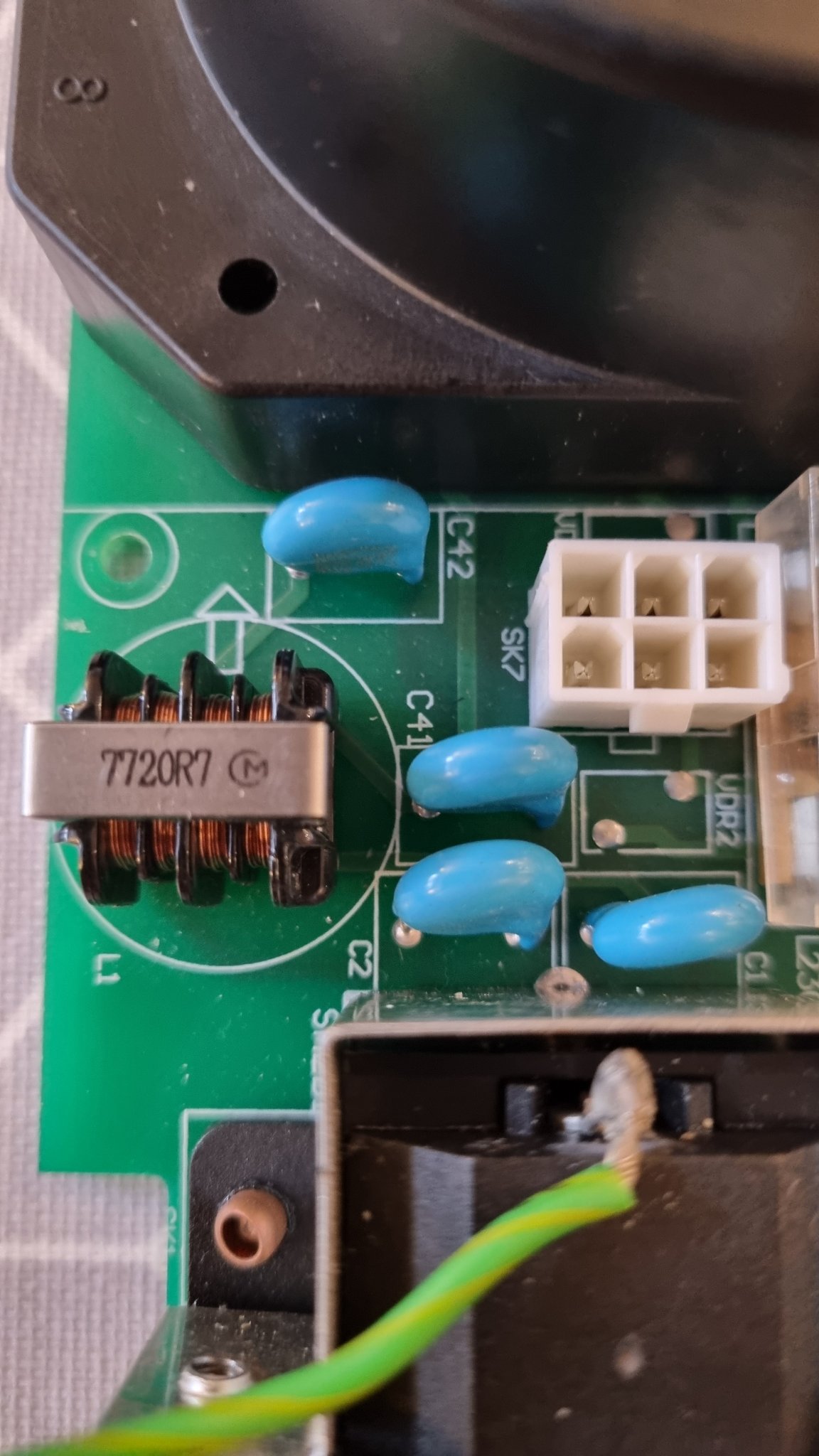

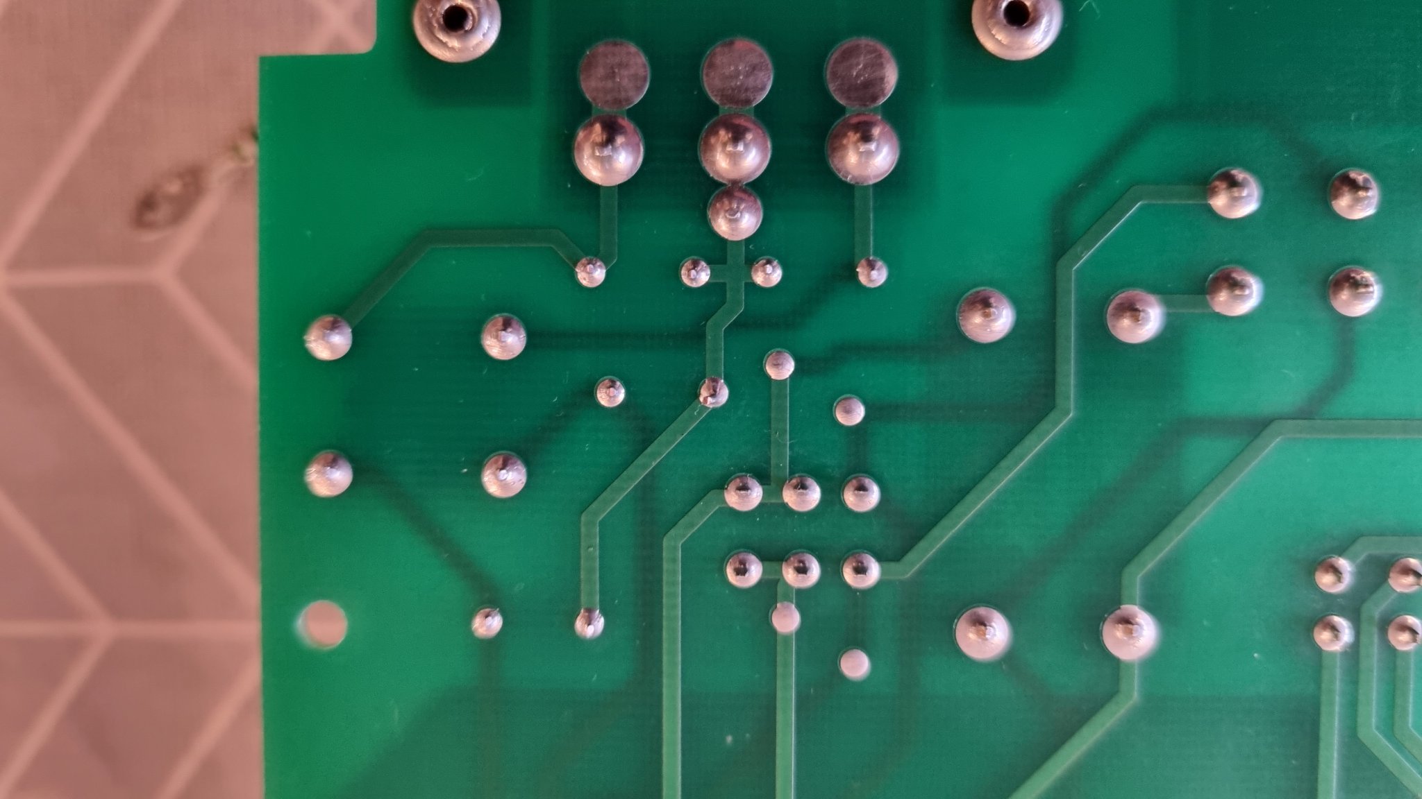

Did you also replace the C41 and C42 as well? I need to see the photos of all Y capacitors. Post the choke photo as well.
How is that mains switch (metal?) case connected to the ground (see blue question mark). Post some photos, please.

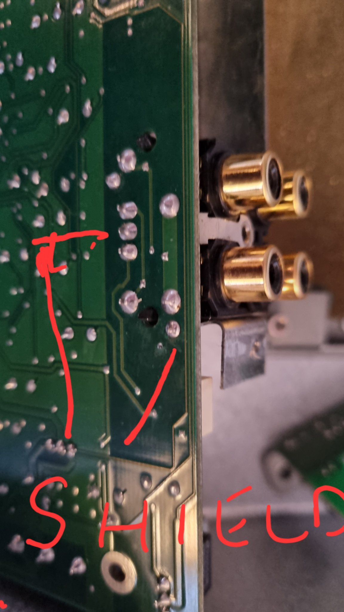

The output RCA block (metal cage) photo you posted is just an RCA PCB eyelets' soldering.... I need to see how that metal cage, surrounding the output RCA PCB, is connected to the chassis. Also, how is that PCB coupled to that cage??? DC coupling, (mounting screw eyelet copper pad in direct contact with the metal cage)?, or AC coupling (there's an SMD capacitor between PCB ground and metal cage)?
The mains cable stayed plugged in for a long time, and the X and Y capacitors started to leak (actually, there are no X's, just Y's).... this is the most likely root cause of your problem.
NOTE: If you lift (desolder) only one side of each (all 4 of them) Y capacitors, and the buzz goes away....

Yes the power has been connected 24/7 for 20 years! I did not replace the ceramic caps on the power supply. Initially not realising that the hum was there even when switched off I replaced the caps on the AV board C1 and C3 pre the outputs. The switch is metal cased and is grounded through a pad on the board marked REF. The red Xs are not wires they are tracks on the board. The sheild is soldered to the board but goes no where and is earthed through the back panel. I've attached some photos that you ask for, let me know if you would like others or clearer ones.

Sorry didn't answer your question regarding the scart. Nothing is attached to the scart and never has been, video is connected via the component out's. Also forgive my limited knowledge not sure what you mean around the AC/DC coupling of the cage. Which SMD goes between ground?
There are a few approaches....
- you could cut the PCB tracks (Exacto-knife) that I marked with a red X and try that.... if there's no buzz - replace the Y caps and possibly the choke. This approach will undeniably isolate the problem to the IEC mains connector, 4 x Y caps and possibly the choke. Once done with replacements, just scrape the lacquer and solder the tracks to ensure conductivity is re-established. While at it, make sure that the conductivity check between the switch lugs (4 pins) and its metal case, shows infinity (best is to remove the switch from the PCB for this test). Use the Solder-pult.
- you could just go ahead and replace the 4 x 3.3uF Y-rated capacitors. Make sure they are at least rated for 250V AC. You could also replace the L1 choke.
If you are not comfortable working with these parts (that handle mains voltage), take the player to a technician to do it for you.
... heck, you could just remove all 4 capacitors (Y-rated) and the choke (bridge out the choke pins 1 and 2, and 3 and 4) - just for the test purposes. Make sure you are bridging the right pins !!!! otherwise, the mains fuse in your distribution board will blow out / trip. If the buzz disappears, get the replacement parts for caps and choke.
Once again, if you are uncertain of what I'm saying here.... take the player to someone who can do these things for you.

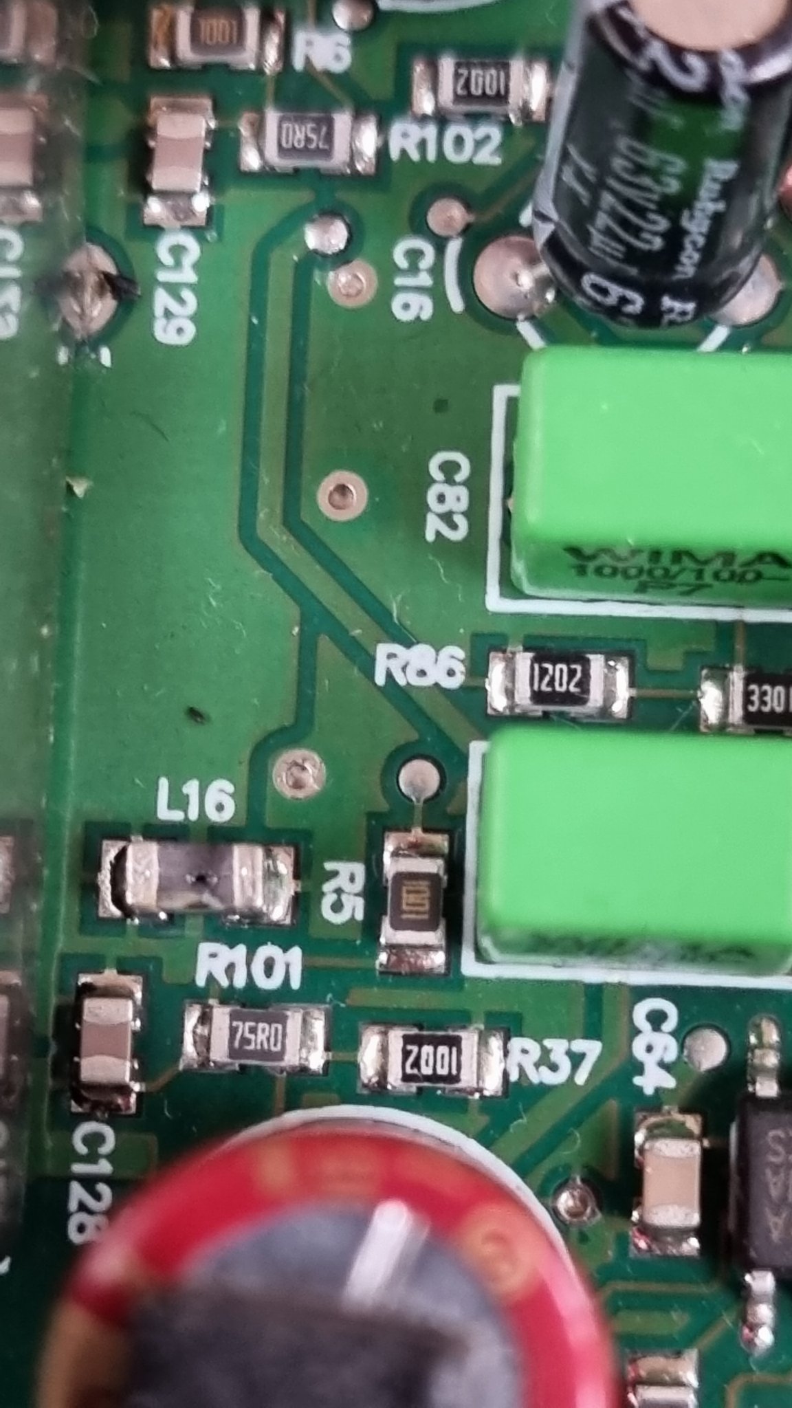

Think I've hit a brick wall now, very frustrated! Today I've removed the choke and C1 and C2 from the board so the socket is sitting on its own and it's still humming when the earth cable is connected to the chassis.
Any other ideas, now thinking it can't be the PSU?

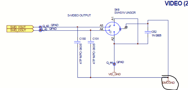

Took a week to get the ferrite beads as I didn't have the experience/know how to check for compatable SMD. So I got hold of some originals from Germany. Removed the bead, cleaned the pads, stuck the new one in and BINGO all is so so quiet unbelievably so!
Thanks extreme for sticking with me on this, think I made it more complicated than it should of been but we got there in the end, hopefully the post might help someone else.
