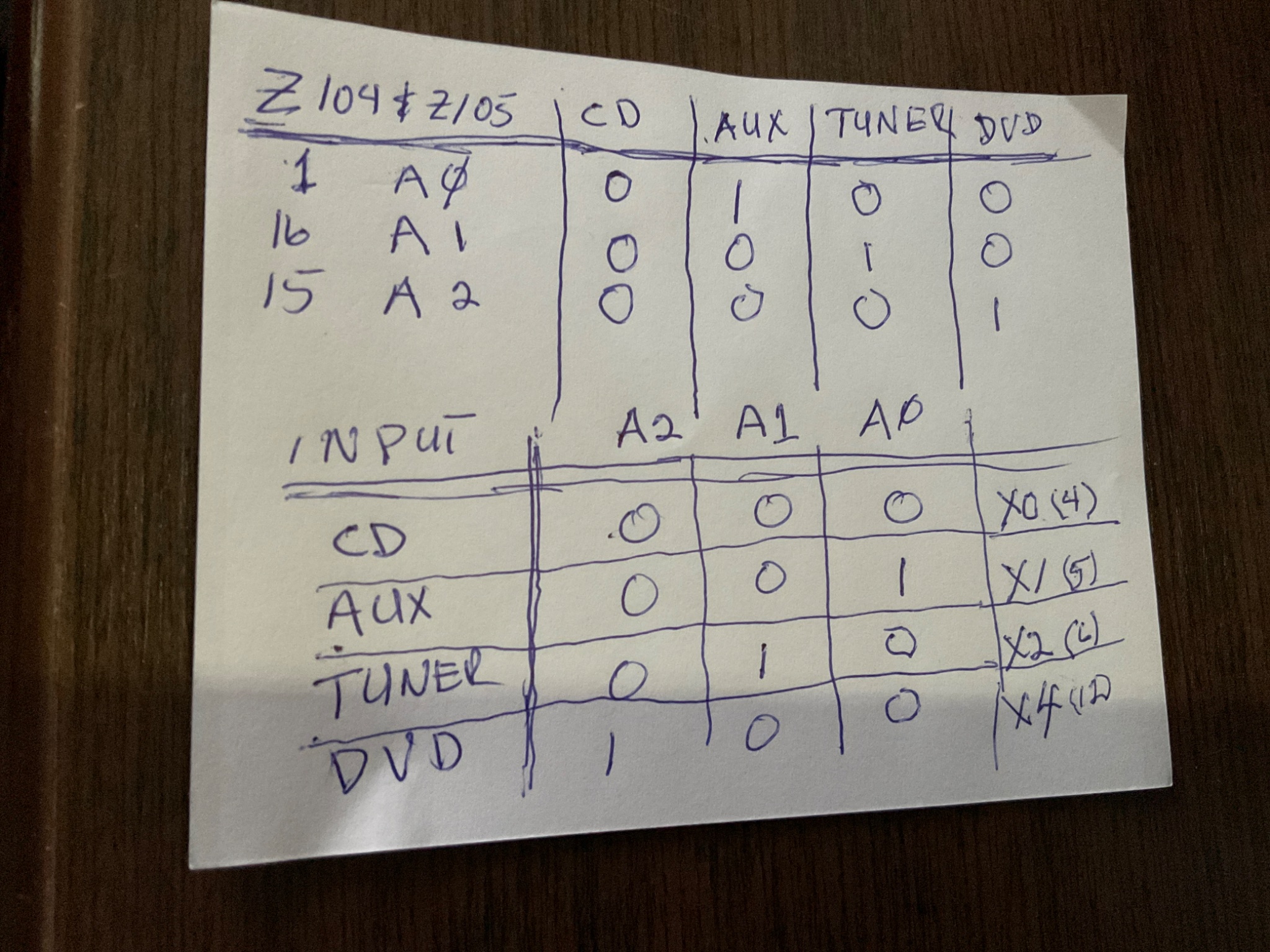

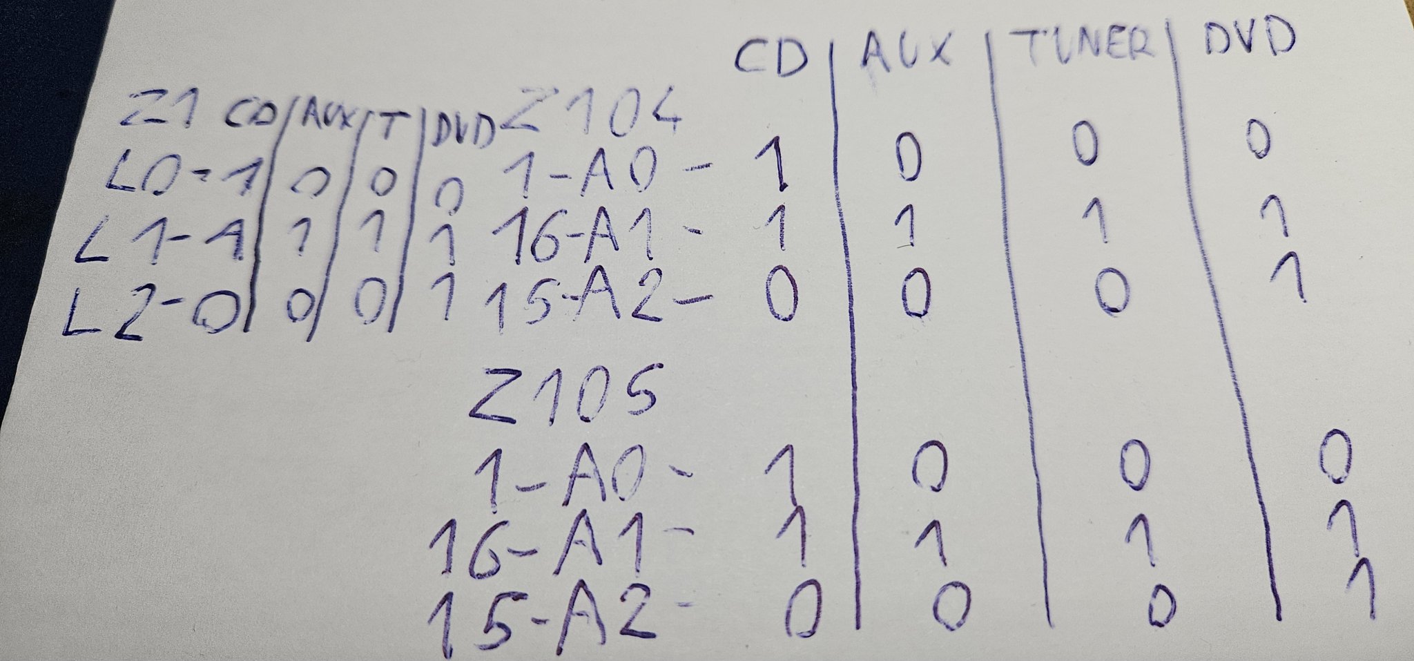

The problem is that the MUX isn’t being addressed correctly, but we don’t yet know why. For convenience, I’m repeating your earlier table.I'm wondering about the logical states for the TUNER and AUX inputs. They are the same, but only TUNER works.
I surmise the MUX address lines are A2,A1,A0 = 010. The state of these lines seems to be unchanged in both Tuner and Aux source selections; 010 corresponds to selection of the Tuner.
Below your table copied from post #17, I’ve posted a table arranged in a similar format showing the address lines as they should appear for the various sources. The second table has the same entries, cut with rows and columns transposed, easier to read I think. The mystery is why the data isn’t correctly presented on the MUX address pins. Please advise if this isn’t clear.
I haven’t been able to trace how the MUX address pins are sourced from the microprocessor. I see the MUX lines at the “SK100” connector on PDF page 16, same page as the Z104/Z105 ICs. But where do the signals go from there? I’m probably being blind. Thanks for guiding me.
