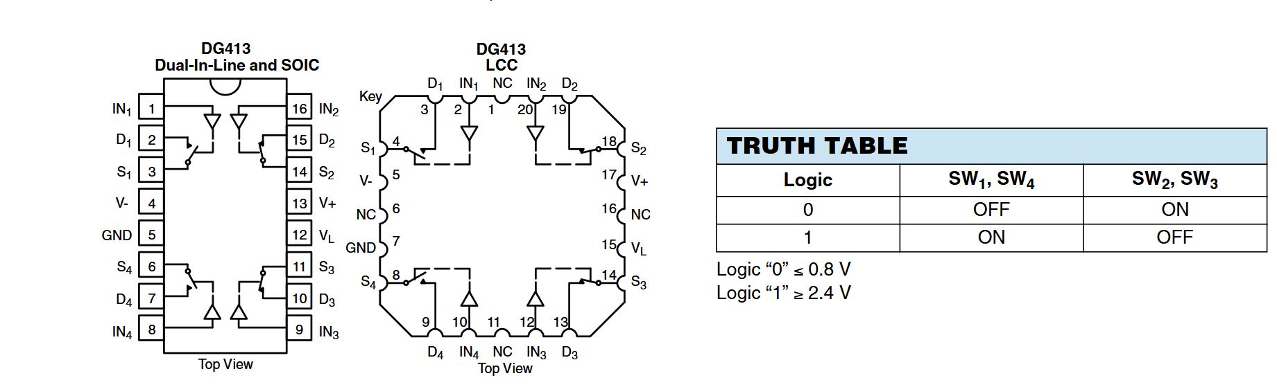

I have a problem with the preamplifier inputs. This unit has 5 inputs. AUX, CD, TUNER, AV, DVD, but only two of them send a signal to the main amplifier - TUNER and AV.
I replaced the 2 main multiplexers Z104 and Z105 but it didn't help. There are resistors of 22kOhm each at the Z104 and Z105 inputs. An interesting fact is that when I set the TUNER input, the audio signal does not enter the 22kOhm input resistors, but the amplifier plays correctly, the signal comes out of the preamplifier, but when I set the CD input, the signal passes through the 22kOhm resistor and goes to the Z104 and Z105 input, but the signal does not come out of the preamplifier.
This seems illogical to me. 😒
Regardless of which input I set, the output signal does not appear on pin 8 of the Z104 and Z105 multiplexers, which is the signal output.

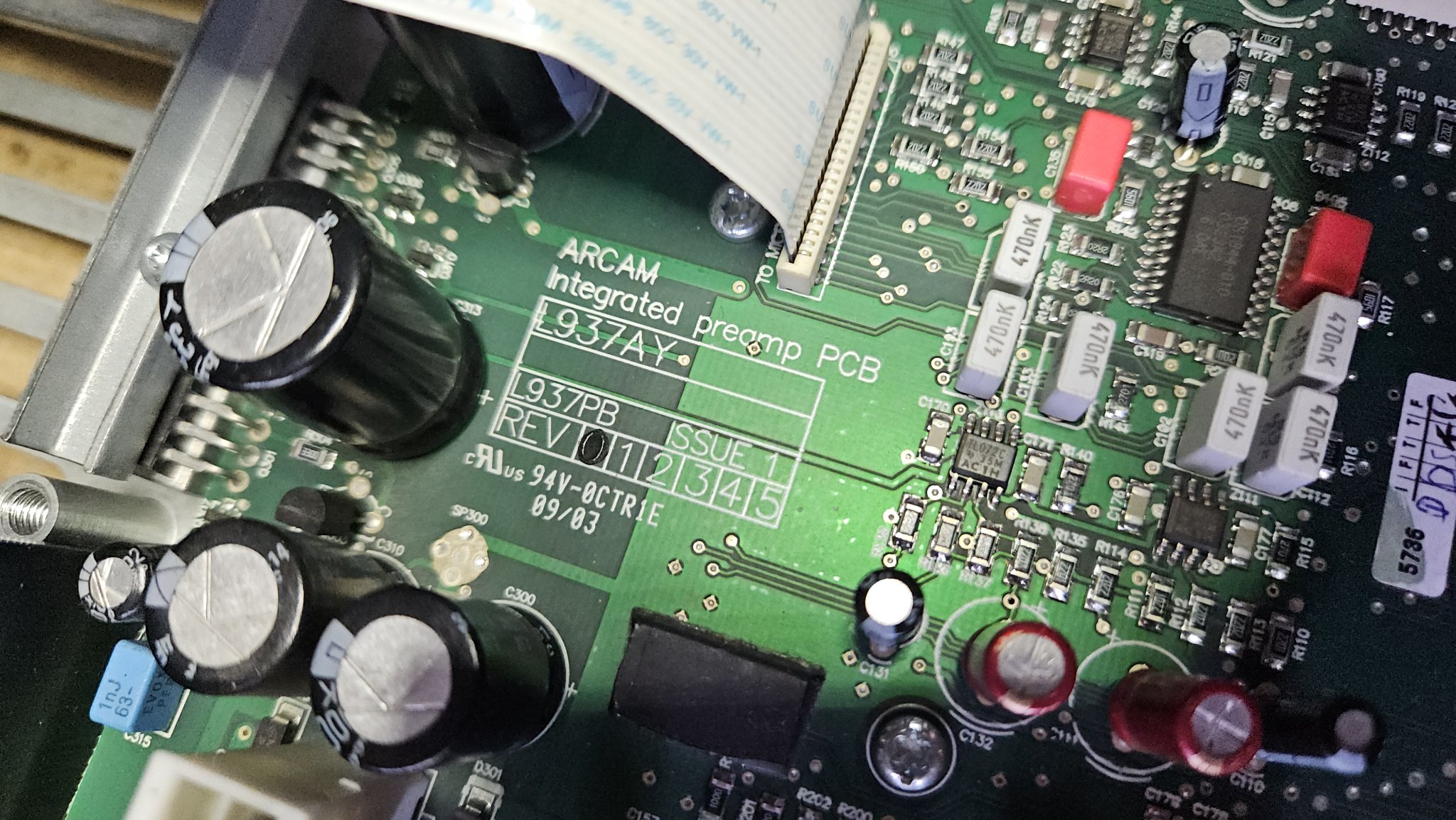

Hi, your problem is a well known one. At least to the A85, and I suspect it has spilled over to yours as well. I used to service Arcam in Norway for a number of years, and the only remedy is to install a new board. Can you please show the board id? It should be L something.
R
No offense, but if this is a common problem, why couldn't I find anything about it on the internet, and I did some digging there.
In my opinion, it is a problem with one of the integrated circuits, but I lack the knowledge to diagnose it correctly.
TUNER and AV inputs correspond to MUX pins X2 and X3, i.e address 2 and 3. This suggests that the mux Z103 and Z104 are responding to the A0 pin, but that A1 pin is "stuck" at logic 1, and A2 is stuck at logic 0. Examine pins 1, 15, 16 of Z103 and Z104 for confirmation. Follow these lines back to their source at the microcontroller. Perhaps there are defects in the paths of the A1, A2 between muxes and controller.

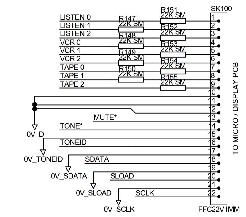

I'm wondering about the resistance between pins 2 and 3 on the SK100 connector. When 230V power is connected, the resistance between these pins is 0 ohm. When the power supply is disconnected, the resistance is over 5MOhm.
Between pin 1 and 2 there is O.L. Between pins 1 and 3 67Ohm.
The resistance drop must be generated by IC Z1, because it is low even when the tape is disconnected from the preamp side.

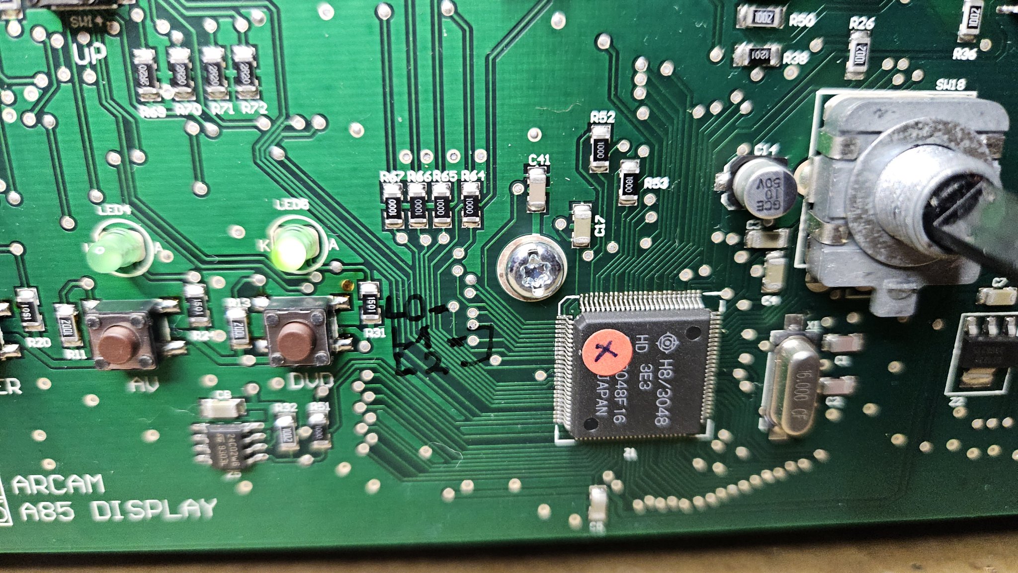

Either way, the microcontroller controls the Z104 and Z105 muxers. There are no problems with paths or resistors between them, and this probably leads to the conclusion that the Z1 microcontroller has some problem or EPROM Z5. At least that's what I think, and there's nothing I can do about it.
I remind you that I replaced the muxers and it didn't help.
Yes, uP is supposed to resemble Greek Mu/micro.
The last hope is that the path from MUXs to the controller is some how open. If the processor package will allow, probe directly on the processor pins to test if they respond correctly to the various sources suggested above. If they don’t respond, that seems dire. But I’d be surprised if this the only misbehavior, so don’t abandon hope until evidence is unequivocal.

The logical states are the same at the direct output from the main microcontroller Z1 as at the inputs of the Z104 and Z105 multiplexers. In my opinion, this means a problem with the Z1 system or EPROM.
There's nothing I can do about it, because I don't know, because I'm not sure if I would program the EPROM to correct the Z1 system after replacing it, since it may have a damaged program itself. I'm giving up on this repair.

The idea was to check whether there are any differences between reading the logic states on the muxers and the Z1 system, and there are no expected differences. I also thought about unplugging the tape that connects the SK100 and SK3 connectors, but I gave up on it because I don't know if the equipment will start going crazy after unplugging it.
The LEDs on the front of the panel light up according to the selected input.
