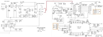

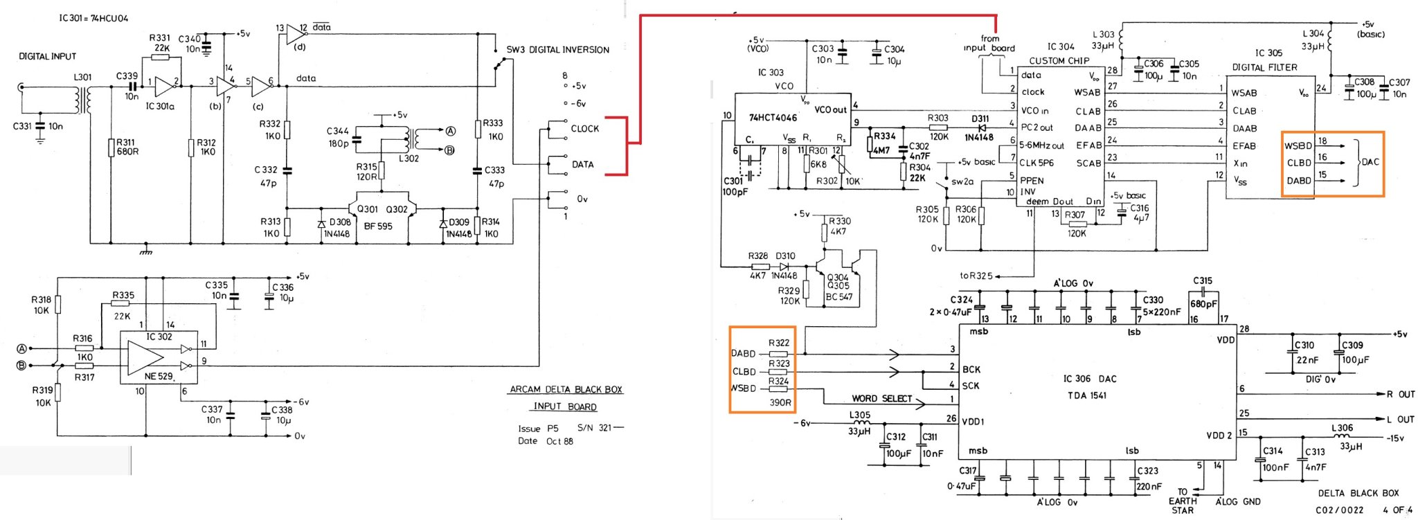

I have an Arcam Delta Blackbox 1 Dac, the Dac have only 1 coaxial digital input.

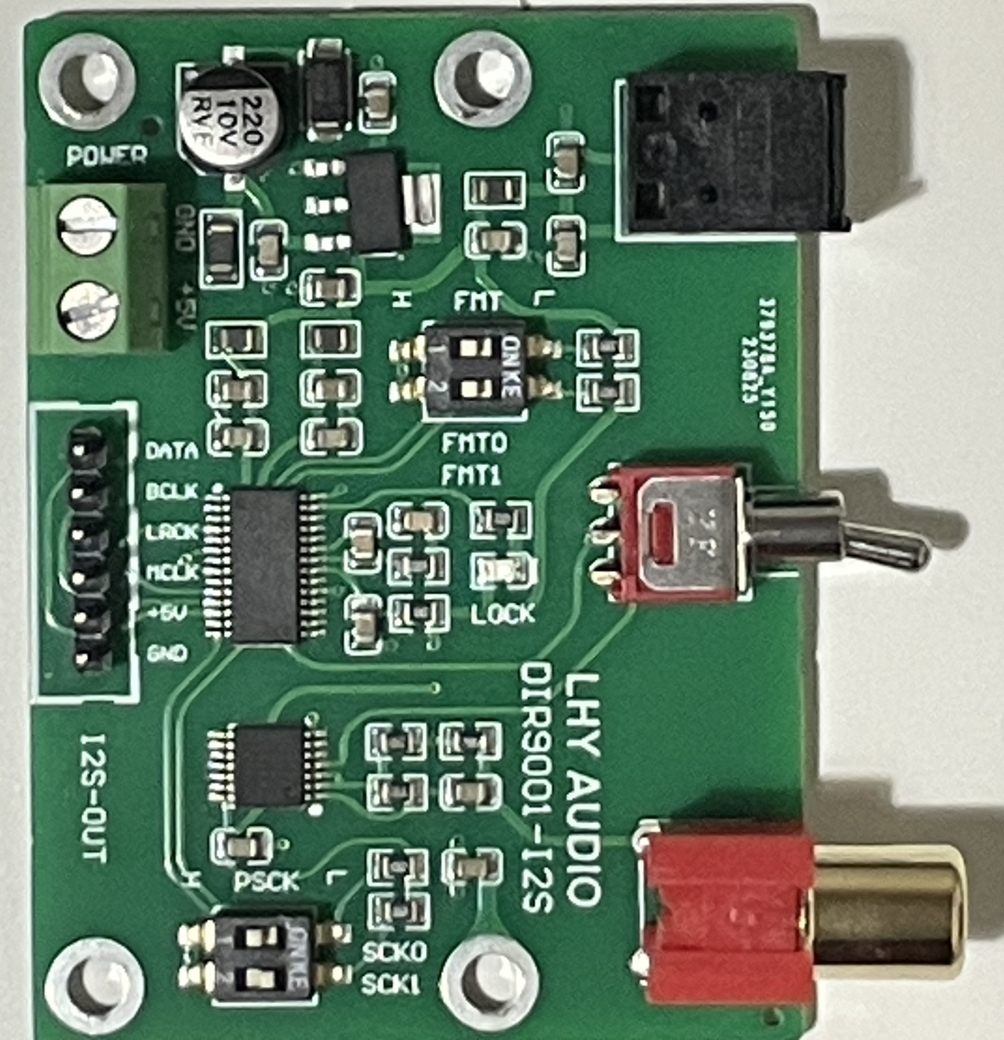

I would like to modify the Dac digital input section with a DIR9001 based input board which have both coaxial and optical inputs and I2S output.
My question is, can I connect the DIR9001 Data and LRCK or BCLK outputs directly to ARCAM's IC304 custom chip inputs (DATA and CLOCK) ?
or I need to omit IC304 and connect it directly to the digital filter inputs (or going NOS and connect the I2S directly to the TDA1541?

The only changes I've made (for now) is replacing the TDA1541A with TDA1541 S1 and runing it in NOS (saa7220 removed and bypassed).
I also changed the 490r resistor in the LM337 to drop the - 6.2v to the TDA1541A negative voltage input to - 5v (360r).
Btw how you disabled the muting function for connecting your digital input board?
There is a transistor muting the data line, just cut that track between R322 and Q305.

EDIT2: the SAA comes after the custom IC, so you need to inject your digital lines that come from the DIR9001 after the custom ic. I would recommend to take out the custom IC (and the other DIP ic near it) and try to get it work with the SAA7220 in place.
