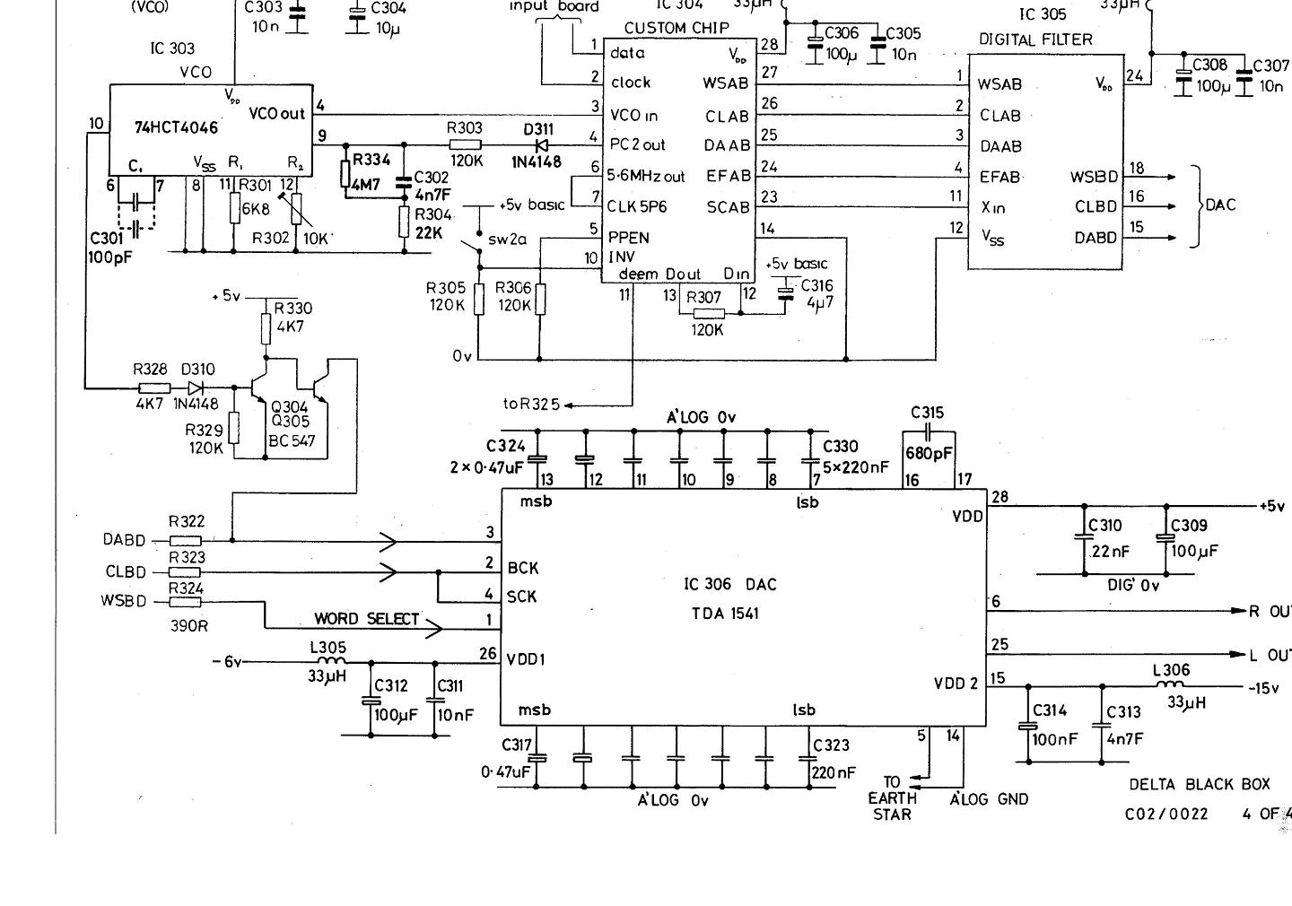

Need help! Its late and my fried brain can't figure this out!
I have a black box 1 that I'm modding at the moment. I've removed the oversampling which I think is an improvement. Previously, I've successfully put tube output stages on the back of other tda1541a machines with good results so this is what I'm planning here.
The current problem I think is with this relay RL1 (sometimes referred to as RLA1 in manual), shown in pics below.
If I understand it right, it detects stability before switching on power to the audio power supplies? I got most of this from the user manual!
Problem is, I'm taking stealing signal from the DAC and disabling the audio circuit like this:
So I don't think the relay will be activated, and the audio PS will not work. So what, if I'm using my own output circuit? Well, the DAC needs -15V supply to operate, which is pinched from the audio PS.

Ha! I'm a twit! I hadn't properly sorted out the earthing of my tube output stage (which is currently in a seperate box) which meant the tubes weren't picking up signal from the DAC.
D'oh!

I recently tested my modded BB1 with a Benchmark DAC1. The BB1 won. The benchmark may seem to reveal more details but almost all of those details are on the BB1 too, just not so in front of you.
My current mods:
1) remove the small input board
2) disable the digital muting circuit which is connecting the data input to ground if I remember right, just before the TDA1541A
3) remove the Arcam custom chip and the PC74HCT, great improvement by getting rid of these chips because they generate a lot of RF noise as one member noted on the first posts of this thread
4) change all the capacitors with some good ones, I replaced them all with BG when they were still available, on my second BB I want to use Panasonic ECAM, I don't like the FC/FM for audio.
5) add a board which outputs I2S and connect it directly to the TDA1541A but make sure that you connect the DATA, CLOCK and WS before the three small resistors which are between the SAA and the TDA. You will also have to cut the traces on the PCB to the SAA and I also recommend to cut the power supply to the SAA
I'm using a board from teradak (Valab store on ebay). You can search USB to I2S or SPDIF to I2S on ebay.
I guarantee that almost any DIY digital receiver board that you can find with a modern chip will be much much better than the original receiver in the BB1.
6) replace the regulators with discrete versions from Burson Audio

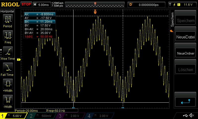

Would it be possible to dump the DC servo section , and add a dc blocking cap at R23?
Sorry, I am a bit late to the party, but I tried it by lifting R27 and R23. I connected the scope probe to the output before R23, playing a 0dB 1kHz signal, see attached screen shot: there is no DC offset but rather a big underlying 50Hz sine wave with 35Vpp (I tested both channels). So it seems the DC servo is there to iron that 50Hz out. As my unit is freshly recapped (and fitted with this mod) I wonder where the 50Hz comes from...?
I visited my local audio repair guy and he recommended to put foam tape underneath the power supply. He said that the noise is the power supply humming off the chasis. The foam tape reduced the hum by a lot.This is my first project so please forgive my ignorance.
