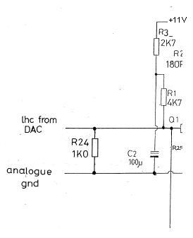

Hi Guido,
So in the black box: -6.2 -15 = 8.8 divide by 2500 = 3.52ma
So lower output current (good) but the voltage -6.2V is quite high for that pin input(bad). Is this correct ?

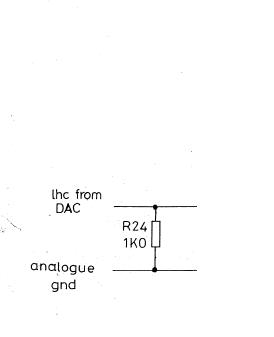

There is a 1K resistor to ground on the dac output listed in the service manual which is confusing me because it seems way too high for tda1541a. Maybe reading the schematic wrong or an error!
