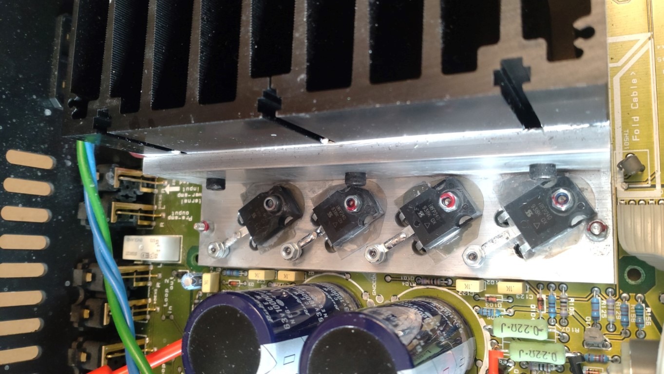

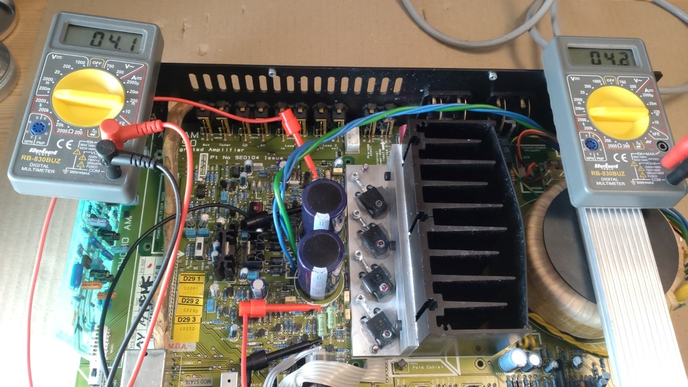

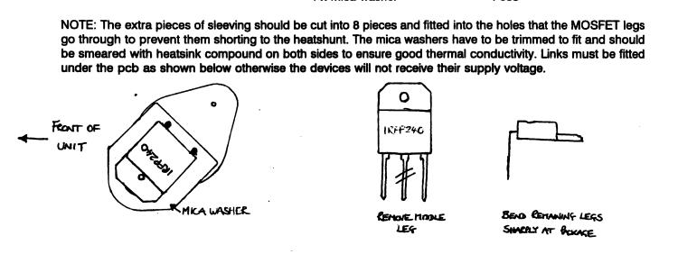

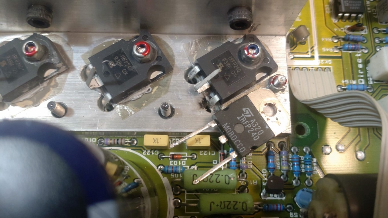

I would say that your multimeter is in working order - it is kind of difficult to drive current though the plastic housing:so I decided to buy new mosfets IRFP240 (and an "audiophile" fuse 🙂). Now the amp powers up nicely, but the sound is completely distorted, maybe because there is zero idle current, unless my multimeter is lying to me.
Regarding power mosfets (I have not hendled them before):
a) how do you test their working condition and state (out of circuit)?
b) when buying replacement ones - are there any "grades" that should be considered?
c) is this amplifier safe to test with DBT?
Next thing to do is to unsolder them and check out what is physically undeneath the heatsink,

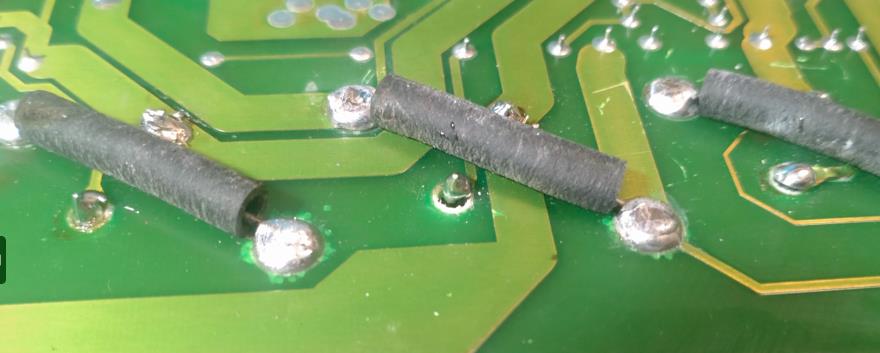

Also tracks need to be repaired:

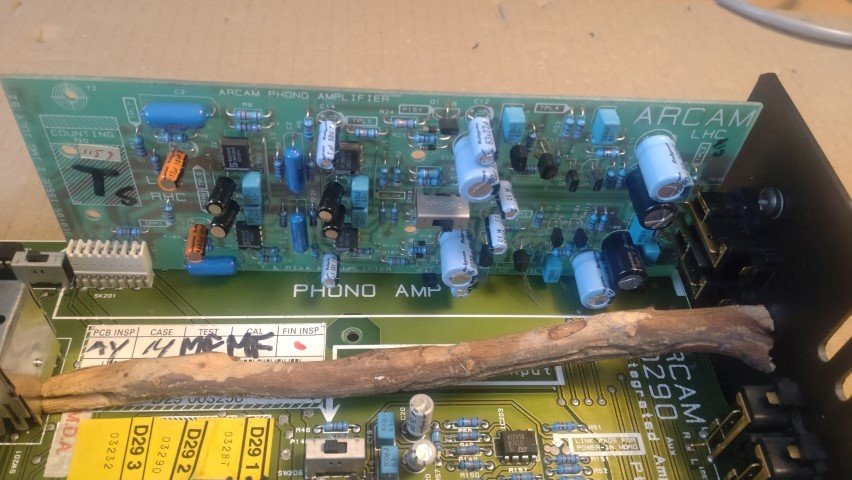

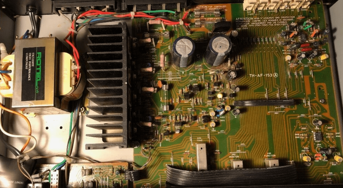

That is small. Kind of reminds me of the old Rotel's like the RA820. I almost don't like to ask what that thing is in it... bit of tree, dog chew 😀 😀
According to Martin MS it is a hum reduction device 🙂I almost don't like to ask what that thing is in it... bit of tree,

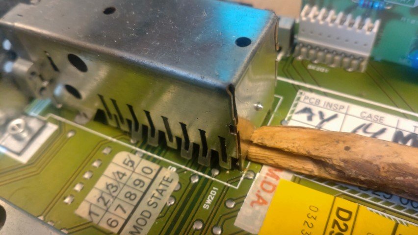

Seems like there is some contact problem with the shielding of the source selector switch so the shield needs to be pressed down. Needs to be sorted out.
See if they read short D to S. The high gate impedance means you might be able to get them to turn on and off just by poking a finger on the gate to zap it with a bit of charge. If they are not short chances are good they are fine.how do you test their working condition and state (out of circuit)?
I wouldn't think so.when buying replacement ones - are there any "grades" that should be considered?
Absolutely 🙂is this amplifier safe to test with DBT?
The biasing is similar to a vbe multiplier. Turn the preset to give minimum bias on both channels first. Wiper toward R16 to turn Q14 on.
Looks a bit like a twiglet 😀According to Martin MS it is a hum reduction device

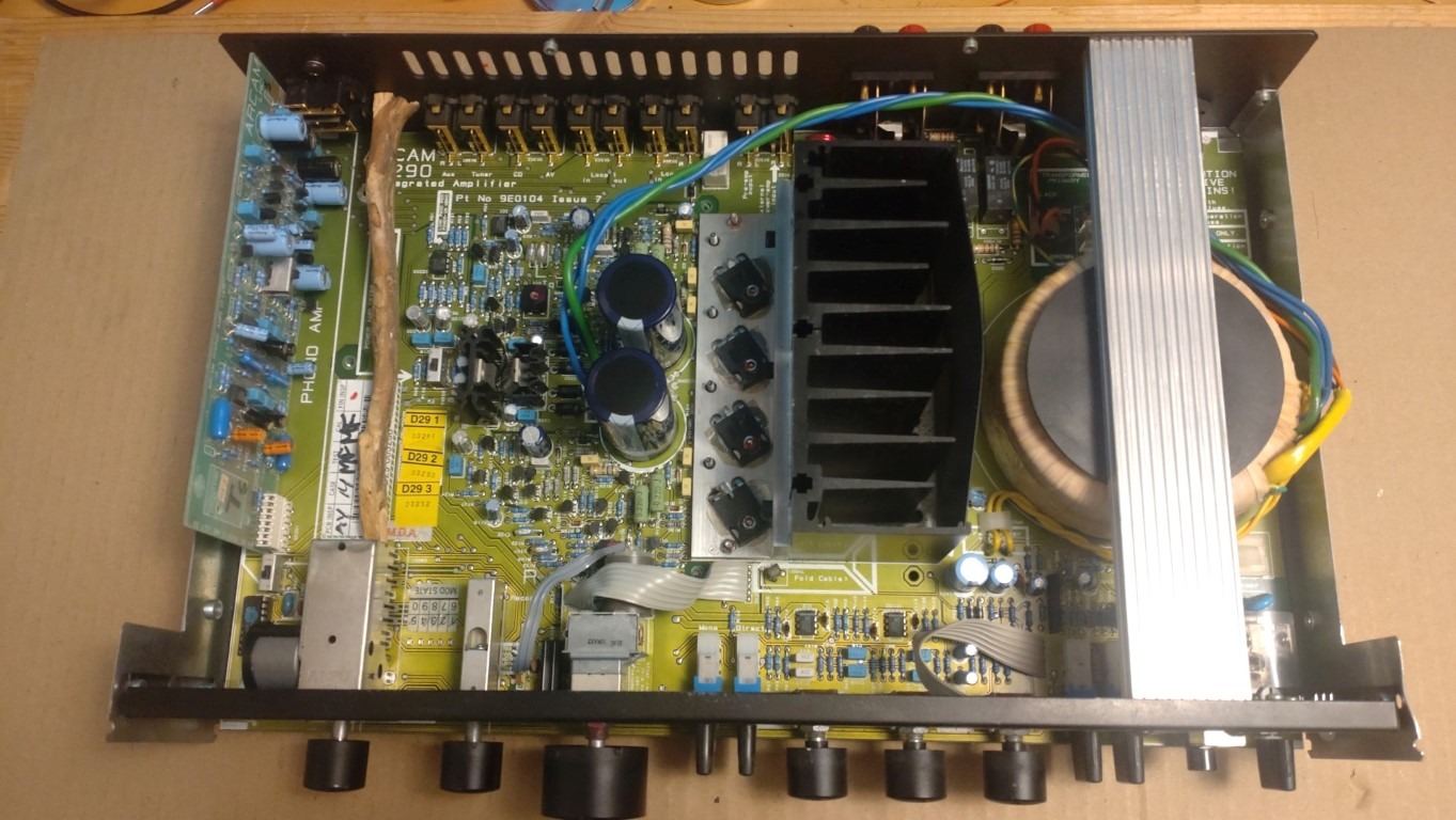

And you have the phono card 😎Ok, the amplifier looks like this - rather neat, only the small size of the heatsink makes me wonder about the actual output wattage it can handle:
So let the quest begin 😉
Capacitors in signal path need replacement and MC/MM switch probably needs cleaning.And you have the phono card

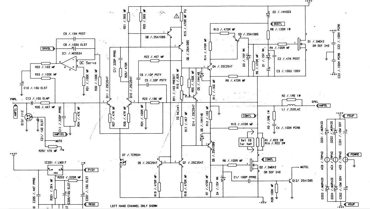

Question:
The "emitter resistors" seem to be present only in the lower leg - upper leg output transistor is directly between voltage rail and speaker output.
Is this common for this type of amplifiers?
There is nothing common about that design 😀
It is a quasi complementary design (two N channels FET) and will rely on tight thermal feedback of the vgs generator (like a vbe multiplier) to prevent thermal runaway and stable bias current. How well it pulls that off I don't know. You would normally expect source resistors for bias stability but if the thermal management is good enough without then they are not essential.
After adding some nuts, washers and lugs:
it powers up, relay clicks, led is green and bias is adjustable and rather stable:
Next thing to do - measurments.

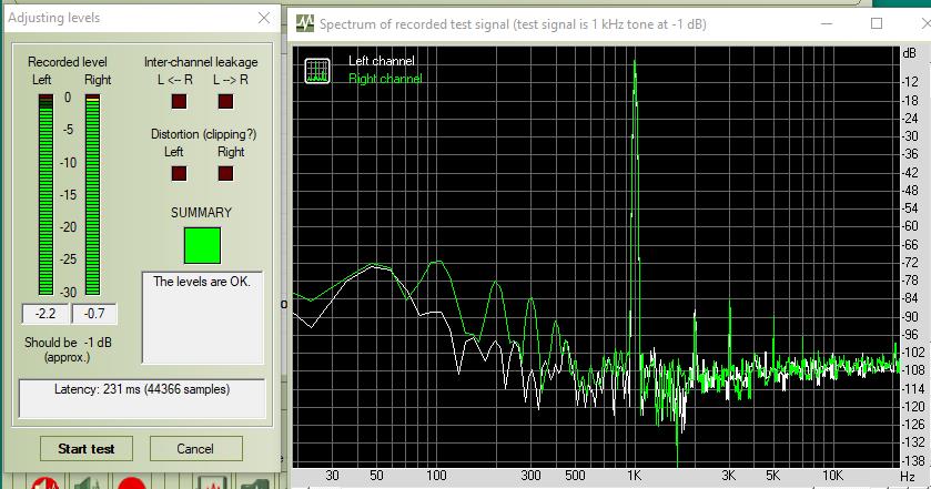

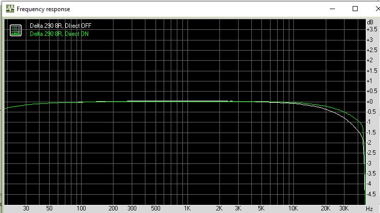

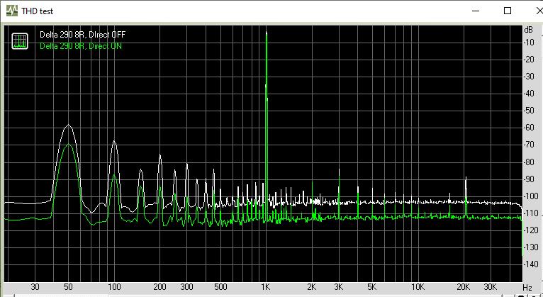

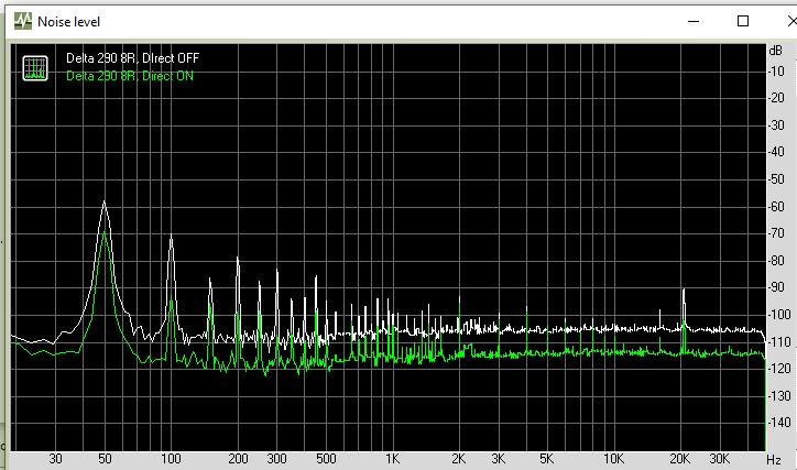

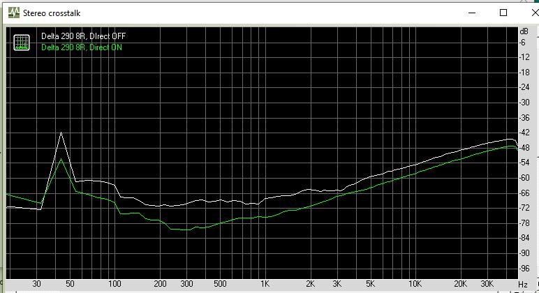

OK, first measurement results (with RMAA) - covers open, output signal from speaker terminals with 8R load in parallel:

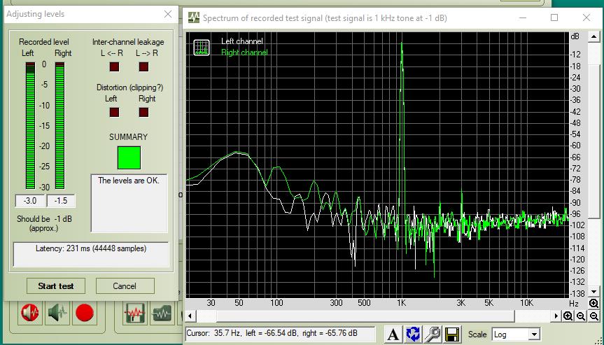

Spectrums with Direct ON
and OFF:

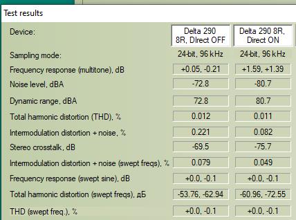

Measuring results:
Not too bad as a starting point baseline. The difference in levels seems to com from volume pot - when turned up to ca 13:00 the difference becomes substantially smaller.

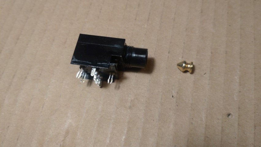

One more glitch surfaced - heaphones socket is giving out only left channel.

OK, missing headphone channel problem solved - it is bad practice to leave one's gear behind...
I swear the headphone thing wasn't me ....

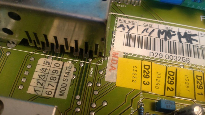

So the following comments are all in context "what would I d with this piece if I were to keep it for myself".

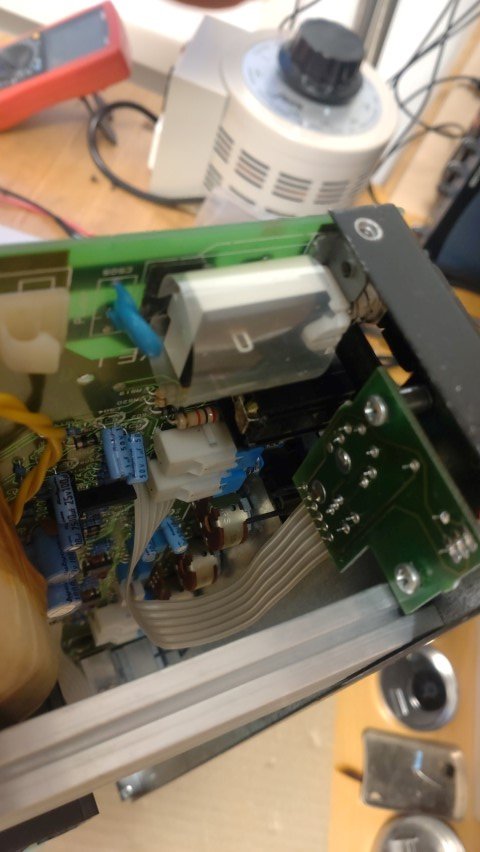

So starting up - hum reduction device (a wooden one:
A closer look reveals the problem it is fixing - the back part of the selector shield is somewhat bent so the supporting leg is hanging (perhaps even making contact) with one off the traces.
Wooden stick pushes that leg towards the front panel (to its designed location):
Proper solution would be to unsolder the shield and bend its back part to the correct angle.
Quick and dirty solution would be to bend the support leg towards the front panel.

Maybe you 'have to be there' to see it for real but from the picture I see an old pair of cutters being used to bend that bit of leg up an dout of the way. 1mm or so would be enough, slip a bit of mica or plastic under it to stop it ever thinking of doing the same again.Proper solution would be to unsolder the shield and bend its back part to the correct angle.
