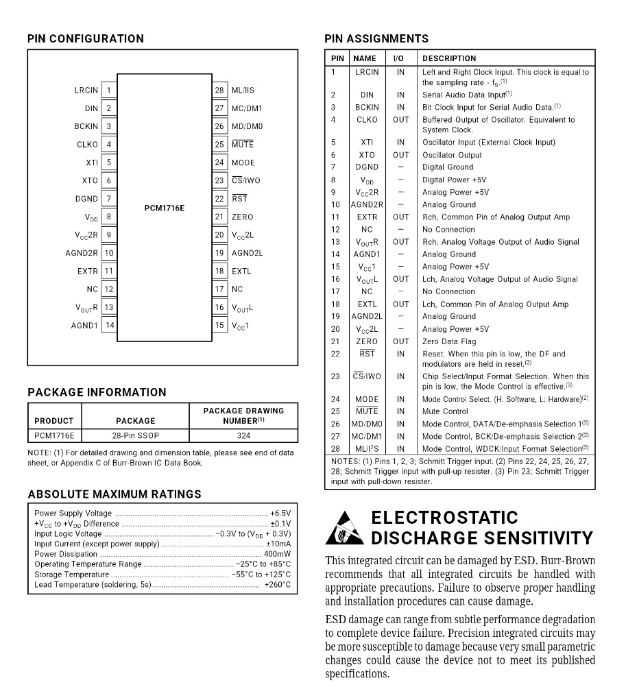

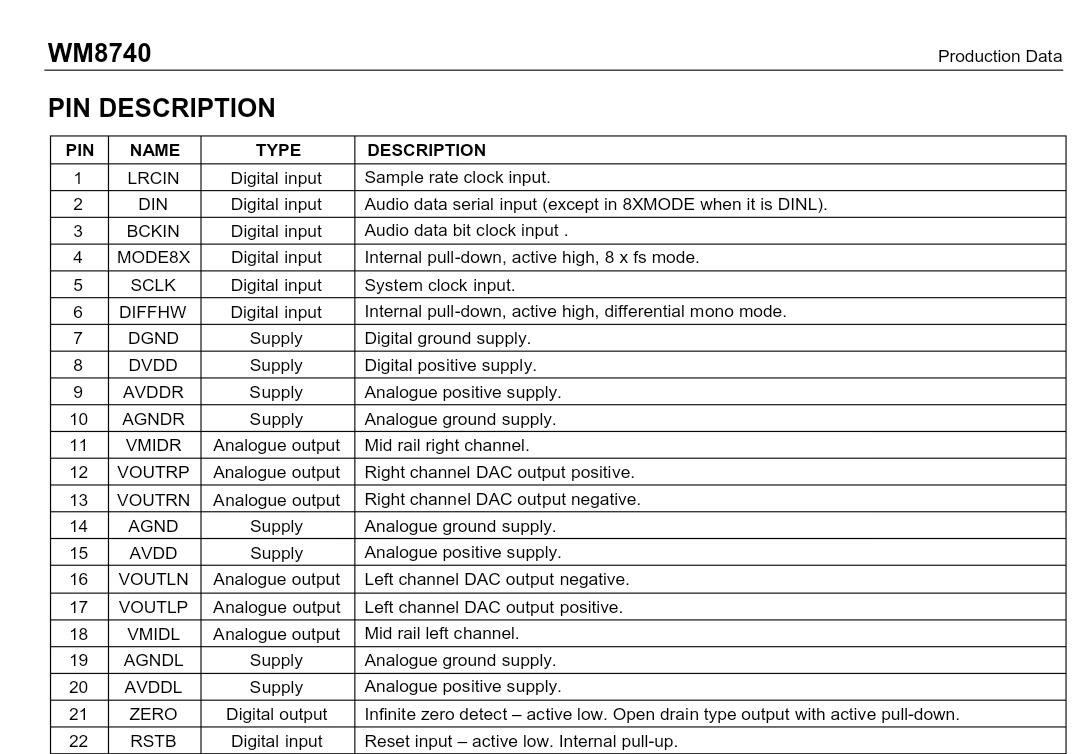

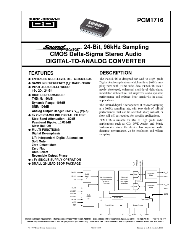

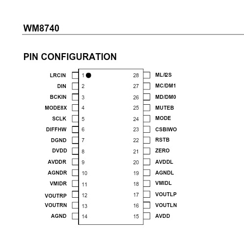

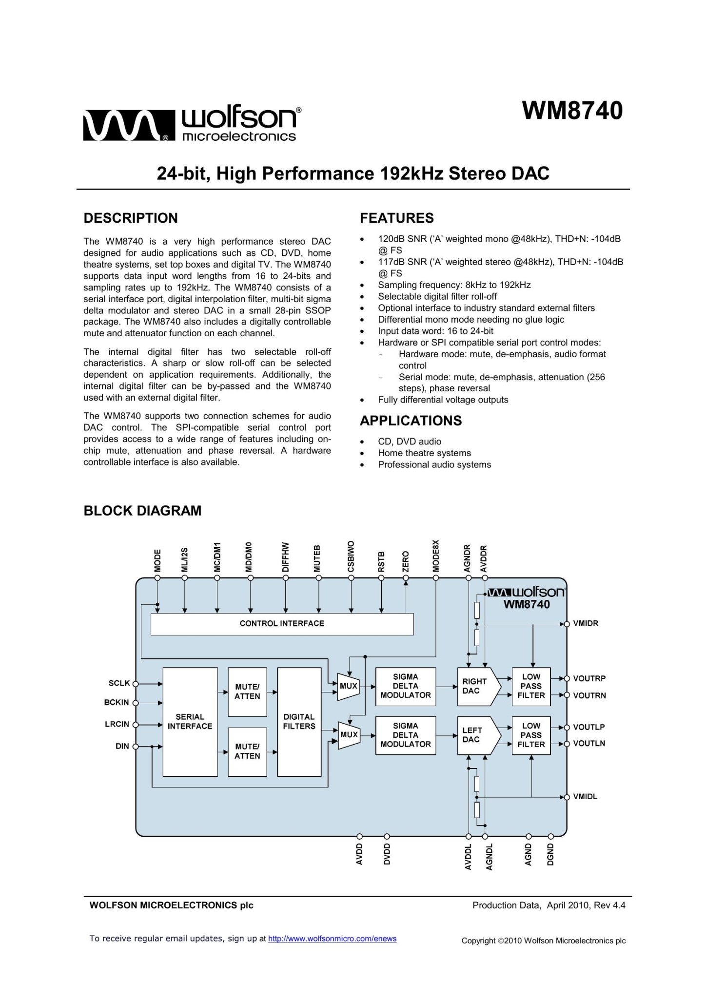

Hi. I was thinking about improving the DAC in the Arcam CD72 player. Currently there is PCM1716 dac. I would like to put WM8740SEDS dac chip instead. Pin by pin they seems to be the same. Could someone advise me if it is enough to "resolder" the chips or I need to do something else?
