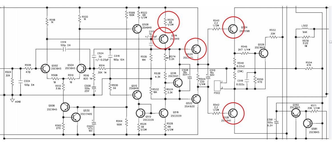

I had problems with a AVR200. DC at the output of one of the amps. Check if you have any DC over 100mV.

Replaced the devices and now have some problems with dc, I'm guessing, as the amp automatically goes into fault mode.
How did you solve it audioDIY?

The dead components have a red circle.
R524 (open) was the DC offset cause after replacing all transistors.
Thanks audio, checked the board and found an additional resistor down- I had replaced a few.

Turbo, can you isolate different modules from the psu?
I would try and isolate and see which one sends it into fault mode.
I have done this with my avr, and found that a resistor in the power amp module has gone high- sending the amp into fault mode

Thanks audioDIY,
that snippet of diagram and your reminder to check the resistors (d'oh) have breathed new life into the avr!
