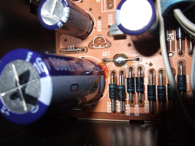

I noticed this when looking at the boards
Its a 6800uf 16V cap
does this look like electrolyte leakage? I don't know what part of the circuit its on

The gunge could be glue of some sort and there looks to be a strand "up" the cap. If in doubt and to be sure then take the cap out and look. Glue was common practice in all sorts of kit.

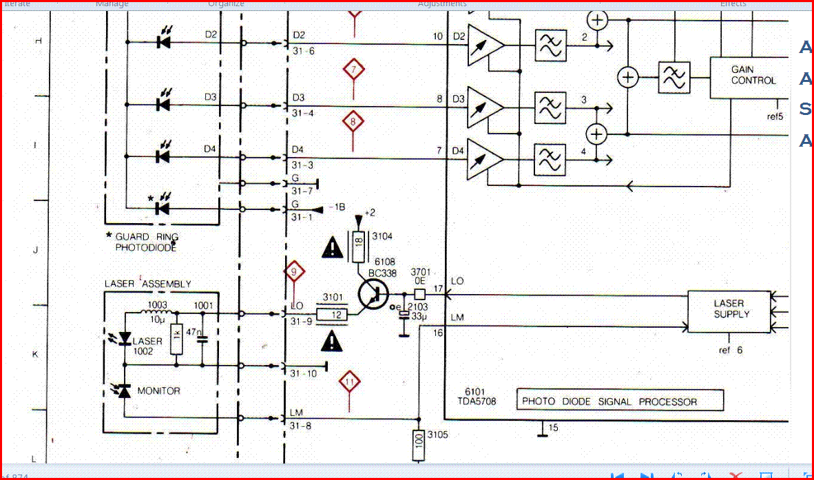

Another test that would be really worthwhile is monitoring the laser current as it warms up by rigging a DVM up across the resistor feeding the laser. You would need a circuit though and also solder test wires so as not to risk damaging the laser through "spiking" it with test leads.

Where is the current regulator pass transistor for the laser diode located?

I would have to dig a circuit out to identify the pass transistor.

This is the only circuit I have and it will be different to yours but you can see the 33uF cap and the transistor marked 6108. The 18 ohm resistor (3104) can be used to monitor the volt drop across it and therefore laser current calculated. The absolute value is an unknown and varies laser to laser and with temperature of laser diode but it should be fairly constant I would say.
