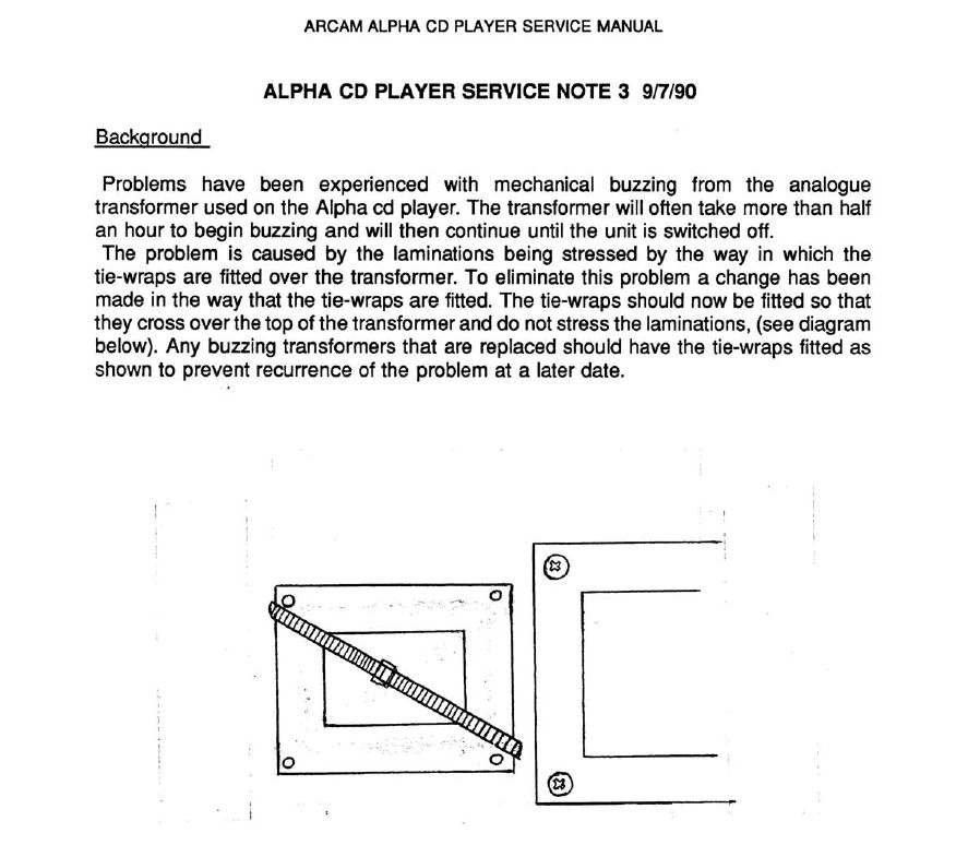

Have an original Alpha CD Player which works well.
The power supply / transformer buzzes, well one of them does.
A bit like a wasp inside the box.
I've had the lid off and powered it up to identify where it's coming from.
No buzzing through speakers and it's sounds fine.
It's just the annoying - any ideas ?
I wouldn't mind taking it offboard and using toroids instead so if anyone has tried this please let me know.
Many thanks

Hey, thanks
What a perfect reply - this has never happened before !
It was the smaller of the two transformers that seemed to be buzzing
and when I pressed down on it a bit with a screwdriver it seemed to stop !
You are brilliant !
You are brilliant !
