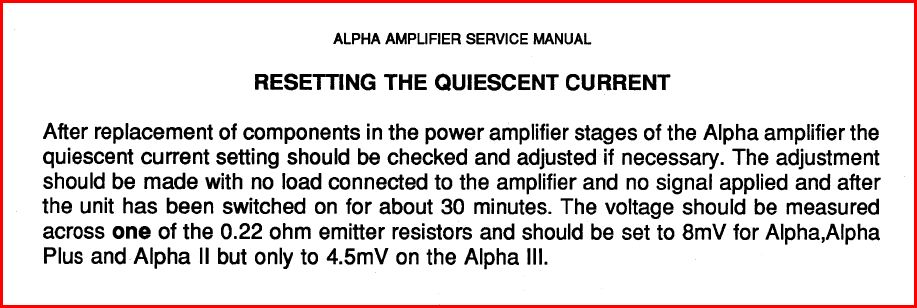

Have you checked the quiescent current. With the amp hot turn the volume right down to zero, then disconnect the speakers and check as below. If it makes it easier to measure, solder a couple of insulated wires to the appropriate test points and leave the meter connected. It's a critical adjustment in the sense that if it's too high the amp will tend to run hot and may approach a thermal runaway situation.
In the first instance don't alter anything, just measure for eg from cold, and when it's red hot, but you must do it with no signal and no load attached.
Post the readings here if you want 🙂
Edit.-- A 7.5 amp fuse makes it more likely to be the cap playing up I think.

Thanks for the tip.
I havn't checked this. I need a voltmeter which goes down to mV, which I don't have, so I'll put it on the bench at work and test it next Tuesday.
Will it be safe for my son to use the amp until then do you think?
Like has happened before, there is a discrepancy. The warning which you've kindly posted tells me to set it to 8mV, whereas the schematic mentions 7mV. Will this matter?
I can see 4 x 0.22 ohm resistors, R41, R42, R141 and R142.
It says in the warning to only check one, so I guess the reading should be the same across all 4.

You do it for each channel. Just ohms law. So it's 8 mv/0.22 = approx 36 ma. So 7 mv is about 32 ma. To be honest on this amp lower is better. Go too low and you will hear crossover distortion from the output transistors having insufficient bias. Too high and the power dissipation increases. 36 ma with a transistor that has say 35 volts across it is disipating 0.036*35=1.26watts (and there are four of them) doesn't sound much does it. Increase the current to 50 ma and it's 1.75 watt per transistor.

I got the figure from the manual in the other thread mentioned.
OK thanks. There are two potentiometers on the circuit board. Is that where each channel's quiescent current is adjusted? I can't see how else to adjust it! As I can only access the voltmeter at work, I might as well be prepared as to how to adjust it.
The one I have at home is an old AVO meter, a big black box, very old and scrapped from my workplace.
Avo 8. A swinging brick. I know the AVO 8 mk5 measures 100 mv FSD on the 50 micro amp range. I have one which I don't use much now. Thats an "official" range by the way.
Last post of the day 🙂 Look at the circuit. The 0.22 ohms are in series effectively. You may find it easier to measure across the two together, that is to say from the emmiters of both output transistors. In that case you are looking for 16 mv (8 mv across each) but that should be do-able on an AVO and easier to see.
Adjust the pot slowly, and remember that as the outputs get hot the reading will change. It's not an exact thing, just make sure that with the amp as hot as it gets it's no higher than 8mv across each resistor.
Double checked the AVO manual. 100 mv FSD use the 50 microamp range. Steady hands required, have fun 😉
