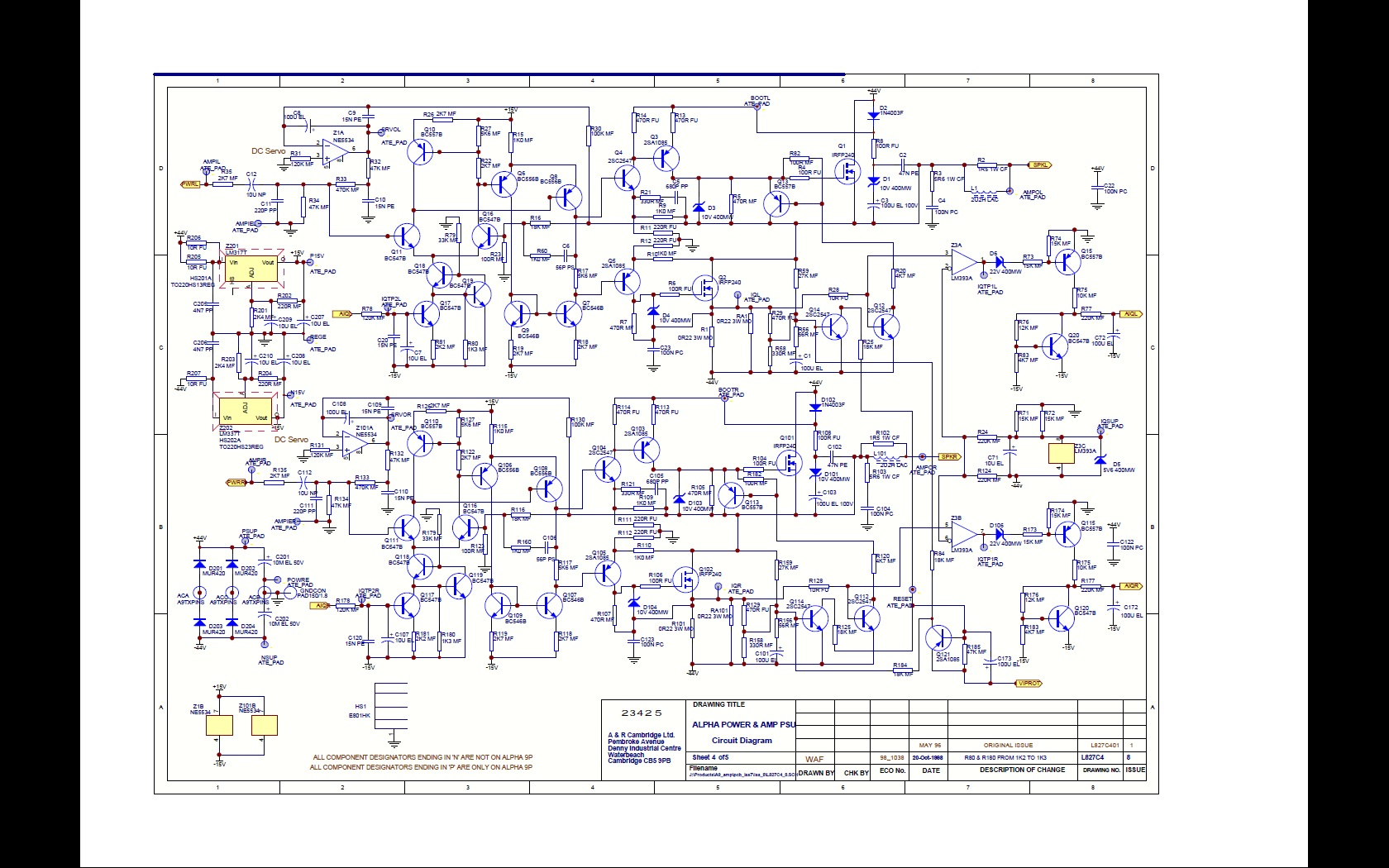

To help all the helpful guys here is the schematic of the Arcam 9P.
I would start by checking the large reservoir caps. Then check the four Output Mos-Fets

Second post - the two massive caps aren't bulging or leaking. I'm not sure how else to "check" them with a standard multimeter. What part numbers on the schematic are the output mosfets, and how do I check them?

Normally when the main fuse blow most of the time there is a shorted in the rectifiers or in the main filter caps section. Check the caps + pos side to ground or the - neg caps to ground. Remembered that there are caps for the neg voltage and the pos it is grounded. If you have a low resistance reading means that you have a shorted. If you find that there is a shorted then by isolating each components one at a time you maybe able to isolate which one it is causing the short.The schematic does not shows the power supply components so I can not advices which components to check.

What you need to do is to remove Q1, Q2, Q101 and Q102. They are MOS-FET devices so are slightly sensitive to static discharge. Just make sure that everything is connected to EARTH, including YOU and the soldering iron.
If you place the IRFP240 onto its back, the left hand leg is the GATE, the centre leg is the DRAIN and the right hand leg is the SOURCE.
With a multimeter you should get very high reistance between the DRAIN and the SOURCE in both directions and you should get INFINITY OHMs between the GATE and both the DRAIN and the SOURCE.
If either reading is LOW then the device is SHOT.

Replace all four. You should check Q3, Q4, Q5 and Q103, Q104, Q105.
