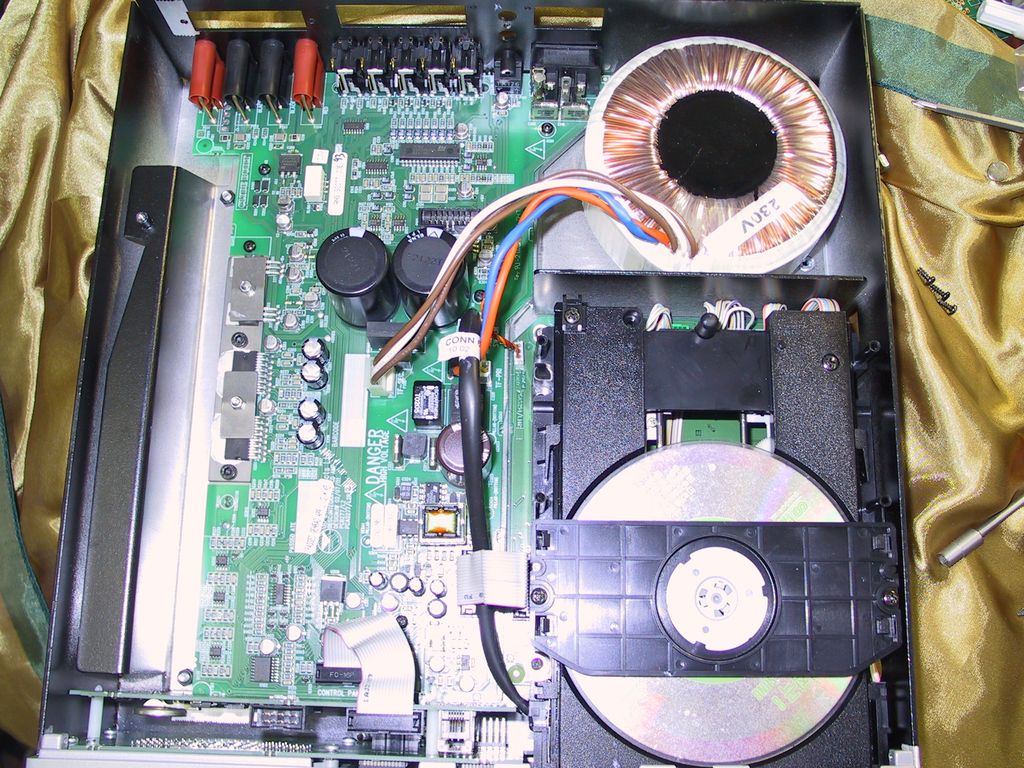

Yes, it had been fiddled with before it came into my hands.
I believe it was an upgraded Alpha 7, which was done in 1999 as far as I can tell.
When I pulled the main board from the chassis, I found an oil-like substance beneath on the base of the chassis. The whole CDP has had a hard life, with grease deposits around the buttons and numerous marks. Poor thing!
Right, after a bit of measuring, I found:
On SK204 (note that the DAC board was NOT plugged in when measuring these voltages due to access problems):
P18V was 17.3V
N18V was 17.7V
P5VDAC no reading
P5V was 5.1V
P11V was 18.4V
Couldn't work out what RLYV is, and couldn't locate it on the board.
On Z206 I measured 1.2V and 11.4V between adjust and I or O. Can't remember which was I or O. SW201C is the power switch.
Measuring FOK on SK201, pin 18 and using pin 1 as ground - the reading was 4.8V from the instant power was on, regardless of whether the laser had started to try to focus or a disc was inserted.
Does this info help any conclusions, or is it all still an uncertainty?

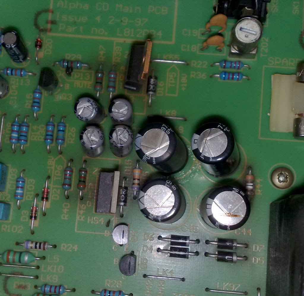

Burned PCB because of local Overheating
Hi all,
I've just received a faulty Alpha 9, and upon testing, I've found the following:
  • Upon powering on, the display illuminates, allowing apparent track selection (no laser movement at all)
  • There's a quiet high-pitched whining from the transformer/surrounding area
  • The disc spins up and stops after a few seconds
  • The laser does not move at all from the idle position at the outer edge of the disc.
  • There is discolouration to the casing above the tranny, to the casing and the DAC mounting
  • The PCB around Z204 &205 is discoloured as pictured
  • The metal part of Z207 is slightly discoloured
  • Resistor R44 is a bit burnt. Inout 31V, output 5V
  • Caps C44,4 & 48 sligthly bulging.
I'm able to use an Avo, have access to an oscilloscope, but don't know how to use it. How would I check if the tranny is dead? Does anyone know the voltages coming from the tranny?
Any suggestions as to what i could try would be brilliantly useful!
Dan

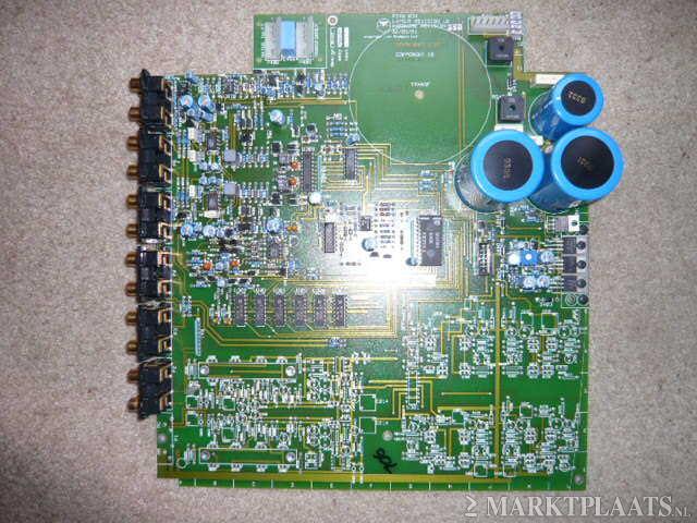

Such thinking errors by PCB design and heatsink management unfortunately are not the exception but rather the rule in the high price range of audio components. Even by Krell (KBL + PS) and Mark Levinson (e. g. ML23 No.23 Power Amplifier) there is to find the same situation.
This means in case of necessary service working, that a lot of additional work must be carried out.
What do have the so-called highly qualified development engineers in their heads while developing of such designs ?
Actually, the manufacturer would have to return a purchase price of such audio components, even after a use of 20 years.
But then most of these manufacturers would probably go to bankruptcy.

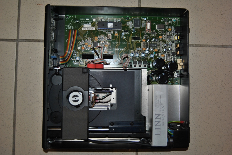

How to avoid such design errors and as consequence burned PCB aeras (and thus dried electrolytic caps) shows LINN by their products (except first generation devices LK1/LK2). All voltage regulators are mounted on an aluminum block, that serves as sub-heatsink, which in turn is mounted on the bottom side from the main envelope (housing, cabinet, enclosure or what ever the right english term therefore must be - check therefore the atteched jpg files). Now the metal housing is the main heatsink and local overheating isn't longer an issue.
Even after a long time of use the PCBs keeps always its new condition.
