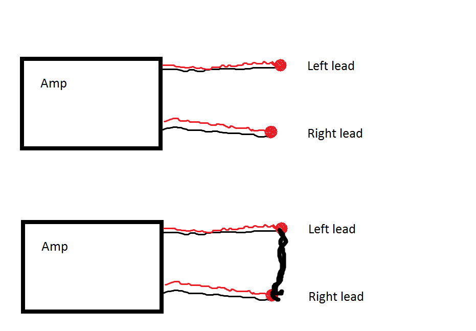

The bottom line is that it should be silent with phono leads connected and that also have the ends shorted. We then take that one step further and say it should still be silent if those then shorted ends are connected together. If it passes that then the amp is OK.

Ok, all tests done and silent with direct on/off. Stuffed small bits of foil down each plug, leaving other ends connected to amp obviously. Does this tell me any more!?
And is it silent when the two shorted leads are also connected together as in the lower diagram here ? If so, then the noise is being introduced externally to the amp. That can be either as 'hum voltage' from the player, or induced hum into the lead/s from external magnetic fields (which means from transformers in nearby equipment).
Like this. Both should be silent.

Yes, I touched both ('foiled') plugs together and it was silent. There was plenty of foil stuffed down each. Will see if the ground loop isolator has an affect when it turns up.

Let me just expand on that bit. If it hadn't hummed in that state then that would prove the amp was OK, unfortunately the fact it does hum doesn't automatically mean the amp is at fault. When unplugged from the mains the players circuitry is 'floating' and depending on how its all configured, it could be prone to pick up hum. Normally in that situation, plugging the player into the mains ties everything down and the hum would stop... but yours doesn't.
That is why we went on test the amp with its input leads shorted, and then shorted and shorted together, left and right. That has to be silent and it was.
That then comes to the bit I mentioned in the post above... the obscure case of an amp that hums when the impedances seen across the inputs are not low enough. No commercial amp should fall into that category as its caused by basic design flaws in the wiring scheme.
The way to prove that. You need cheap phono sockets to plug the open end of the leads into. You then terminate each socket with a resistor (say 10k). The amp should still be silent and still be silent when (this time) the two grounds of those sockets are touched together.

Great, thanks for the info. The nagging thing that bothers me is the buzz/hum only occurs when the direct switch is off in the situation as described. With all the tests as you suggested, it was silent with direct on or off.
Obviously there is just one left lead and one right lead and the tests were completed in order as instructed.
