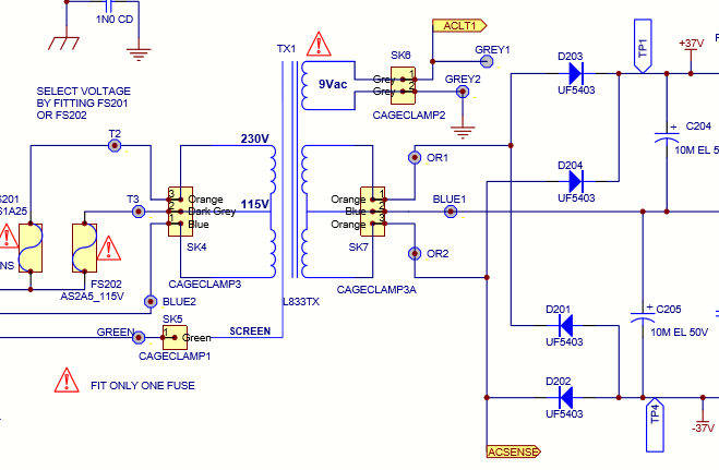

......I don't know if the toroidal transformer is the problem anyway......as far as I can tell, the output from the transformer to the circuit board is 2X9V?The dimensions of the original transformer is about 100mm diameter and 35mm deep.....Is it worth pursuing this or is the problem likely to be elsewhere anyway?....
The schematic shows that the 9V winding is only for small 5V dc supply to the the microcontroller and remote volume control motor. The main amplifier power is a centre tapped winding identified by 3 wires (orange, orange, blue) as shown. Any direct replacement would need to have both the single 9V and the centre-tapped 50VAC winding (or dual windings of approx. 25VAC each. The VA rating for 2 x 40W/8 ohms amplifiers would need to be at least 120VA (a standard 160VA would be ideal but skimping on transformers is legend with many manufacturers.
If you want to find out whether there is a problem with the transformer, the obvious way is to disconnect it from the rectifier and the rest of the amp. Note there are connectors to make that simple, SK7 & 8. 'not sure what "cage clamp" means in that application but I assume it means connector rather than soldered or crimped joint. In any case, label the leads so there is no chance of forgetting which connects to what, then disconnect them and recheck the status. I'd be surprised if the transformer blew any fuses now.
If you are tired of blowing fuses (note only 1 is used), be sensible and fit a lightbulb limiter as advised time and time again on this forum - Google it 🙂

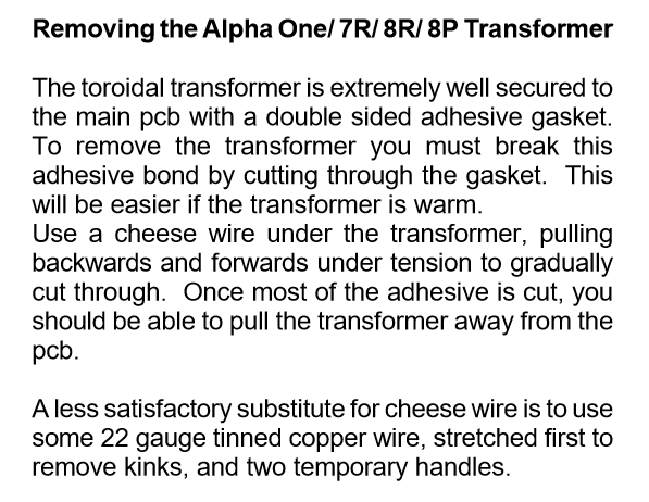

Hi rabbitz. No clear indication of the fuse type on schematic or parts list. It seems 1S2A5 is on the schematic is a code unique to Arcam but the parts list calls for "FUSE 20mm 1.25A AS" There is no suggestion on the net that this means anything more than a standard (fast blow) type.
For interest, here's why you don't want to replace the transformer on this series of Arcam amplifiers, if you can possibly avoid it - yep, a truly inspired piece of high-tech assembly 🙄

Thanks everyone for the prompt replies and sage advice. Yes, I am definitely in way over my head and think it best this amp is broken up into PCBs metals plastics and recycled.
To answer the questions posed:
Yes, the Transformer was a challenge to remove and I carefully sliced through the sticky securing material with a blade.
