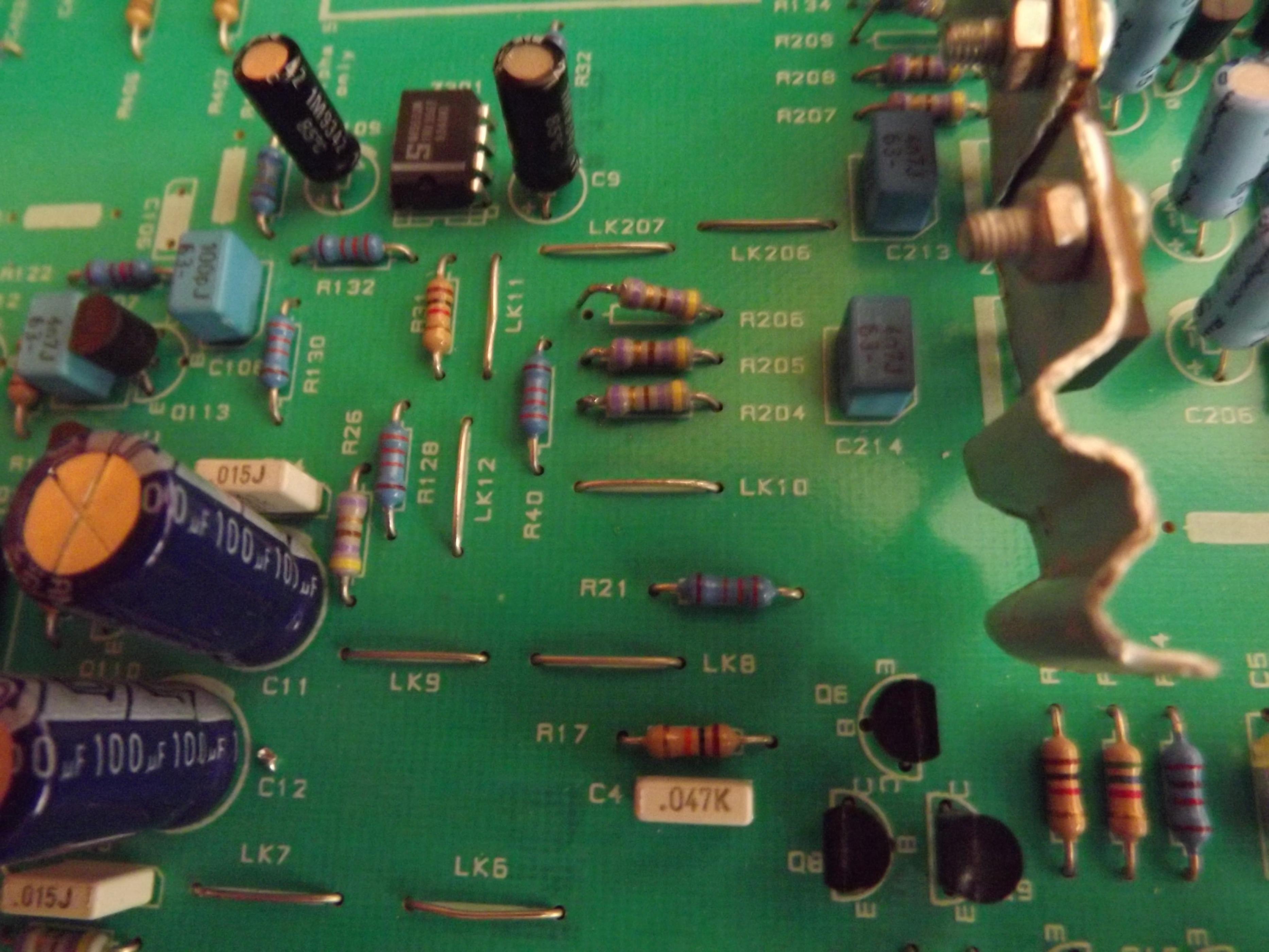

32mA with max drop of 7.4v = 236mW across the two 470R. One resistor may be carrying more load than the other so its pushing the limit if they are 1/8 Watt resistors but I think they are 1/4 Watt. Photo attached.

It is near the limit but as I mentioned before, the current is very low which gives the regulators an easy time. 24 volt regs splits the dissipation between the two.
