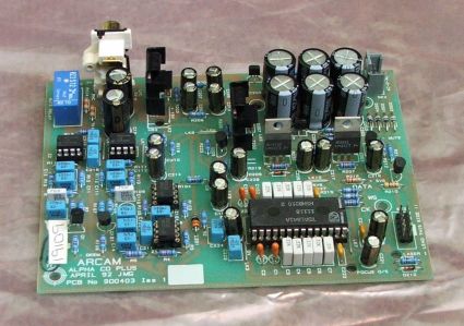

To confirm Anton, I did mean the analogue output stage is functional (no audio coming out of DAC) - apologies, I should have made that clearer. I might try a socket temporarily while I'm fiddling with it. I'm curious about the 'crowned' versions of the TDA so might do some swopping around later, then revert to a proper soldered job later.
Looking at your photo the board is quite different to the 5. I'll try and sort a camera out and post some pics if of any interest?

Testing it using a TDA1541 may not work. The only important difference in your case is the function of pin No4, DATA R for the TDA1541A, and DATA R/SCK for the TDA1541. The TDA1541 expects a clock the same frequency as BCK on pin 4 while running in time multiplexed mode (which yours is).
Try testing the TDA1541 in the player as is. It may work, as many designs have pins 2 and 4 connected to provide compatibility with a TDA1541, in the same way that many TDA1541 circuits include a DEM oscillator cap.
If this doesn't work, I would just get hold of a TDA1541A. There isn't a huge chance of damaging on, as long as you observe static safety precautions, and check the voltages of all the supplies to the chip before you fit it. It wouldn't be the end of the world if you smoked one anyway, my offer to lend you one still stands.

PS: after looking at a few things, I see that the Alpha 5 and Alpha + are completely different beasts, despite using the same mechanism and the same DAC chip. If you post me the service, I might be able to be more helpful, I have PMed you my email address.

Anton, I had a look at the schematic - TDA pins 2 & 4 are tied so perhaps I'll try the non-A after fitting a (temporary) socket. I do intend getting the proper A version but it would be nice to prove the fault before purchasing. I will email the service manual to you shortly. My Alpha 5 has the CDM-9/44 mech, looks like your Plus has something different?

Thanks for the manual. Your player is definitely compatible with both a TDA1541 and a TDA1541A, having both a DEM oscillator cap and an SCK input. Testing with the spare TDA1541 you have would be useful.
The reference list of CDP/DAC/Mech I use indicated an Alpha 5 had a CDM-4, which was wrong, it has a CDM-9 as you say. The Alpha + uses a CDM-4/11. The Alpha + is really a Philips CD482 with a new case and DAC board, quite a common practice at the time, saved on R&D.
Be careful removing the old TDA1541A when installing the socket, in case it isn't at fault. Have you used desoldering braid before?

It's been a while now but recently fitted a socket and plugged in the TDA1541 and success!
So then got hold of a new/old stock TDA1541A which is in there now and very nice it sounds too!
