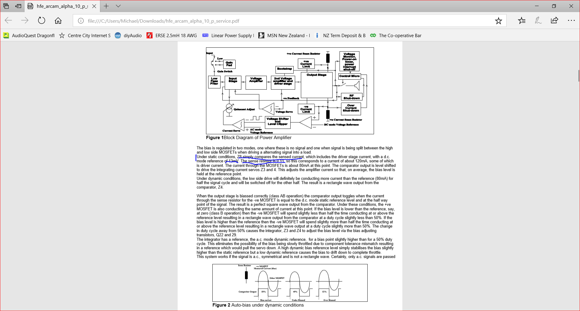

Thanks mjona, you sound like you have had a great deal of experience but like i say that issue is now repaired. But i wonder if you could help me with the 10p issue? I was wondering if i just change both Z3 and Z4 and Q22 and 29 it might solve my high mv problem, what do you think? Thanks.
From your description in post 13 on page 5 - I think it more likely your problem is due to an inordinate delay in the charging of a capacitor somewhere in the circuit.
One that is leaky or has a high resistance solder join in a part of the circuit shared by both channels would impact on both - this might be a process of elimination - starting with inspecting the work that was done by the previous owner.
The op.amps that control the servo and bias are derived from Z1 and Z2.
Do the supplies to the supply pins on Z3 and Z4 rise to + and - 15 volts at the same rate?
As far as the servo's Z3A and Z4A are concerned there is a time delay for C71 and C73 to be charged from the output terminal via R176 and R178 so there would be some delay in stabilising the dc offset - so indications this is functioning but under severe handicap.

What sort of time does it take for the dc at the output to be corrected on power up and what is happening to the input and output voltages on the dc servo op.amps during this process - Is it safe to assume the input and outputs are in synch.
The bias servo monitors the output current in one half of the output stage and there is a bootstrap capacitor which needs to be charged in the other half. Z8A -Z8C in one package are involved in the bias function.
The part of the diagram near Z8C mentions "power off auto bias defeat" there could be a problem with this section powering up due to say C16 being leaky and the associated circuitry interpreting a charging delay as being due to switch off.
C16 a 10uf 50v cap? was changed also. The units behaviour did not change after recapping.
I assume you would have replace C15 also there is a label "Fault" in this area of the schematic that connects back to the display PCB - is there a corresponding LED that lights up during the turn on period?
Yes C15 was replaced. There is no other led just one press power, Led is amber for three seconds then it turns green as the speaker relay kicks in. No fault indicated. Also remember this is the power amp version, so no display.
