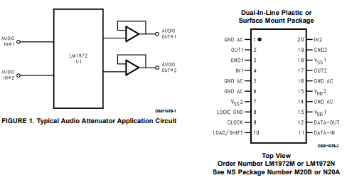

Hi, I have a really nice Alpha 10 that has a problem with the left channel. The right sounds fine nice and clear, but i have to turn the left all the way up before i hear the slightest sound. I used the pre-amp outputs and plugged it into a separate amp, and sure enough the right sounded fine but the left was non-existent. So i think we are up too the pre-amp being the problem. I changed a couple of caps that were a little high but that did not solve it. Do you think perhaps i should change the LM1972? Do you think that would solve it? Also is this just a drop in part or does it need firmware? Thanks.
If you have no output from the preamp, there is more to look at than just the volume controller chip. First though, you might check that the chip's output levels are the same with the same input to each channel input.

Thanks for that i do have output from the right. I will look into it, also with the sound turned right up and only the left speaker plugged in, the slight music I can hear, is coming from the amp itself, not the speaker? Is that strange?
This is likely just cross-talk. i.e. the leaking of one channel into the other throughout the signal chain due to the proximity of wiring, PCB traces, switches with contaminated insulator surfaces and via the common power supply. It's inevitable in any analog multi-channel system and you can read it from the amplifiers spec. (-80 dB @ 1kHz) but usually it's more at higher frequencies. Given the large dynamic range of audio, a little cross-talk becomes a significant and clearly audible quantity at the loudspeakers in the absence of the good channel's overriding power output.
You won't learn much following this line of investigation. You need to look for full strength signals by tracing them properly, following the schematic (see service manual).

To start troubleshooting - at these connection points/nodes you must perform sound check with an independend low-output power amp/computer speaker as follow:
- output LM1972/input power amp
- input LM1972
- output source select (input selector)
- inputs source select (input selector)
Which nodes sounds identical to the working channel and which not - that is the question.
If there are C-MOS input selector IC parts, maybe one of them is faulty.
Check also the (very worse quality) speaker selector switches "SP1" and "SP2"
