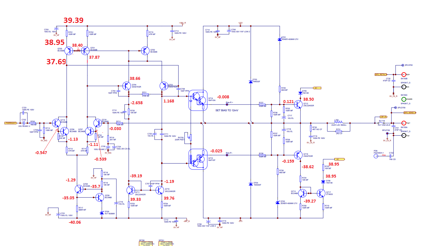

Here are the DC voltages for one channel.
All the active devices "after" the output devices don't appear to be doing anything, but they also don't look like they should be conducting.
The collector current for Q719 and Q718 looks too low to be correct, but I've been wrong before!

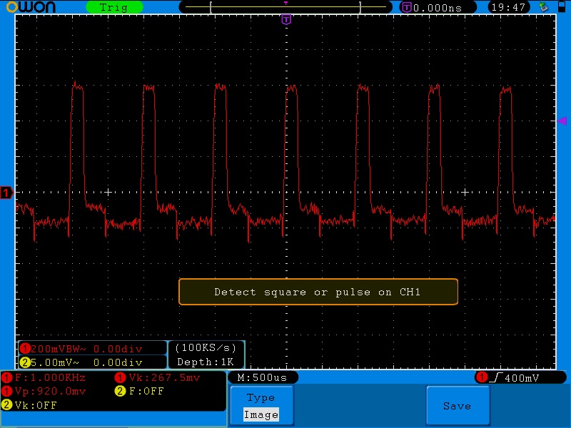

Well, it looked like I could just pull the output devices and the amp would be happy enough to keep running, and that would also remove the feedback loop, so that's what I did.
Here is the collector of Q619 trying to play a 1kHz sine wave. What's rather odd is that at lower frequencies it looks equally garbagy.
