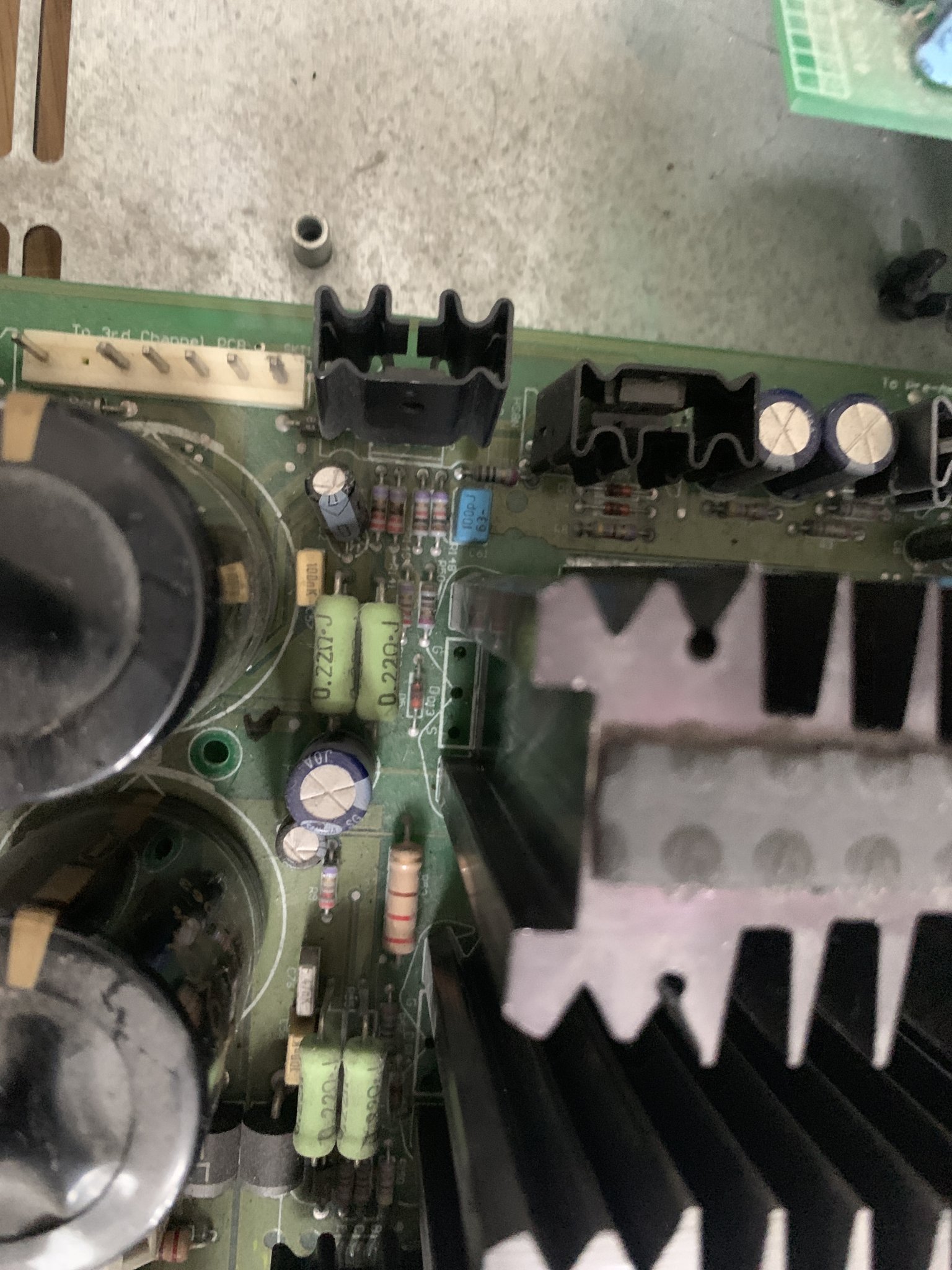

I removed the two faulty MOFSETs from SP1 and powered it up, it stayed on for 5-6 seconds but I culd start see smoke from one of the resistor.
If I replace the MOFSETs could it fix the issue?
I'm wondering if you remove the MOFSETs from one set of speakers shouldn't really the amp stay on but not burning anything?
( Service Manual Attached )
It came from this area but can’t pintpoint the exact resistor
One of those top left resistors looks burned. They may be these.
That may be because with the FET's removed the feedback loop is broken and all DC conditions change. Would it work with new FET's its hard to say as there may be collateral damage around the driver transistor stages.
