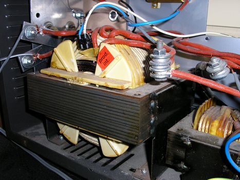

John Biles said:Hello EWORKSHOP1708, it's good to see that someone else may find using a Welding Transformer of some use.
Modern inverter machines are even better, i source most of my componets for ongoing 4kW class-D sub-amp from couple of
Kemppi welding machines. EE65 cores, 2 pieces, STW20N50 mosfets, 10 pcs, diode bridge, 470uF 450V input caps, 1600V 0.22uF FKP film caps, current transformers, PTCs, plenty of matched 55A 600V IR warp-speed IGBTs and so on...

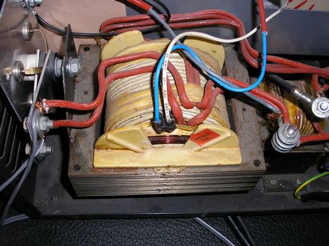

Hello Sparkybq,
the transformer in question is 170mm x 160mm x 160mm and i have no problems moving it around.
it just looks like a large every day EI transformer, noise wise when i finally put it in the amplifier i am building it will be well insulated for noise and safety.
As i plan to build it, move it to the position i have worked out for it, it will remain there most likely for years.
As i plan for the front and sides to come off quickly and each board to easily unplug, weight won't be a problem, may even help if so thief tries to steal it.
One of many reasons why i decided to try the transformer is that the cost of buying at least 2 normal transformers for a 5.1 home cinema Class A at my local parts store was about $170 Australian Dollars, and i had this high Amp Transformer just sitting there with the correct voltage i needed.
With a new family and the cost of living, the budget would stretch for my hobbies, so cost cutting is the way to go for me.
i normally only listen to about 8 hours of music a week, so the extra electricity won't be a problem.

absolutely, they are better.
And the same result can be achieved with 4kW SMPS, made for powering amps. And it will be lighter (more than a half maybe) than the welding one.
Welding transformers and inverters are more current source devices but voltage source devices.
Most audio amps needs voltage power source. Voltage power sources are easyer to make then current ones.
With voltage SMPS the problems one needs to fight are completely different than for current sources. These (voltage) power sources typicaly have less parts and simpler schematic, and smaller transformers/chokes, so are more compact and have less weight, and are cheaper usualy.
But most audiophiles(at least most i know) would not use SMPS in any form for powering their amplifiers anyway. They claim this ruins the sound quality.
Maybe it does,but I am not an audiophile, but rather more practical (I try so) person. It is not practical for me to build 30W Class A amp that consumes 300-500W, then go and get 1000W transformer for it, then make horn speakers that once fitted together in your living room, there is not space for more then 2 people. The sound would be excellent, no doubt about this, but it is not practical enough for me (and most people).
But again, if one is happy about all this, then he/she🙂 must not listen to anyone, but do it anyway.
So, be happy and cheers

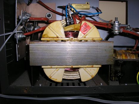

If you can, post a pic of the transformer!
It would be cool to see if that kind of transformer would be good for a low voltage, high current amp for driving loads 1 ohm or less.
If you build an amp with lots of parallel outputs, with lots of amperage, you could wire speakers all over your room and connect them all to the same amp.
*I'm doing an experiment myself with a battery charger transformer.
Batt charger was 12V 10A , transformer measures 13.5-0-13.5.
Lots of amps and low volts. Thinking of going BTL into 2 ohm, with triple darlington or CFP.
It's DIY, do whatever you like. 😀
- Arc Welder Transformer used to power Amplifier
