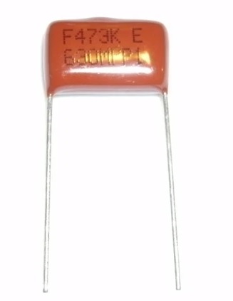

Arc supression cap
I've always replaced defective suppressor caps on switches with 0.047uF 630v poly caps and never had an issue.
Of course, you'll get a slew of responses next for those "x" rated caps by the adament purists.
But since these caps are not used directly across the line, an "x" cap is not a requirement.
I have some 250V caps on hand, is that too low to account for inrush/surge?
Yes.
I prefer to use the 630v rating caps to insure reliability. (for 120v equipment)
Like I said before, never had an issue that way.
Having to work on customer equipment for decades, and considering liability issues, I want my customers to be satisfied, I don't need lawsuits.

To be clear, do you mean 630VDC rating, wiseold?
Yes, DC, to be clear.
Buy yourself a bag of these and you'll be fine.
