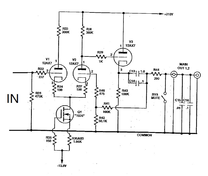

Hello every one,I plan to only clone the ARC SP16 Preamp,which MOSFE can be used for the Q1(1036)? is there any way to use a tube for this ccs? any comments or suggestion.Really appreaciate.

A number of depletion mosfets like the DN2540 will work fine. And so will a pentode. R36 will obviously need to be adjusted.
But why clone a preamp which was never known to sound any good? Even ARC themselves saw a bit of light and moved onto higher current, nfb free circuits.

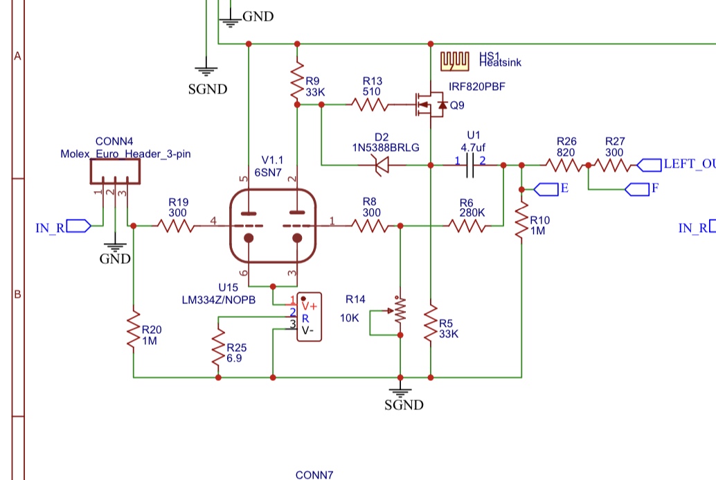

Your on the right track, below is an example of a similar setup using 6SN7’s this arrangement sounds fabulous, if you want to stick to 9-pin tubes I would use a 6CG7, use a MOSFET as a sub for the cathode follower.
And LM334 as a ccs.
The gain is adjustable as well.

Quite agree, I see one problem on first glance with their scheme, the first triode needs a coupling capacitor after the 300K load resistor, over time their would be a tendency for the circuit to start motor boating!
And LM334 as a ccs.

Looks like something I might try. Couple of questions.
- Do you know the HV supply needed?
- No load resistor in the first triode?
- What is the gain?
Thanks.
Its also a diferential schematic, it doesn't need a resistor the CCS fixes the operating conditions of that triode, the gain depends of the tube, with a 6sn7 will be like 10 (I'm guessing 😎) the HT something like 100-200V (IR820 has a rupture voltage of 200V Max) you can use a DN2540/IRF710/FQPF3N60...
- What is the gain?
Thanks.
I’m running them at 250VDC, the first triode is basically a cathode follower. The gain can be set from about 12dB to about 18dB, depending on the ratio of the feedback. I think the variable resistor should be around 25K instead of 10K.
The 334 is set for a 10mA cathode current.

Totally true with FETs - however there is no adjustment provided. I may be the 1036 is supplied for a certain pinch off. DN2530 seems to have a high pinch off in simulation although is not clear from the datasheet. The simulation models are from microchip website.
