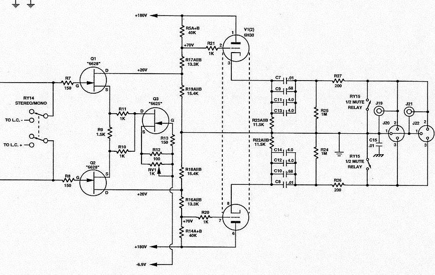

ARC LS25 mkII tube change
just check +/20V points
re- set with pot if needed
but - if nobody didn't tweak them , they're probably fine
