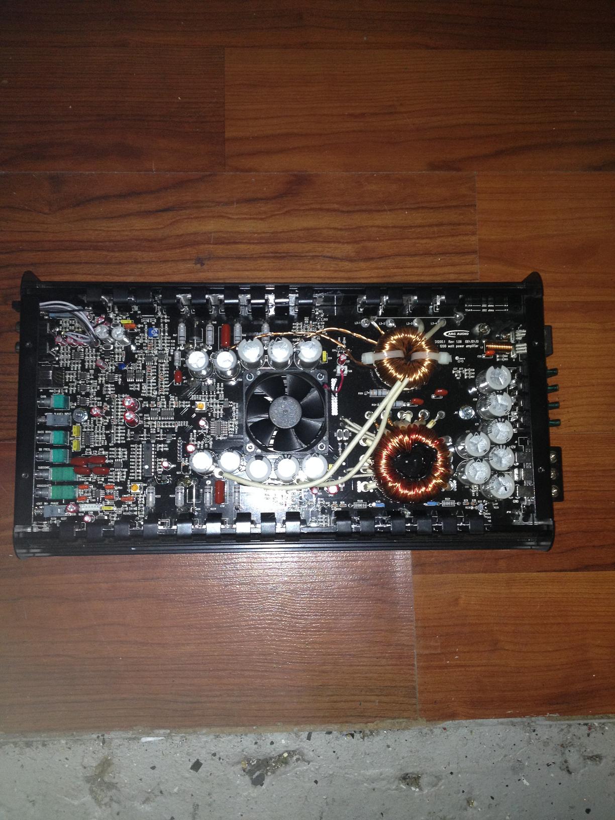

I have nothing on this amp specifically. It could be similar to other amps. Photos may help. When you ask for help with an amp, you should post at least one photo of the entire board.
It doesn't look familiar. In the future, crop the image to leave just the amp or turn the camera so that the amp completely fills the frame (best fit to frame).

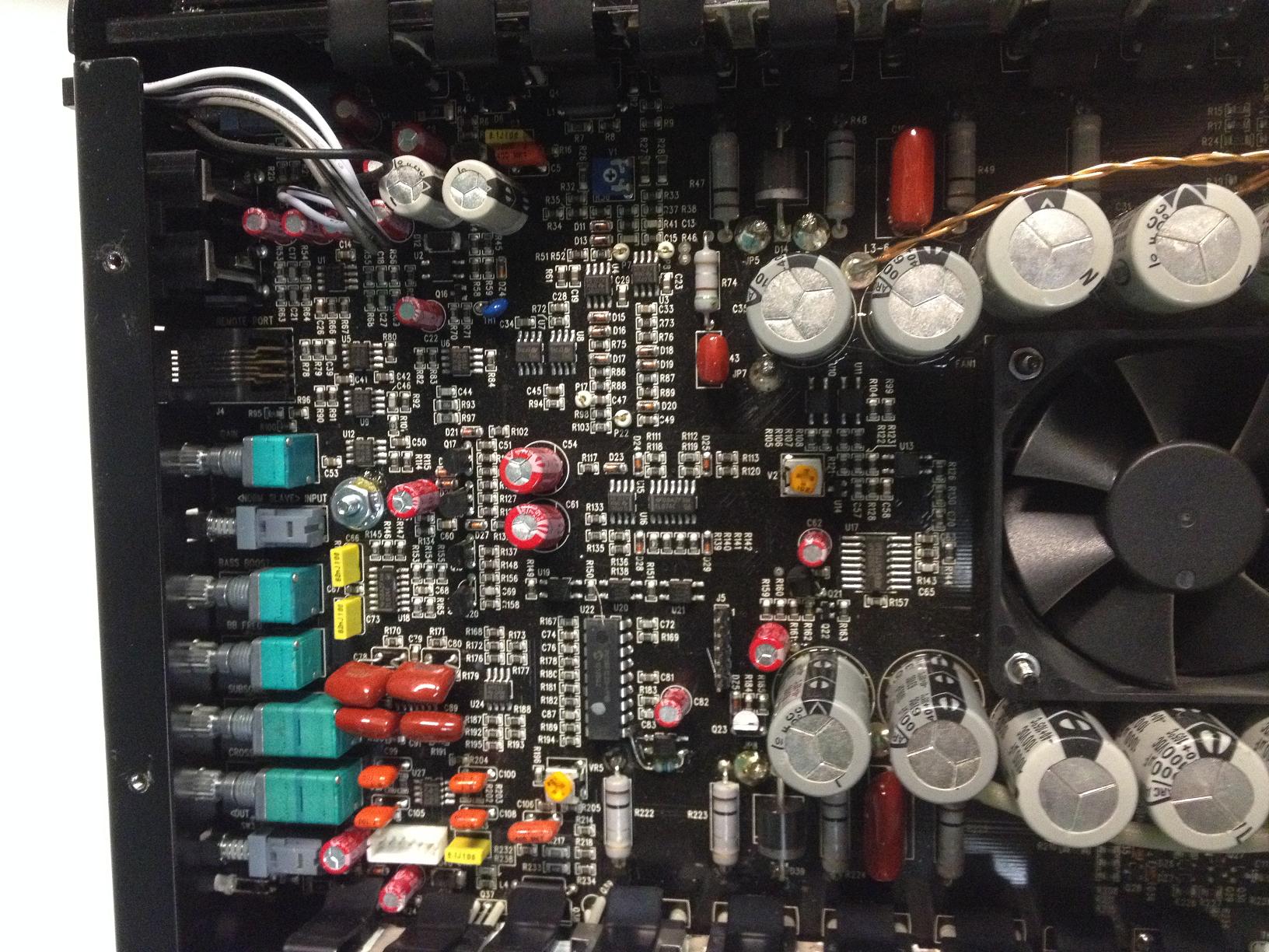

Heres a better pic of the board..
I got the amp to power up and produce clean audio on the bench didnt do anything to the amp it just powerd up and played fine..
Problem im having is in a car the amp will turn on and play but as soon as you increase the gain at all or bass boost the amp will go into protection mode..
It was hooked up in 2 diferent cars and the setups were different so a diffenet sub and head unit amp still protects after trying to increase the gain..
Just wondering if anyone had a similar problem or know of any good place to start looking on this amp??

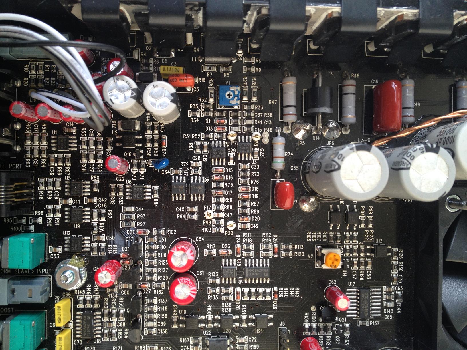

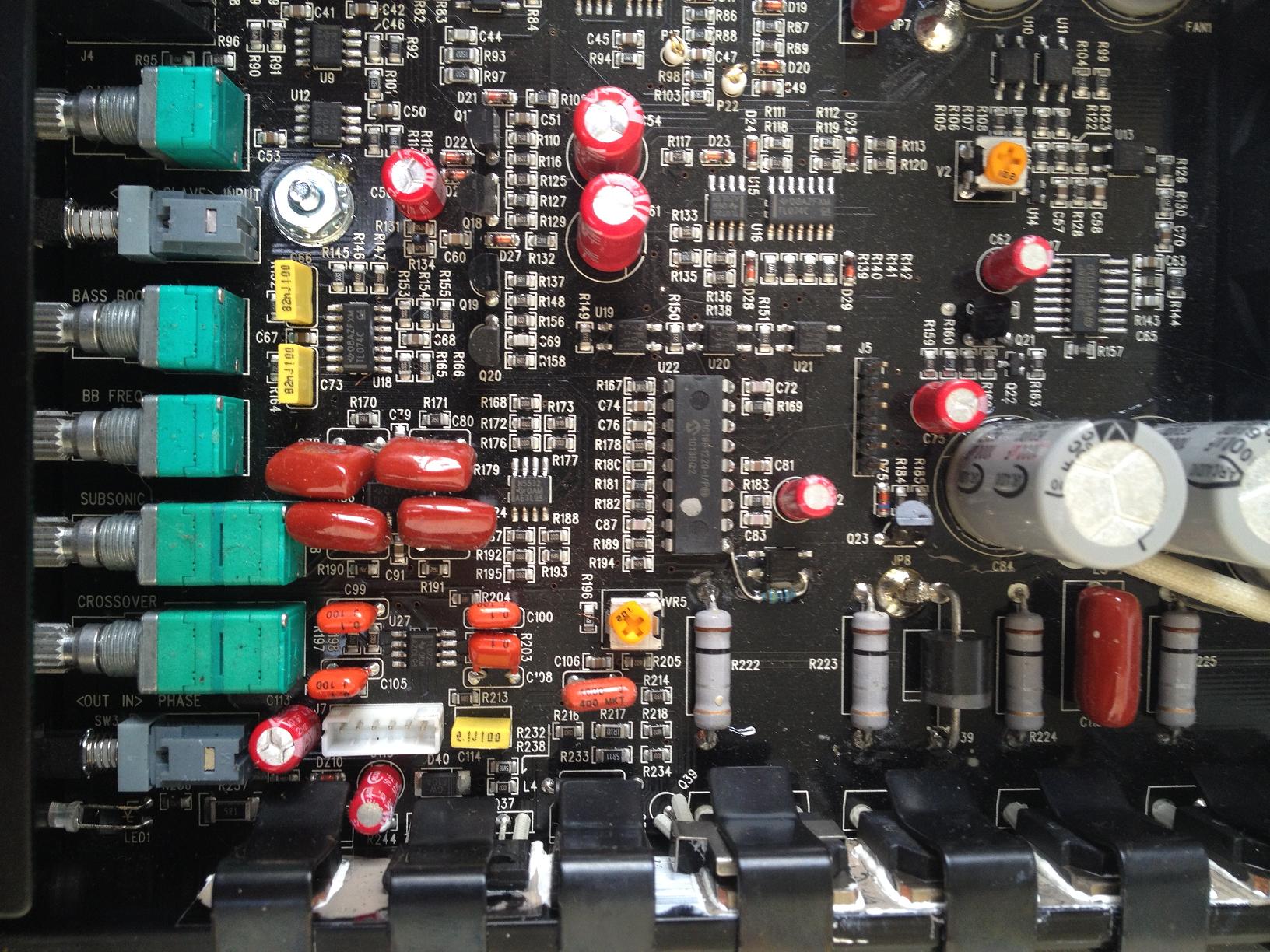

I see there is pots on the board guessing 1 is for bias and one maybe for DC off set
Wondering if this is something I could do or would it be better to send it back to them

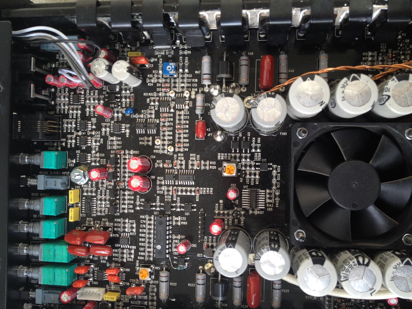

Can you post clean, close-up photos of the pots and an area of about 5"x5" around the pots?
If you don't have enough light for you camera to do it tonight, take it outside tomorrow (under diffused sunlight, not direct sunlight) and take them.
Just took some pics of the areas
I will post them up in 5 to 10 mins after I resize and crop them
