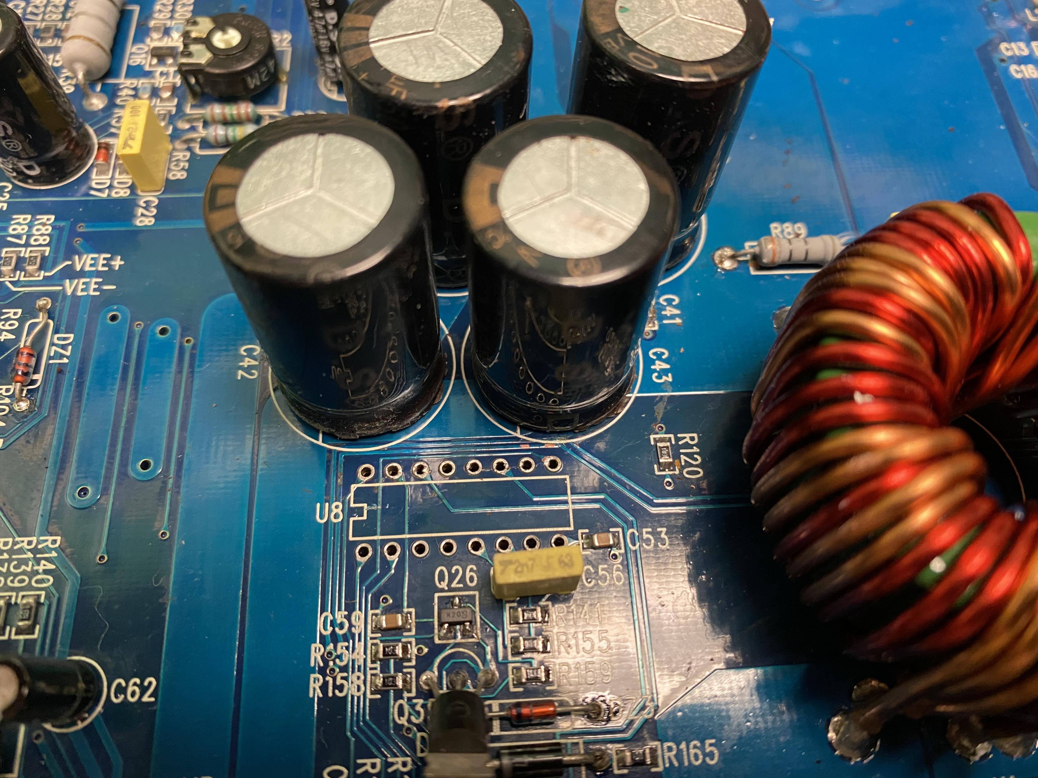

Pins 13,15 of the 3525 go to a 2N6715 transistor .
On the emitter and base I have 0.00 volts
On the collector I have 13.80 volts .
Wondering if it’s bad
Is there a transistor I can put in to replace it for testing ?

The transistor and diode (ZD3) test fine out of the board .
Should I remove the caps and clean all of that glue off the board solder the caps back in and see if it will power up ?

Check DZ2.
Post a photo of the area around that diode and surrounding components. I need to be able to read the values.

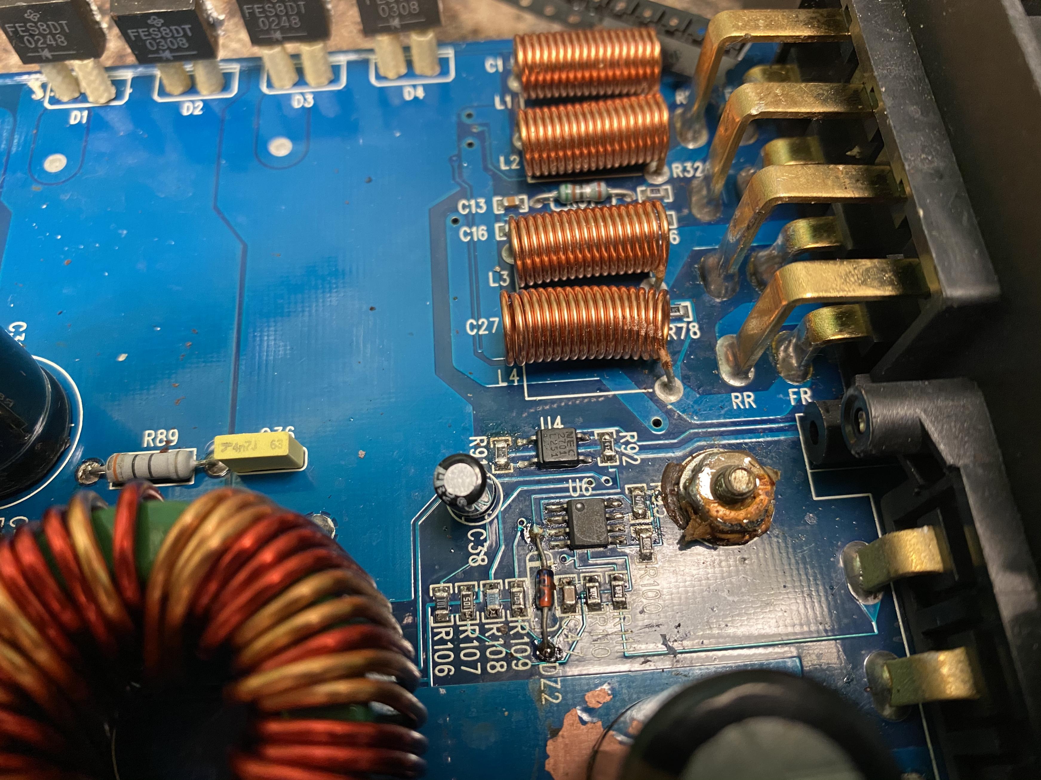

What is U6. I can't read many of the values due to bad lighting and resolution.
Give me the DC voltage off all of the terminals of U6.
U6
Lm393
Pin 1:12.67
Pin 2:5.72
Pin 3:11.95
Pin 4:0.00
Pin 5:5.60
Pin 6:12.68
Pin 7:0.00
Pin 8:13.93
Lm393
Pin 1:12.67
Pin 2:5.72
Pin 3:11.95
Pin 4:0.00
Pin 5:5.60
Pin 6:12.68
Pin 7:0.00
Pin 8:13.93

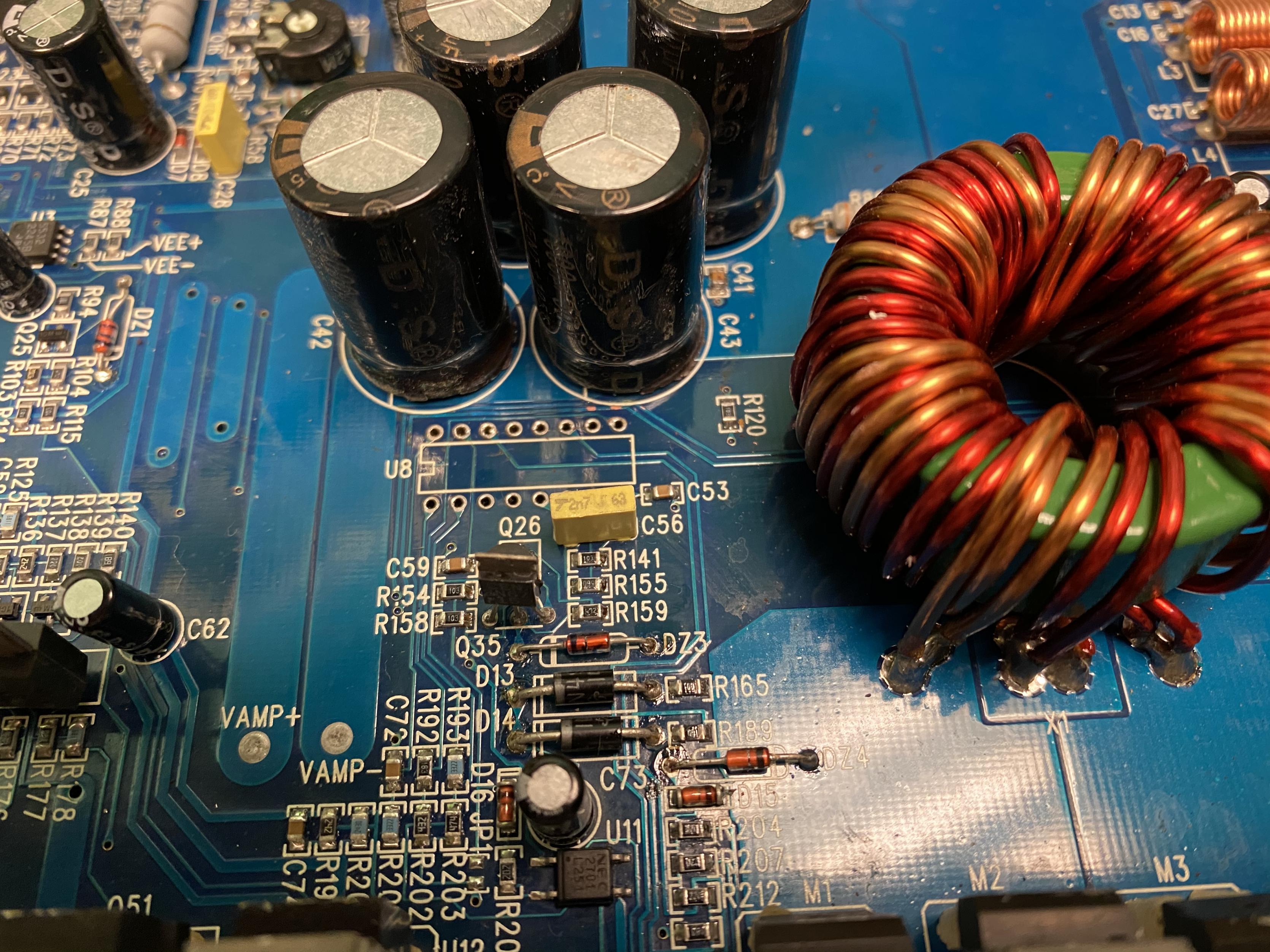

The collector gets its voltage from Q35
I replaced Q26 and still have no voltage on the collector .
Is there a transistor I can put in place of Q35 2N6715 for testing ?
