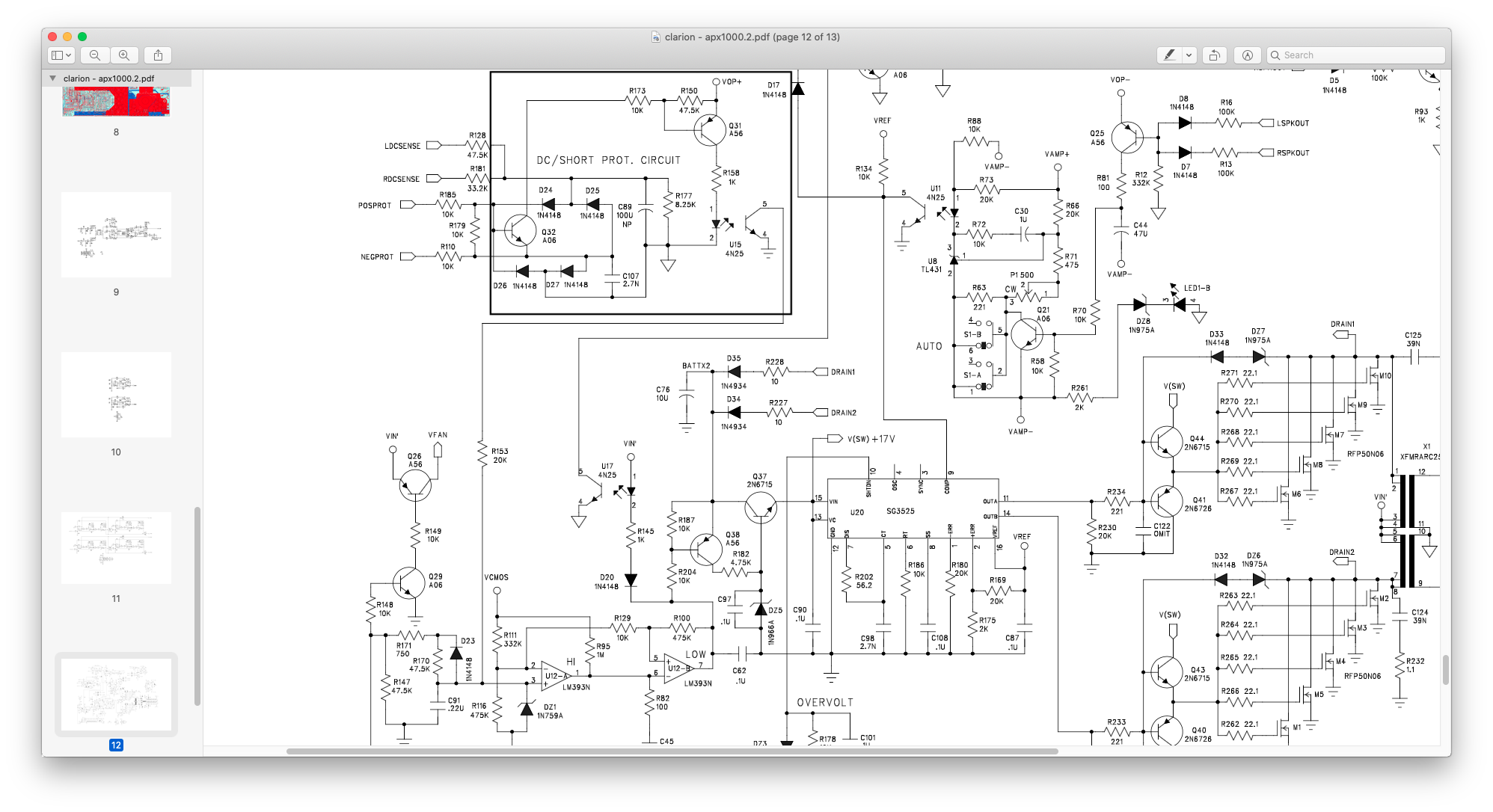

This one keeps cycling on briefly then straight back off. The power led lights briefly. No other LEDs. None of the large transistors are blown afaik. Found one broken rectifier leg so removed all rects. Ps powers on without rects. New rects in, and amp won’t power -only briefly cycle.
Amp is using sg3825. I was thinking about raising pin 16 to see if the amp will power and hold fir further troubleshooting.

I've found D19 dead shorted and cracked as in a pice missing. Also D21 was checking OK but also looked cracked. R156 blown open (10ohm) which I've replaced.
D19/D21 are pink Zeners with a black stripe, but NO other markings nor numbers. Through hole. Clarion APX1000.2 SM says they're 1n4148.

While I'm sure D19 & R156 were definately needing to be replaced, unfortunately the amp still fails to power up.

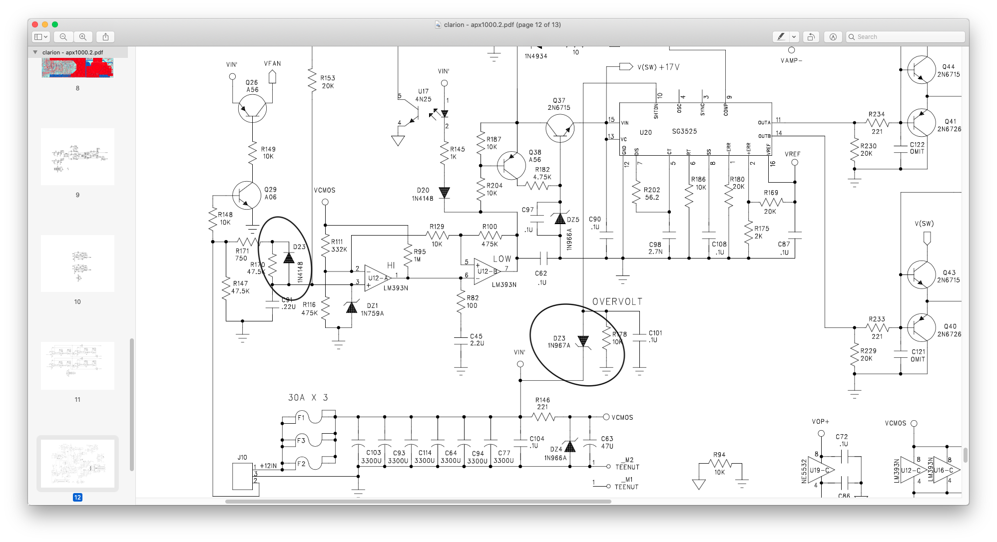

I lifted one side of DZ3 (1n967A) and the amp powers up with 1.2A draw. Searching for the reason now.

I was wrong in post #8. Actually, I did mean to lift DZ3, but instead I actually lifted D23 in error and by mistake. Still, not sure why lifting D23 worked in terms of powering on and amplifier actually playing like that. Looking over the schematic.

Since lifting D23 on accident caused the amp to power and work from all that I can tell, I'm thinking either something within the following boxed area of the schematic has failed, or possibly U12. I'll check through this another time though.

Yes. Definitely with D23 installed, the amp power cycles. I even replaced D23 and no difference.
I pulled C91 and its testing fine off circuit. With D23 installed and without C91 amp doesn't power (cycles).
Resistors R147, R170, R171 are all fine.
U12 LM393, referencing amp ground terminal with D23 removed, C91 installed.

How are these voltages different when D23 is installed?
The output of this IC is an open collector (can only pull down) and is pulled up by very high value resistors. The meter is loading the circuit, pulling the voltage down.
With D23 installed, its a little tough getting some of the measurements on U12. I had to run REC and observe MAX/MIN on my Fluke 16 The MIN numbers are actually when my low current/limiting PS gets pulled down to about 10v as the amp cycles about every 2 seconds.

I lifted R153 and made no difference.
Also tried lifting DZ1 - no difference.
I also removed Q29 and Q26 by the fan, and again made no difference.
I'm thinking I might leave D23 out of circuit; mount the amp up and put some higher load tests through it. Maybe something else might crop up then?
