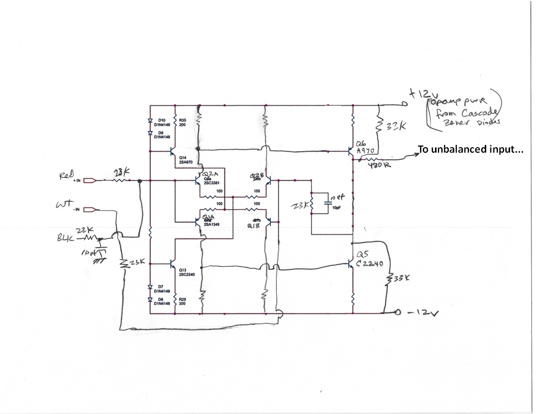

There is also a (perhaps optional) discrete balanced to unbalanced input circuit that precedes the circuitry shown on the schematic attached to the first post. Hand sketch of that circuit attached below

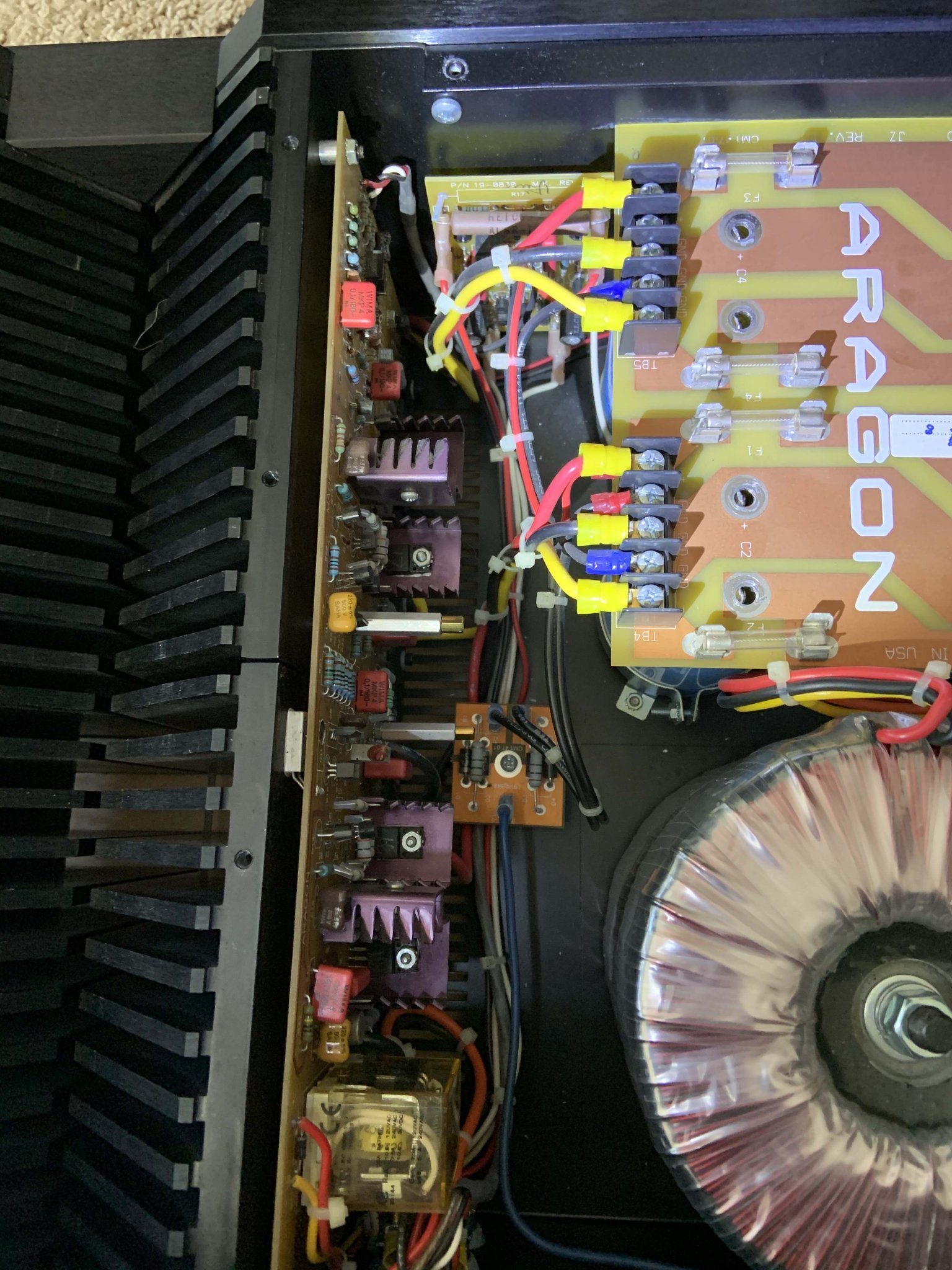

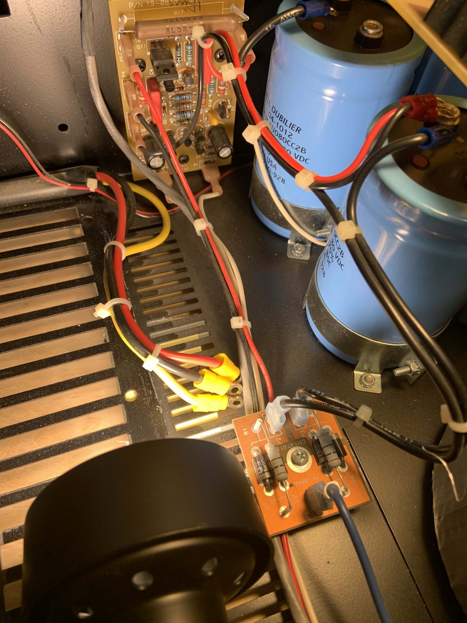

Some pics show components not shown on the schematics.
First pic shows one end of the rectifier and filter board.
2nd pic shows the other end of the same board with screws removed that connect the board to the filter caps underneath it. Also in the same pic are two power transformers stacked on top of each other, one for each channel. Also in the 2nd pic, a small white rectangle can be seen sitting sandwiched between one of the amplifier boards and the heatsink. It is a thermal switch in series with R121, although it is not shown on the schematic. The switch is to help protect the amplifier in the event of excessive heatsink temp.
3rd pic shows same area with the rectifier board lifted out of the way. In the top center area is a small PCB with the speaker protection circuit on it. It drives the relays on the two amplifier channel boards to disconnect the speakers in the even of a fault. Schematics for similar boards can probably be found searching around the forum or via google. Lower down on the same pic is a smaller PCB which IIRC is hum breaker circuit. Schematics for typical audio amplifier hum breakers can be found too. Also shown in the 3rd pic are some of the obsolete big filter caps. The wires and lugs sitting on top of some of the cap terminals actually are supposed to connect to the rectifier board that was pulled out of the way to take the pic. Normally the rectifier board is only thing screwed directly to the cap terminals.

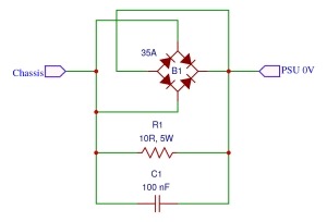

Thnx Mark. Can you show me the schematic of this hum breaker circuit? Is it sitting on the DC side of the power supply?
Its effectively about same as the schematic attached below, but without the capacitor. AC line ground connects to the chassis side; amplifier circuit ground connects to the other side of the hum breaker. The resistor value in some amplifiers may be a higher value, have seen 47-ohms or 100-ohms in some designs. The diodes and resistor should be able to handle enough surge current in case of a fault condition so as to allow other protection mechanisms time to act.

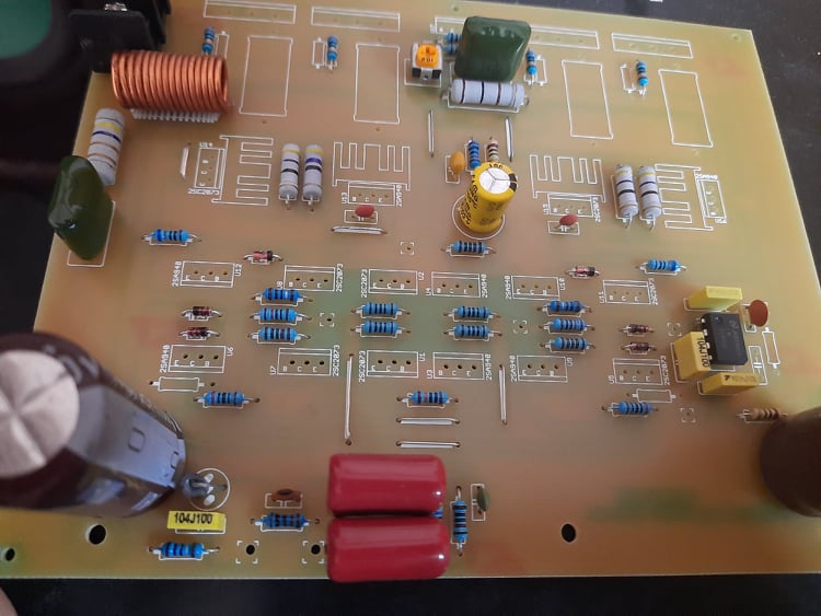

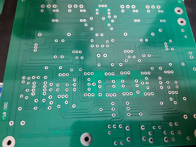

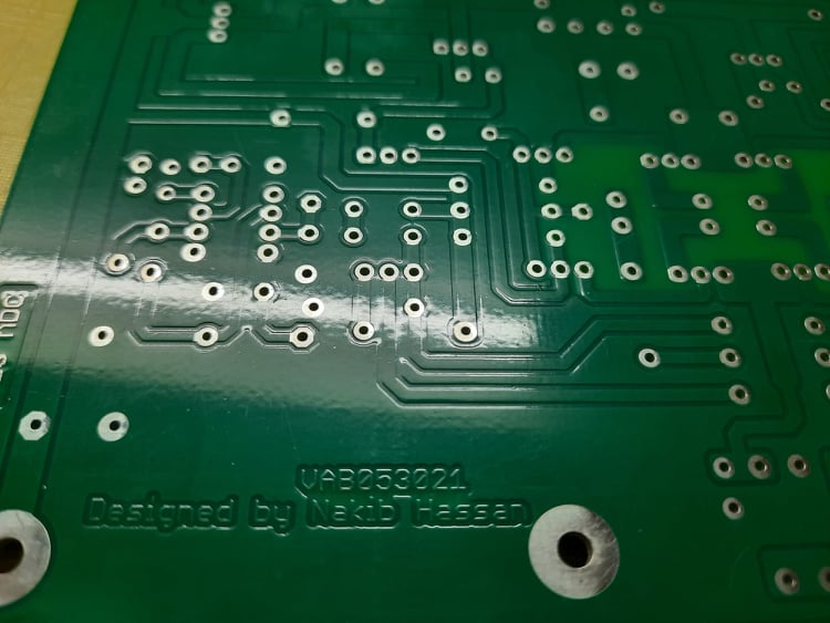

Here are some of the pics of my PCB. Working on it right now!!

The hum breaker is not related to input stage bias :scratch1:
Its just to reduce the tendency of the AC line safety ground to act as a path for noise incursion into the amplifier circuitry common (which might be thought of as sort of a semi-isolated 'ground').
The amplifier's de-balancing circuit on the input is also designed to help reduce ground coupled noise. In the case of unbalanced input connections, the incoming ground from any external preamp is not connected directly to the power amp chassis ground, rather it is processed as a differential signal.
EDIT: Regarding bias, the resistor values shown in the schematics are correct for the types of transistors used in the original amp (don't recall if there was a typo on any resistors). Different transistors may need some tweaking. Regarding output stage bias, IIRC output transistor emitter resistor drops when fully warmed up settle at about 34-35mV.
EDIT2: Just found a note the the current source emitter resistors for de-balancer input stage are actually 2.5k, not 200R as in the main amplifier input stage. Emitter resistors for Q5, Q6 are 10k. Not sure what the other unmarked resistor values are.
