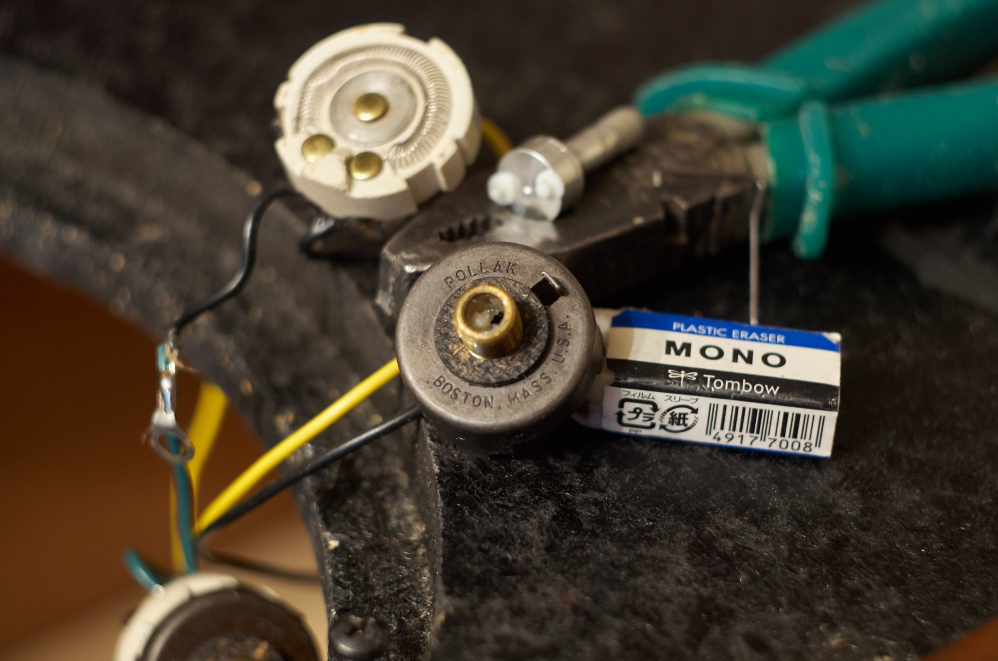

I have restored AR-2Ax, which are rather similar, several years ago. I don't remember if woofer surround were already replaced, everything else was mostly OK. But:

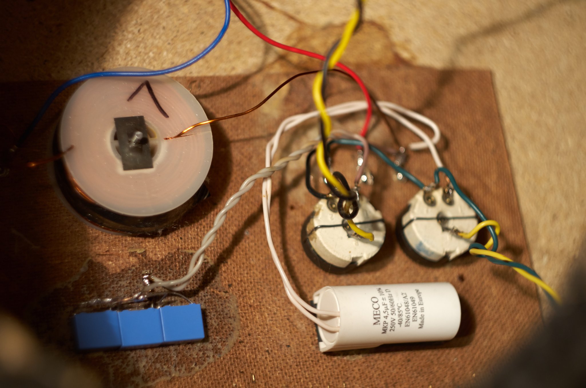

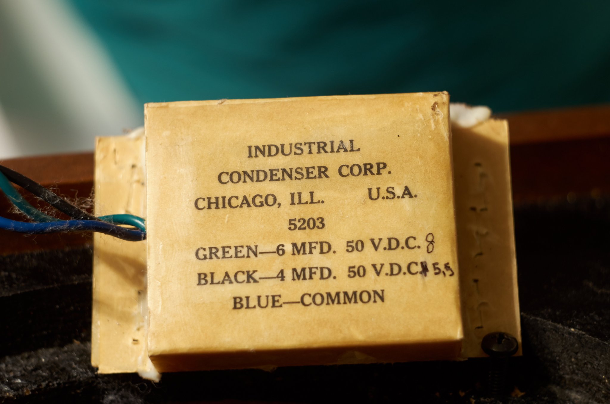

-dual capacitor deteriorated, 8 and 5.5 uF instead of 6 and 4. Replaced with MKP and PE caps.

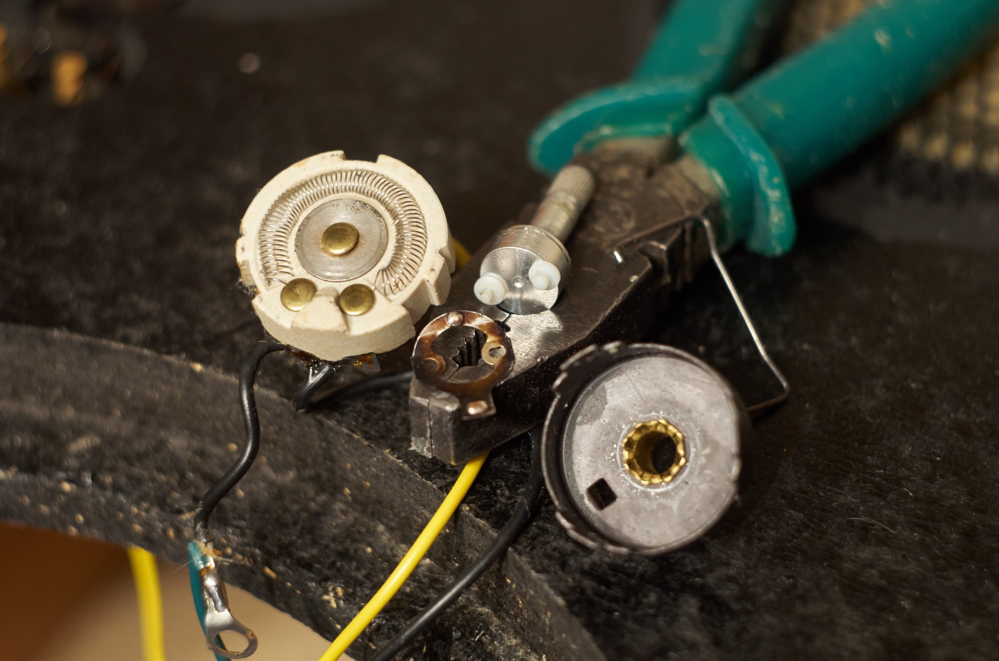

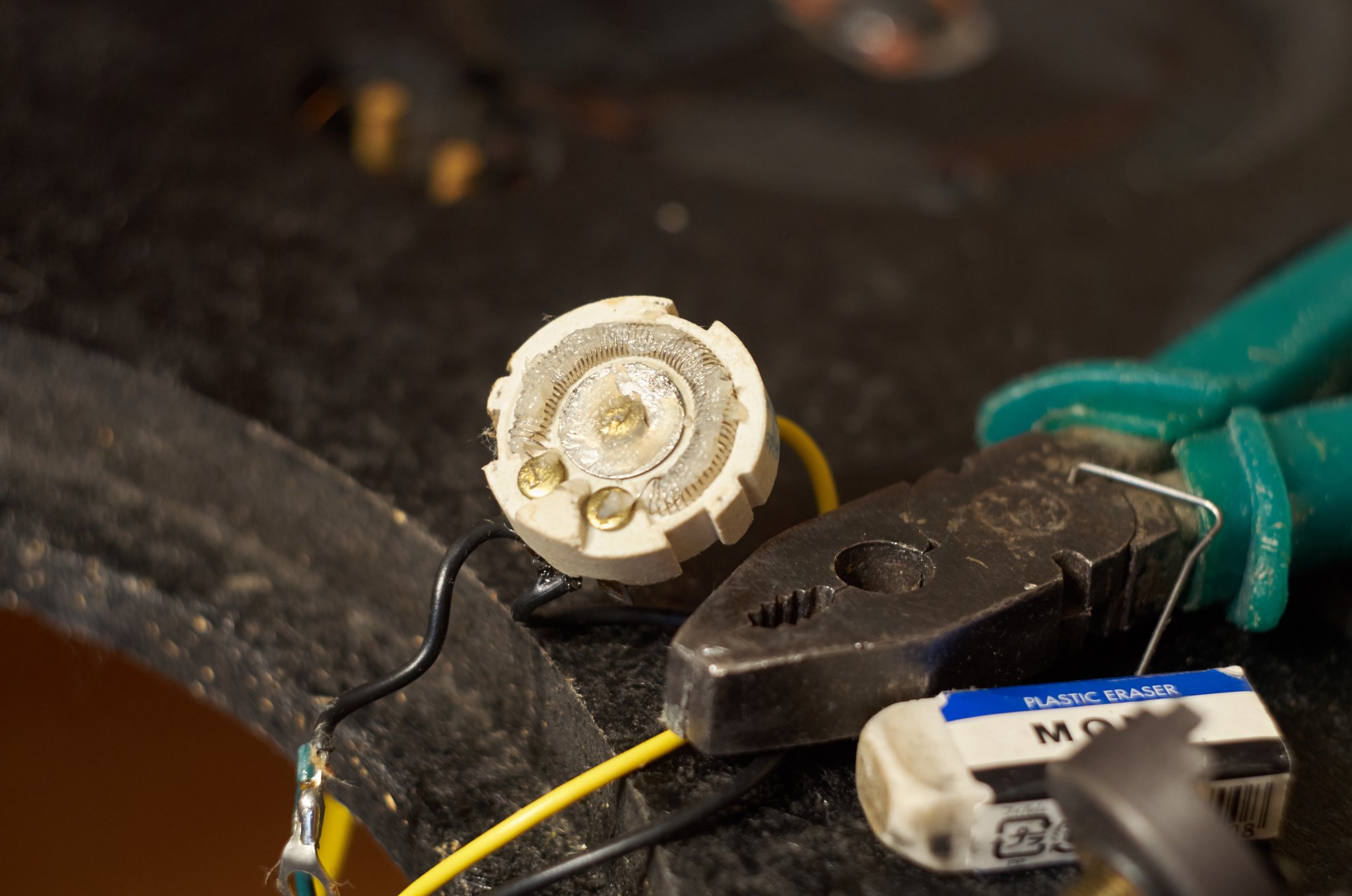

-attenuators slightly corroded. Cleaned and greased them.

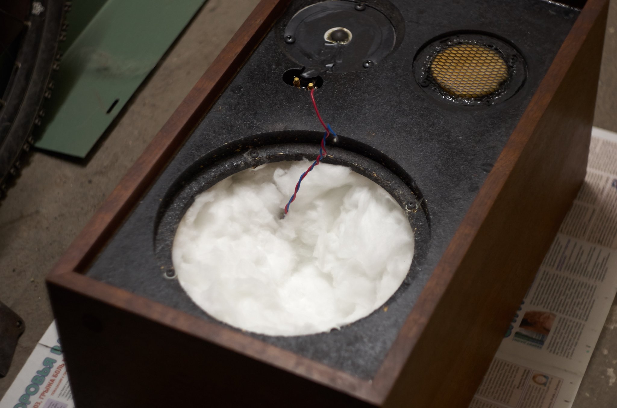

-cabinets need A LOT of stuffing. I had to literally stuff enclosure to the brim with heavy kaolin wool, otherwise one-note midbass was unbearable, 80 Hz at +10 dB. With enough damping material I was able to get woofers into +-2 dB in 65-600 Hz range.

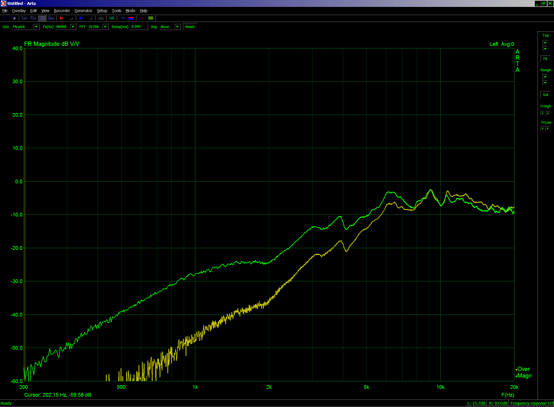

Here are driver frequency responses for reference. Yours should be similar:

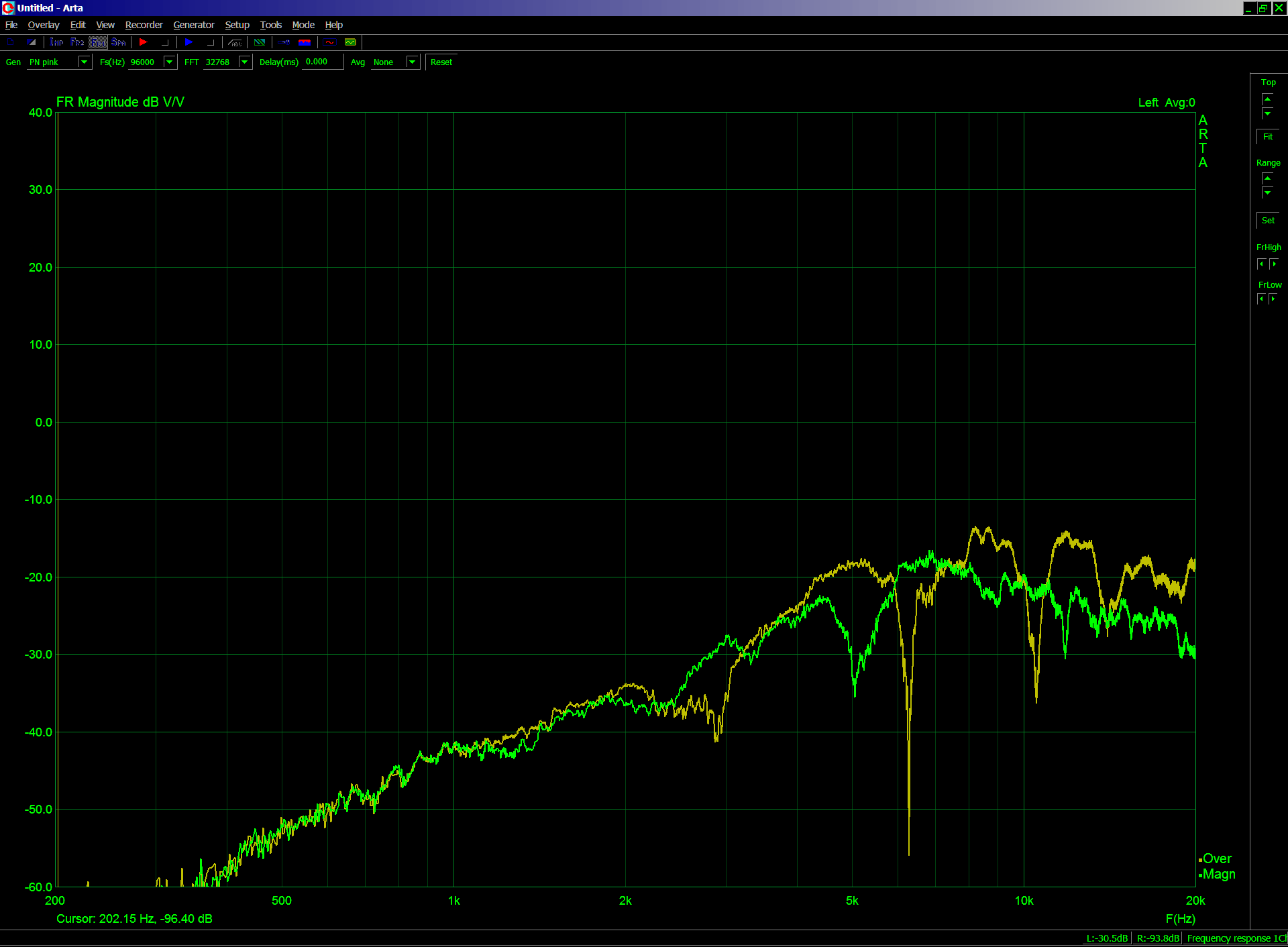

-tweeter nearfield (1 cm on axis) w/o crossover (green), through 4 uF cap (yellow):

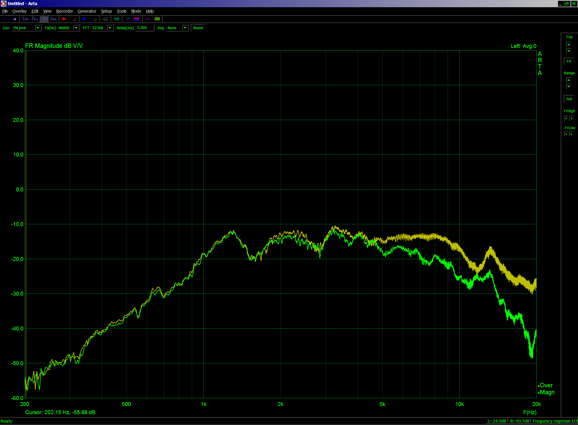

-same tweeter in cabinet on axis (yellow) and at 45 degrees off-axis (green). Lots of diffraction from raised baffle edge:

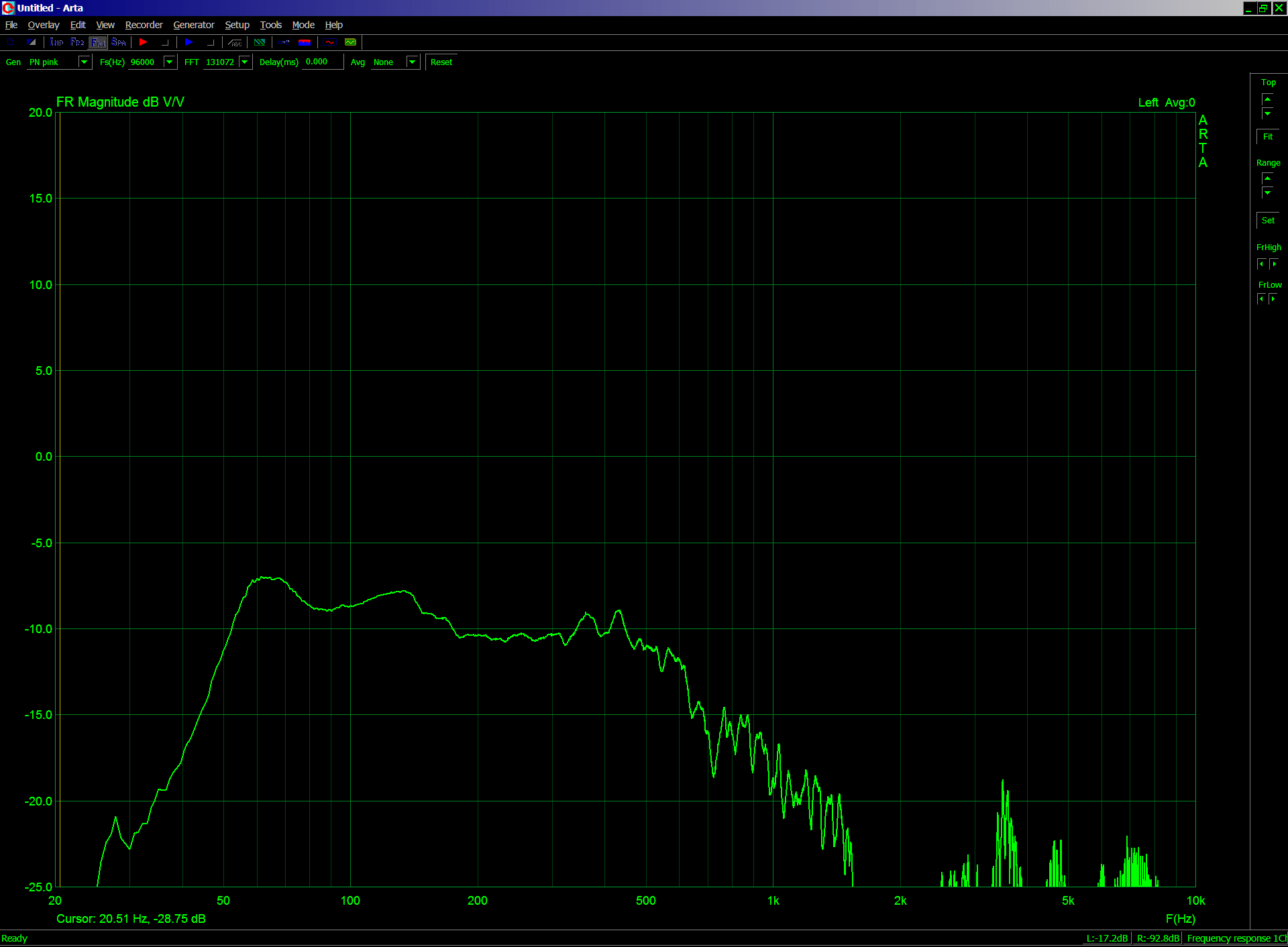

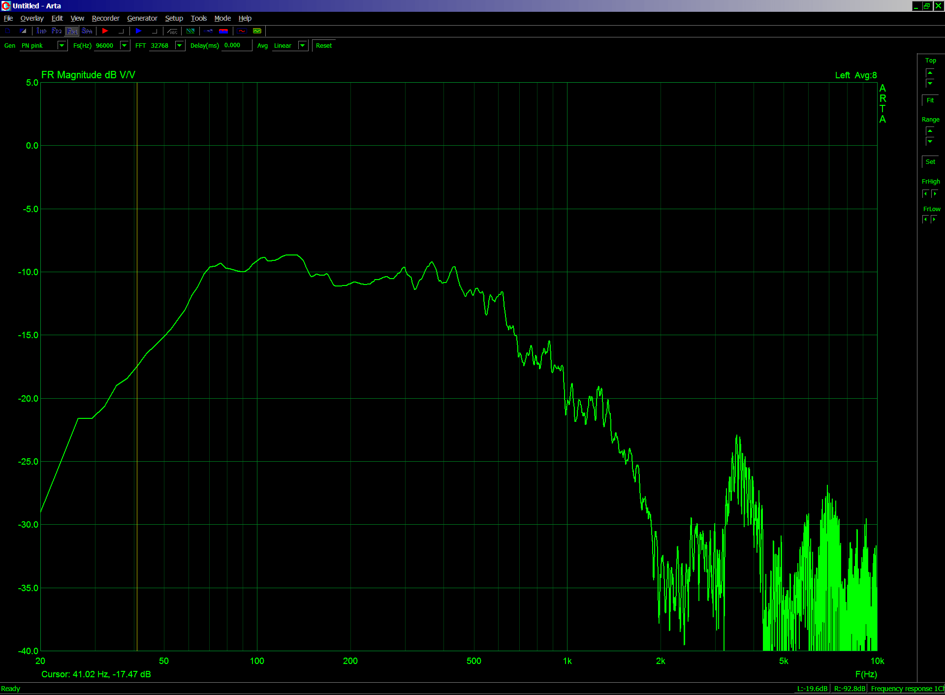

-two woofers overlaid, 35 and 31 Hz Fs, 1.6 and 1.35 Qts. Really weak motors. Nearfield measurement w/o enclosure:

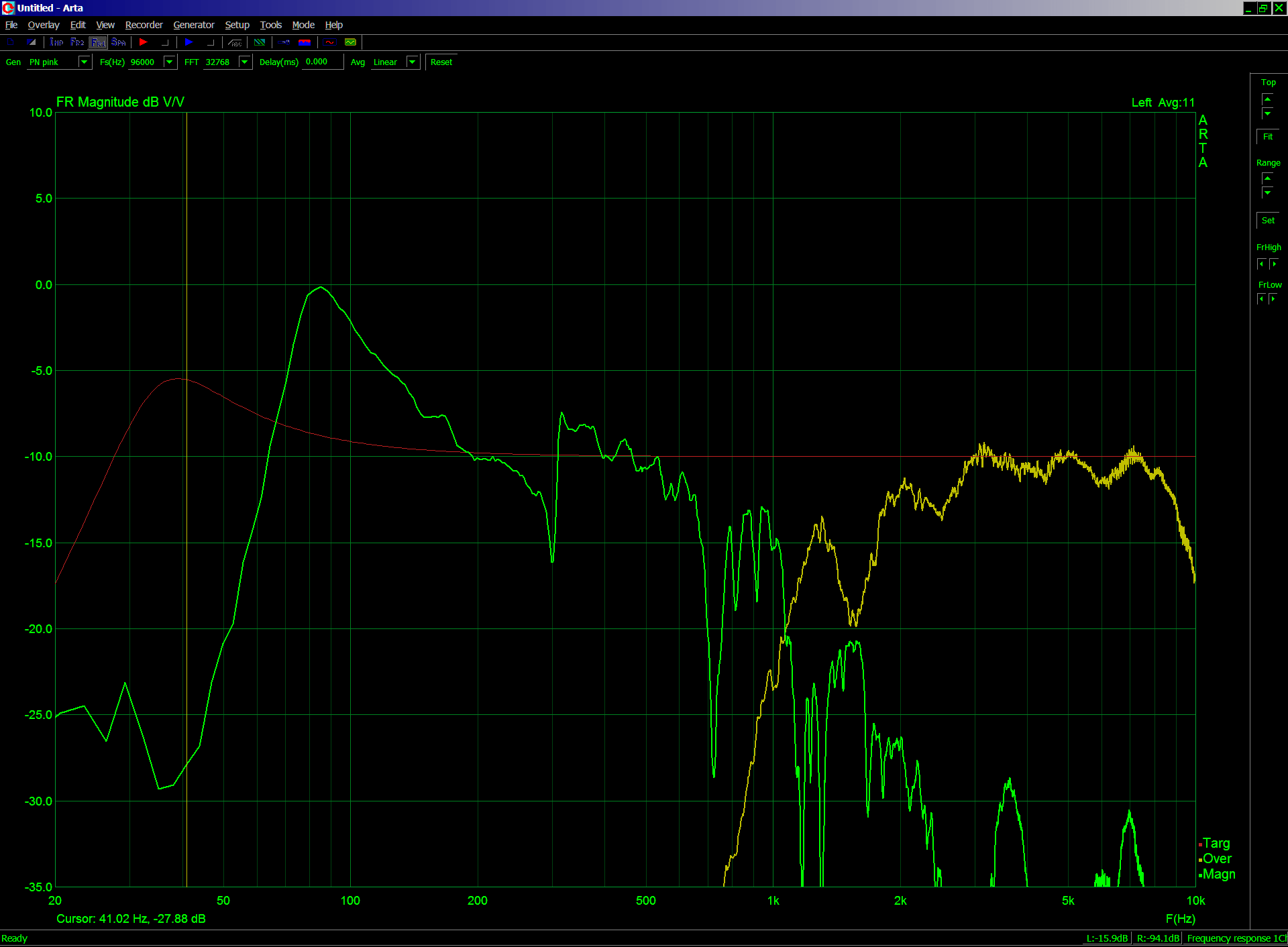

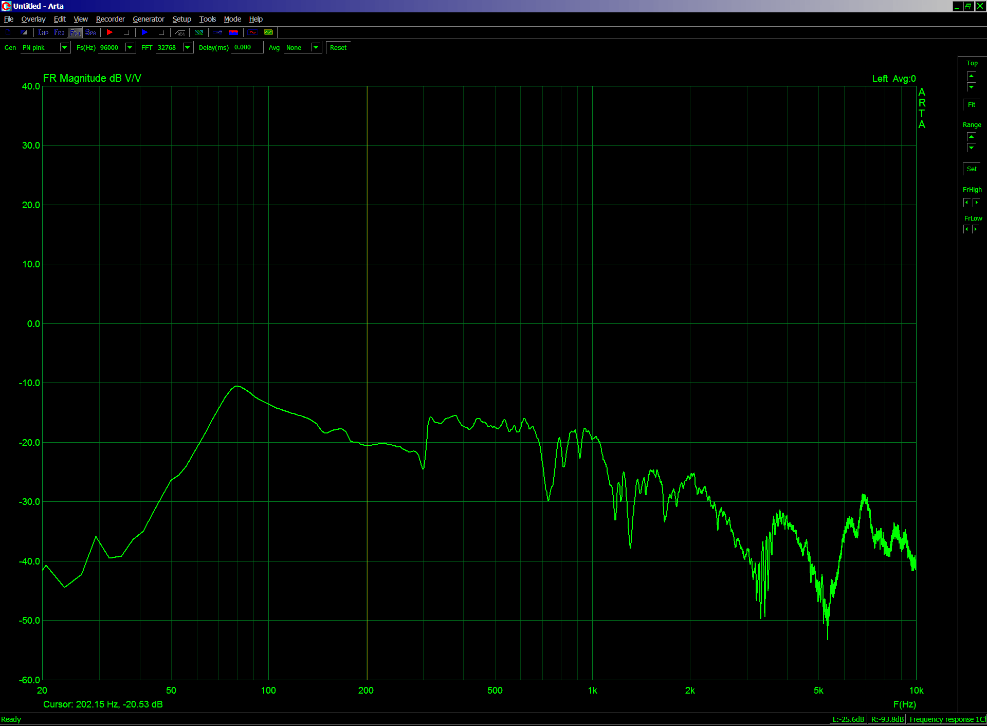

-woofer 1+midrange 1, in box, no stuffing, refurbished X-over:

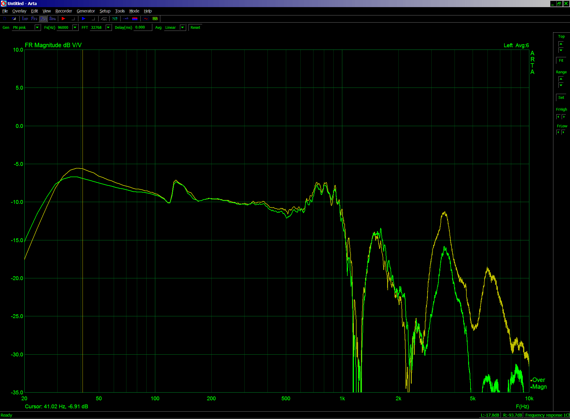

-midrange 1 FR at 0 and 45 degrees:

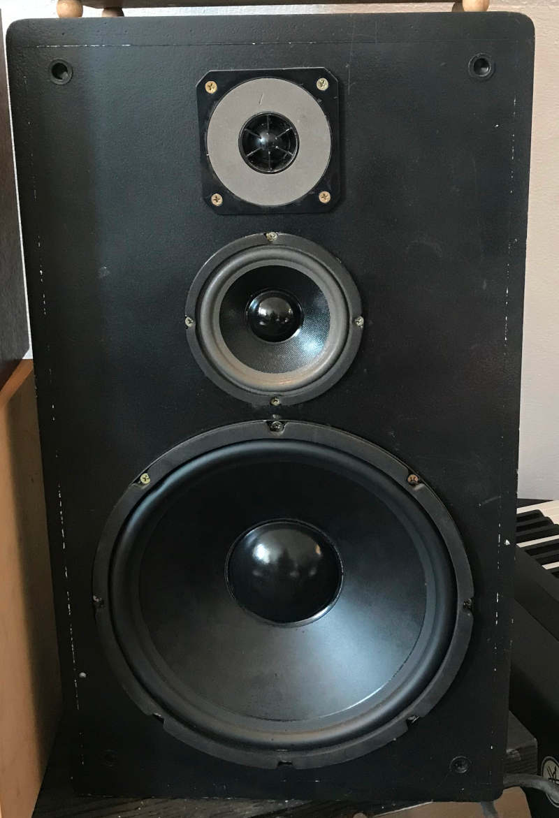

I guess it's more like a three way with a 12" woofer and no ports. I think it's based on the idea of acoustic suspension
That's what the company was based on, definitely no ports.

1. Do I need to super make sure that the drivers are sealed against / in the wood?
2. Should I stuff the cabinet with anything? Right now I have large blankets stuffed in there.
1. Just a regular foam gasket would do. It doesn’t have to be super-sealed and sniffed with helium leak detector.
2. Absolutely, unless you are a fan of one-note mid bass. Replace blankets with a lot of mineral wool.

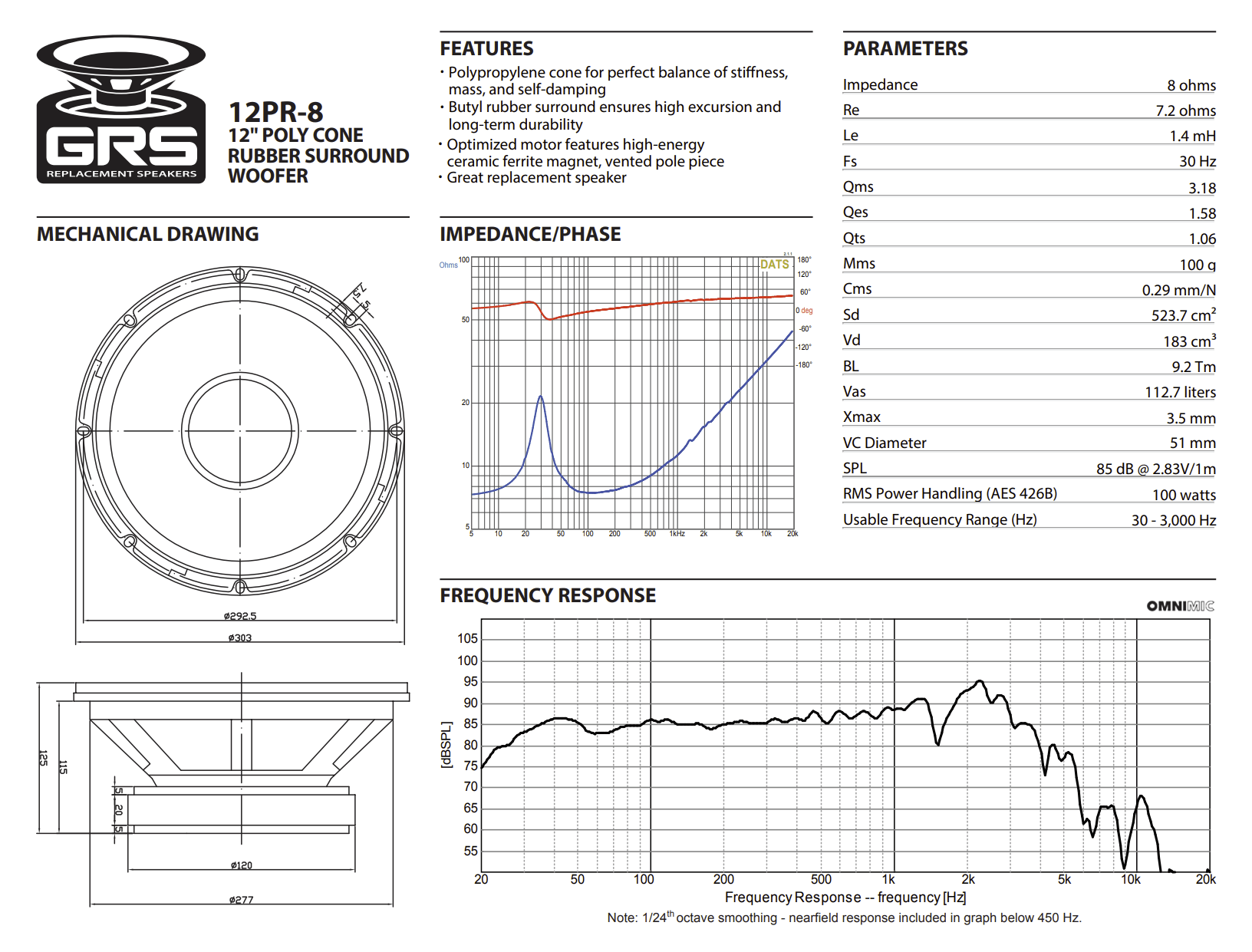

These are the woofers for sure GRS 12PR-8 that are currently in it.
There's pretty much nothing in that box close to an AR3. Except maybe the 3.
That woofer surely doesn't.something that works well with the cabinets
High Qts, weak motor, minimal Xmax. May be useful as a passive radiator, I guess.
