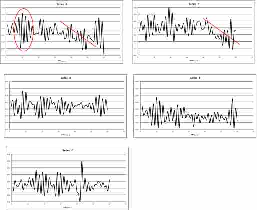

Happy to concede the 27 per minute, 0.3% swings are at least in part an eccentricity.
Looks to me like, that which appears to be amplitude modulation at a sub-harmonic of about 4-1/2 per minute, may be a measurement/sampling artifact. There's a very strong positive correlation between the amplitude minima, and the four instances per frame where 3 dots are needed to represent one full cycle of the higher frequency.

Rick PA Stadel, yes, I am convinced after much reading, that the 27 per minute oscillations are a function of record eccentricities. I did not put it in the table, but for the T/Ts listed the major oscillations were 33, 33, 36, 32, and 28, reading left to right. I was hoping that a math wizard was following this thread, and could shed some light on the sampling aspects of these observations.
BTW, correcting an error in the first post to this thread, the model designation for this T/T is not XE, but “AR The Turntable.” It says so right on the cover of the instillation manual!
Cheers
Mark Tillotson, I had already collected the data, but it did not seem to contribute any useful information about the variability in speed, or equally likely, my understanding of FFT analysis is just too shallow to draw any conclusions. So, the first attachment is a wide bandwidth spectrum of both the left and right channels. The second attachment is a narrow bandwidth spectrum of only the left channel. The right channel looks identical. These data were collected using a QuantAsylum QA401 Audio Analyzer. The RIAA preamp was a Sutherland KC VIBE.
I would appreciate anyone’s analysis of this data.

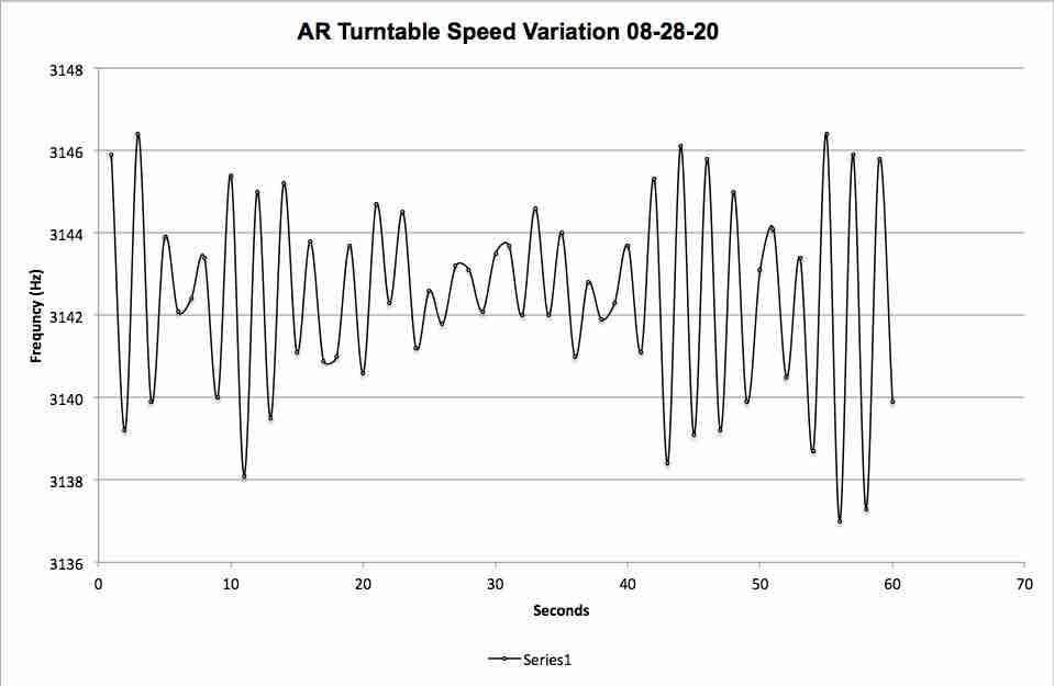

A few final thoughts for this thread.
When I took the machine out of storage and cleaned it up, I refreshed the bearing oil with what I have used since I did the Merrill mods a few decades ago, i.e., the black Merrill bearing oil, I still had some left over. In the process of this refurbishment, I re-read the Instillation Manual for the AR turntable, where it calls for using “Number 10 machine oil” for the main T/T bearing. Over a number of days, I searched the Internet for a description or specification for No. 10 machine oil, and the best I could come up with was “light machine oil”, or “sewing machine oil.” So, I settled on using Singer sewing machine oil. I could have used one of the bearing oils sold for T/T use, but again, no specifications are given, so I had no idea how they compare to No. 10 machine oil.
I thoroughly cleaned the spindle and bearing well of old oil. Then I used just six drops of Singer oil in the well and a drop on the spindle. I ran the T/T for about 2 hours to let it settle in, and checked the speed. The variation in speed did not seem to be any different from when using the Merrill oil.
It is very difficult just looking at the speed variation to make a judgment if one pattern is better or worse than any other. I found some reviews of T/Ts where the speed deviations were as erratic as my old AR exhibited. Some were very inexpensive while others were considered high-end and were very expensive. As one reviewer (Micheal Fremer) said, “The speed-stability graph isn’t exactly pretty, but, as is often the case with such measurements, the turntable sounded far better than the graph indicated.”

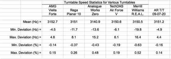

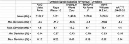

ceulrich
your tests
Thanks for the test results Ceulrich

Dennis h, interesting information. I do not have the tools necessary to make any comparison measurements on my table. Do you think the bearing well was designed with that taper? I would be interested to learn of your results, particularly with grease.
As an after thought: Over the past few weeks I have made dozens of measurements as I tweeked, and they all looked different from one another, and all looked terrible. Out of curiosity, I calculated the standard deviation (SD) of the 60 values available for each measurement. The SDs ranged from 1.96 to 2.69. So, the speed variation is only on the order of 2-3Hz.
