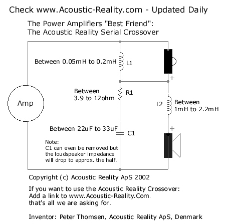

series X-over
C1 looks too big to have any useful cut-off for the tweeter; must be for a Zobel on the woofer? (but this would normally be connected to the other end of L2)

howdy,
i am currently using two versions of this x-over. one is a 2.5 way and the other is a two way, with no cap. i really like the sound, although, i wish i could add the cap back in the 2-way, it is a little straining on my tweets. but the 2.5 app is really nice, very full and smooth sounding with great impact. i replaced a high quality parallel 2.5 x-over with the series, it seems to "behave" a little better, seems to give a smoother sound without comprimising detail.
just my 2-cents worth

C1 has to do with limiting power to resistor and also making load a bit easier to drive.
