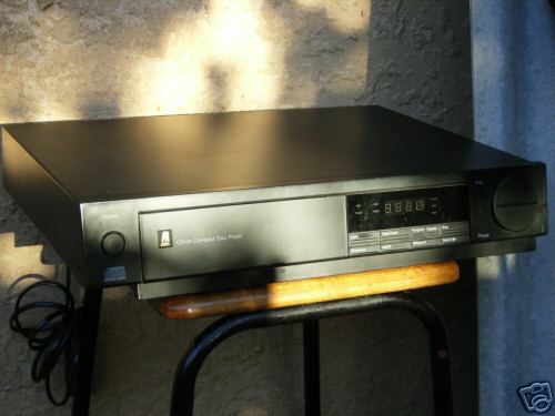

Hi
I've just bought an AR CD-04 on eBay - waiting for it to arrive.
Found the following description - seems interesting, especially if it is well build:
So - it has CDM2 and 2 x TDA1540. Did you do anything to yours yet?
Regards
Fin
When AR introduced the "Black Line" in the mid 80's it had one CD player in the lineup in the form of the CD-04, it featured the Philips 14bit 4x oversampling converters rather than a 16 bit one since the engineers at the company thought they sounded better than the 16 bit ones available at the time (and they were probably right, but this was an unusual design choice). The unit also had a separate converter for each channel but at the time many of the designs out there (in particular the 14bit models) multiplexed the converter leading to a tiny phase error, otherwise the CD-04 was pretty much run of the mill and was at it's best used in conjunction with other AR Black line components since it had a remote control link. Introduced the CD-06 in late 1988, it was made at their UK plant and featured the then new 4x 16bit oversampling hardware from Philips, interestingly the unit had a remote control of output level so it could be used to drive a power amp directly, fit and finish was also considerably better than with previous CD players from the company.

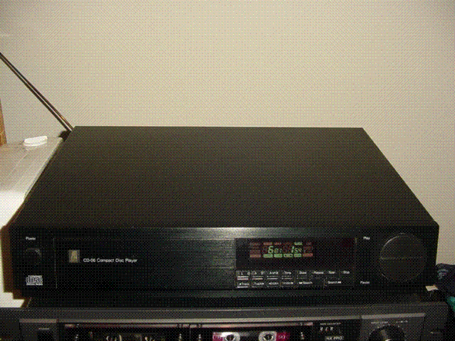

I just picked up a used AR CD 06 in clean and nice condition. It was advertised as Audiophile Quality and I was immediately impressed with the sound as soon as I played it. Warm, and rich with very good sound stage. This particular unit was manufactured in March 1991 and it has not misread a cd yet; even at high volumes with lots of bass shaking. I pulled the cover and revealed a cdm2/10 transport, quite solid, and one TDA 1541 A chip. The unit plays hot (literally) and is a 16 bit with 4x oversampling. The only drawbacks I have found are small, unlit function buttons and a small display. Very happy with the player.
Acoustic Research Cd 06
The CD 06 is similar to the CD 04 with some different internal parts and
more function buttons. In fact, from pictures I have seen it looks like all the AR Black Line components shared the same chassis. There is a nice article about the 1540 and 1541 chip on lampizator.eu. Sometimes the vintage components really sound better. If I ever pull the cover again I will be sure to post a photo of the internals. Wooffer
