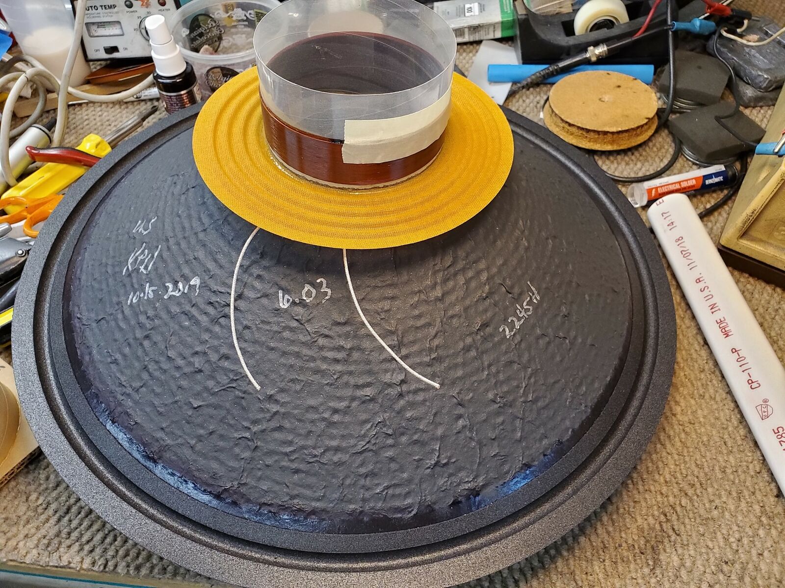

I don't know where other than eBay to get the aquaplas but here is a picture of it applied on a recon for a JBL 2245h

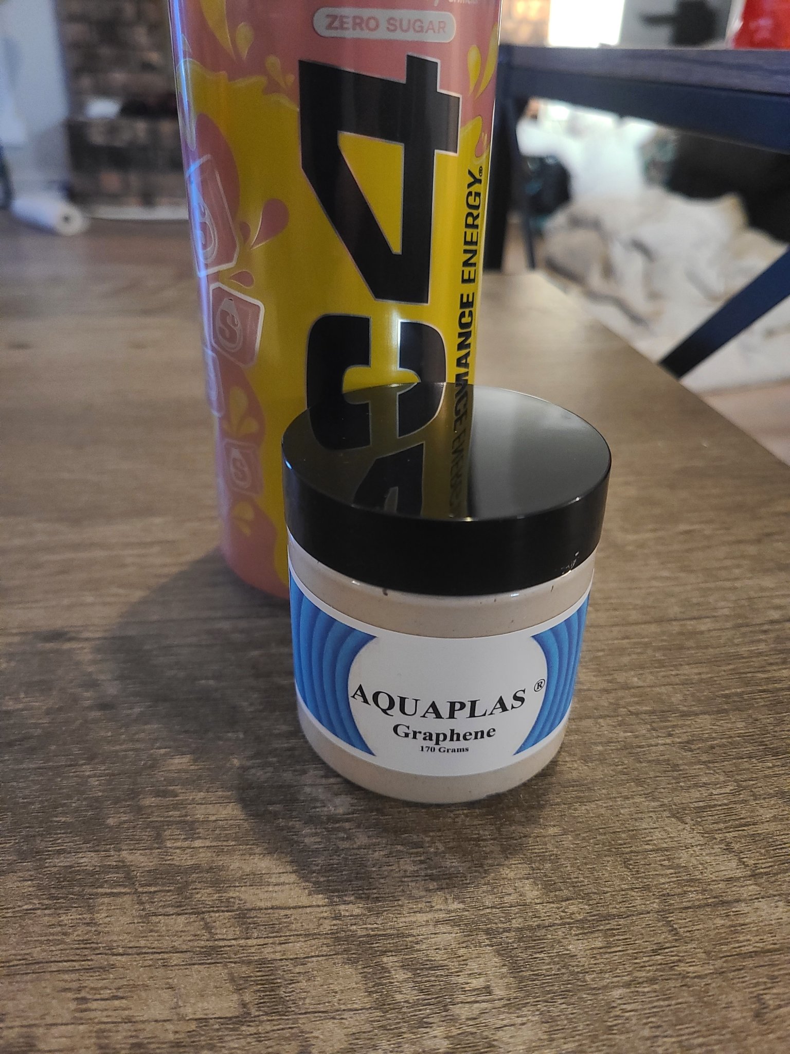

Pictures when you get it, and what it smells like.Interesting that grapene has been added. Real amounts, or just enuff foe the marketing department?
dave

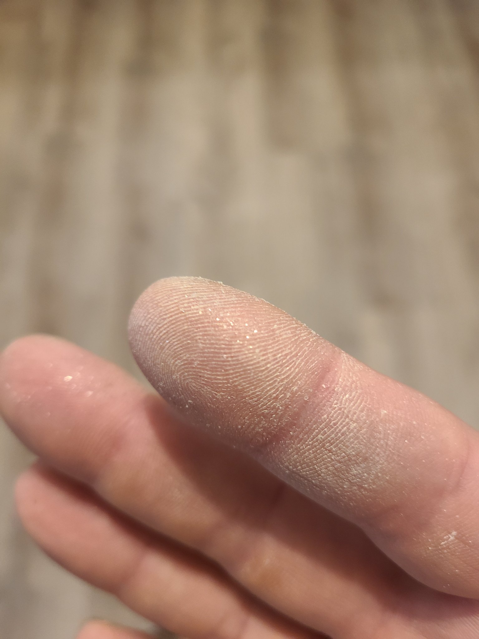

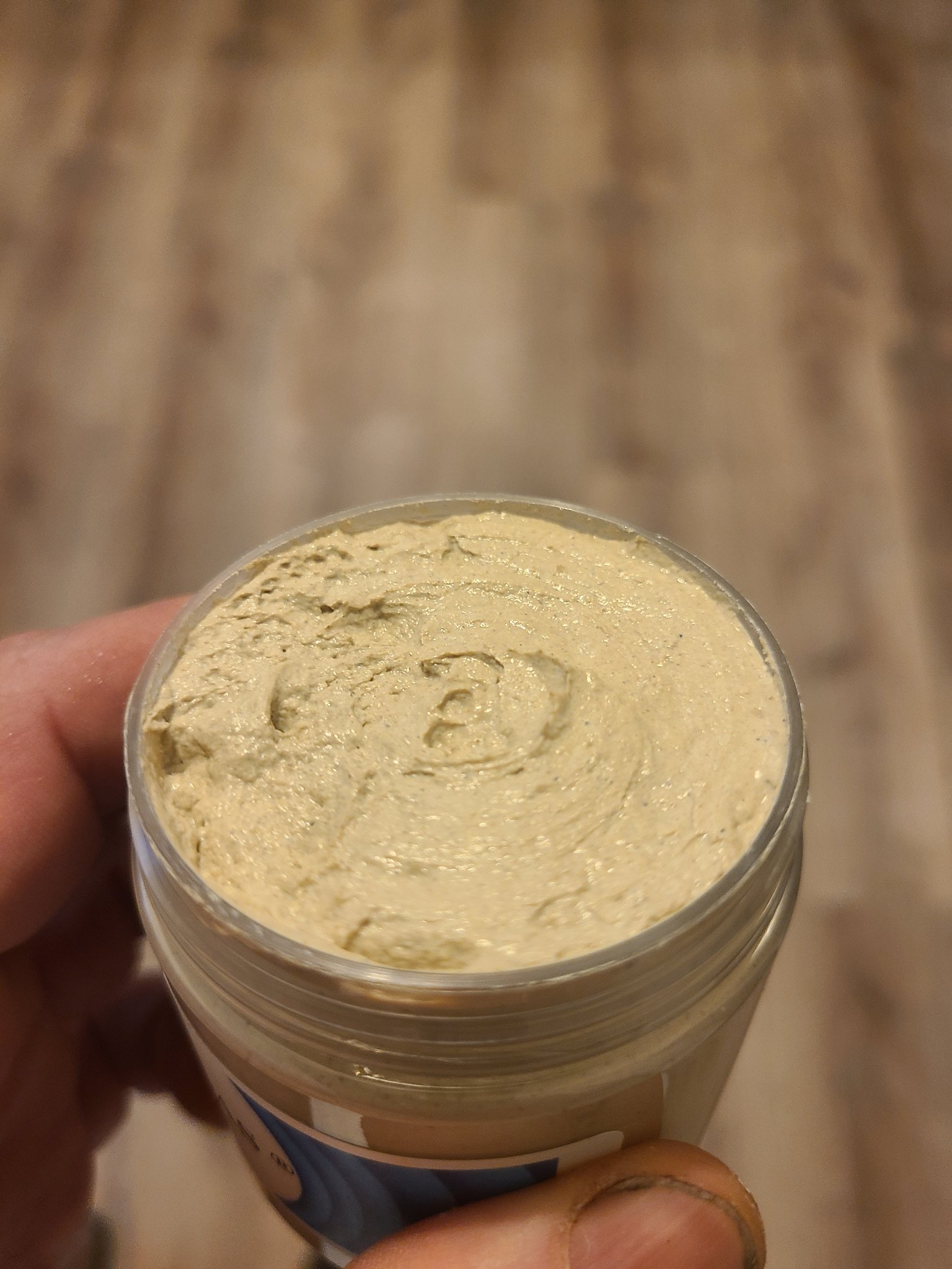

I messaged the seller on ebay and they said to thin it with water, spray appliction. I will be dappeling it on with a small round paintbrush. They said to clean any oil or contaminents from the area. They didnt say with what. I was thinking of trying isopropyl alcohol. Cover the dome and surround evenly. Only add 1-2 grams of dried aquaplas. I might try less since this may be an amount suggested for larger diaphragms. Hopefully this lowers distortion. Right now my compression drivers are around -42db thd above 3k. As far as full range drivers go i was curious of opinions. My markaudios break up alot at high volume and i thought maybe i could increase spl if i added this.
This small jar is 170g. It smells like latex paint. The texture is like a whipped butter. Rubbing it dry between my fingers reveals small transparent but reflective flakes. Im guessing its mica but idk.
Also, Since im applying with a brush i think i wont dilute it. Maybe ill practice on this c4 can.
