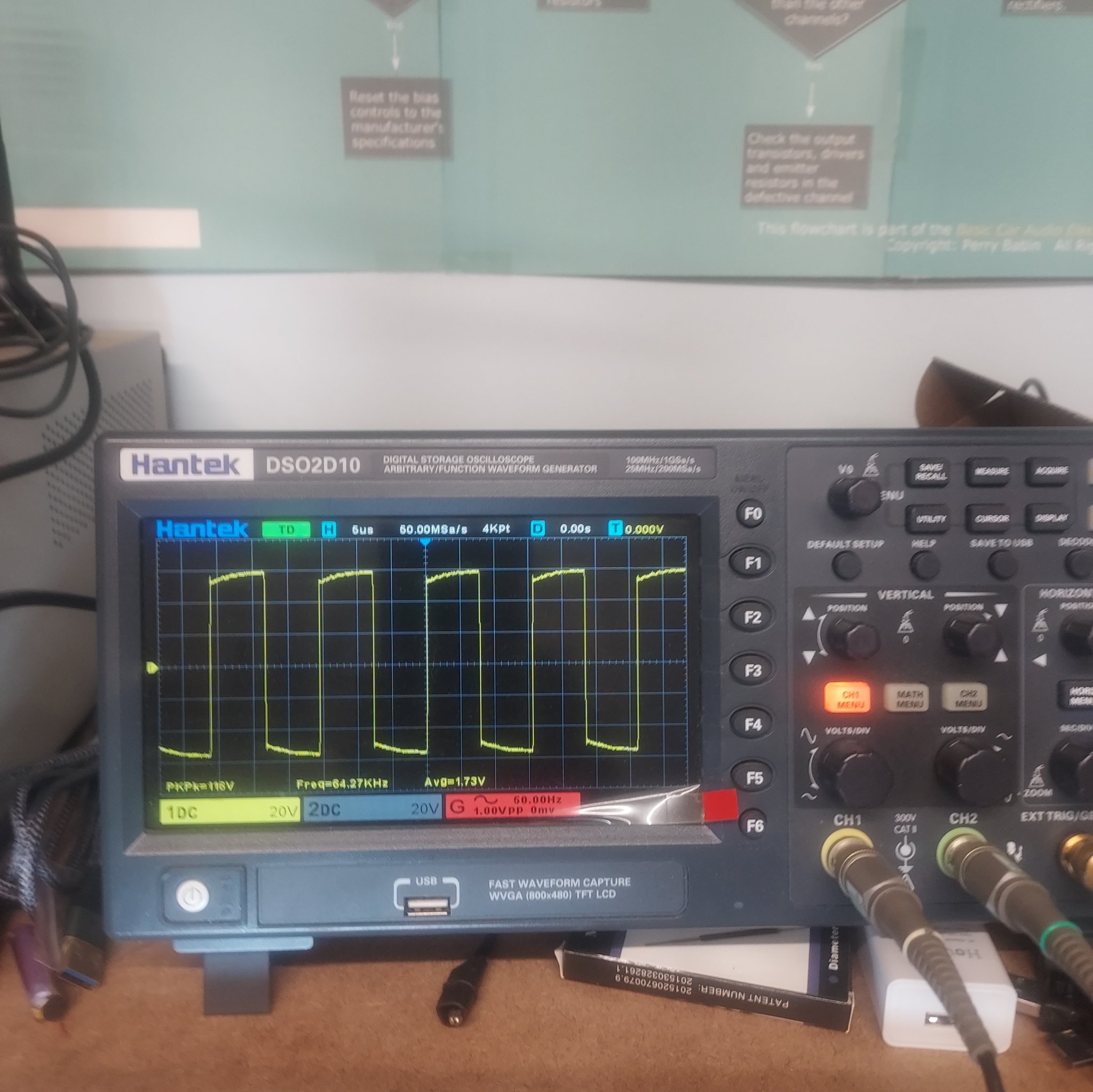

What is the best course of action when everything seems fine but there is no audio output?
All drive signals on the outputs look good.
All power supplies are there.
Relay kicks on and amplifier shows a green light.
The only real strange thing I see is there is "ringing" on the signal at the top of R33 on the output card.

Do you have any modulation of the drive signal when you see audio on C120?
Near 0v is good on pin 11. In the future, please use a leading zero to the left of the decimal.
Anywhere that you have the 60K square wave, from the output of the driver board to the output FETs.
If you have modulation, you should have audio at the output.

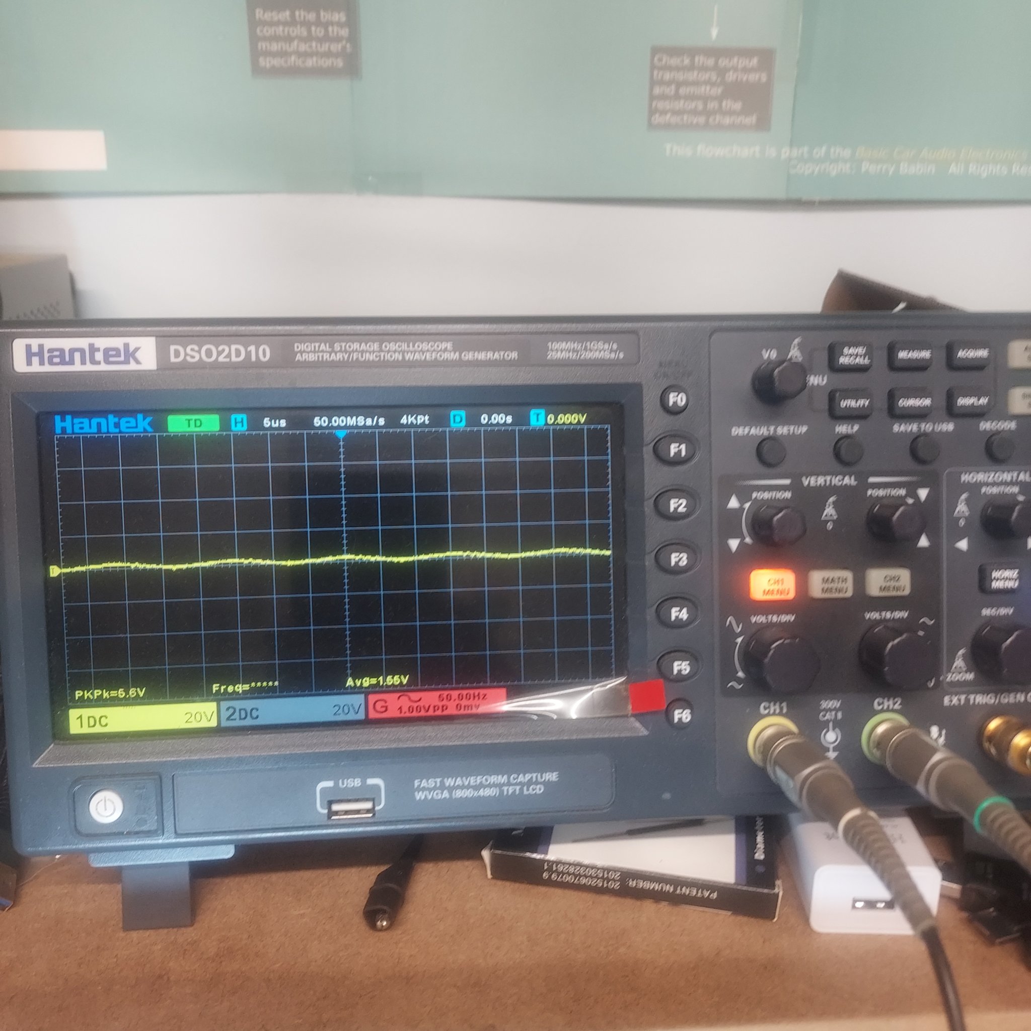

I have signal @ L203, but not at L205.

The signal is not making its way through L203.
Could there be a short in the inductor?
I checked the functioning of the relay. It is fine.
There won't be much high-frequency signal beyond L203.
If driving a signal into the amp producing significant modulation, you will see a rail-rail square wave on the FET side of L203 and audio (with a tiny residual high frequency noise) on the other terminal of L203.
