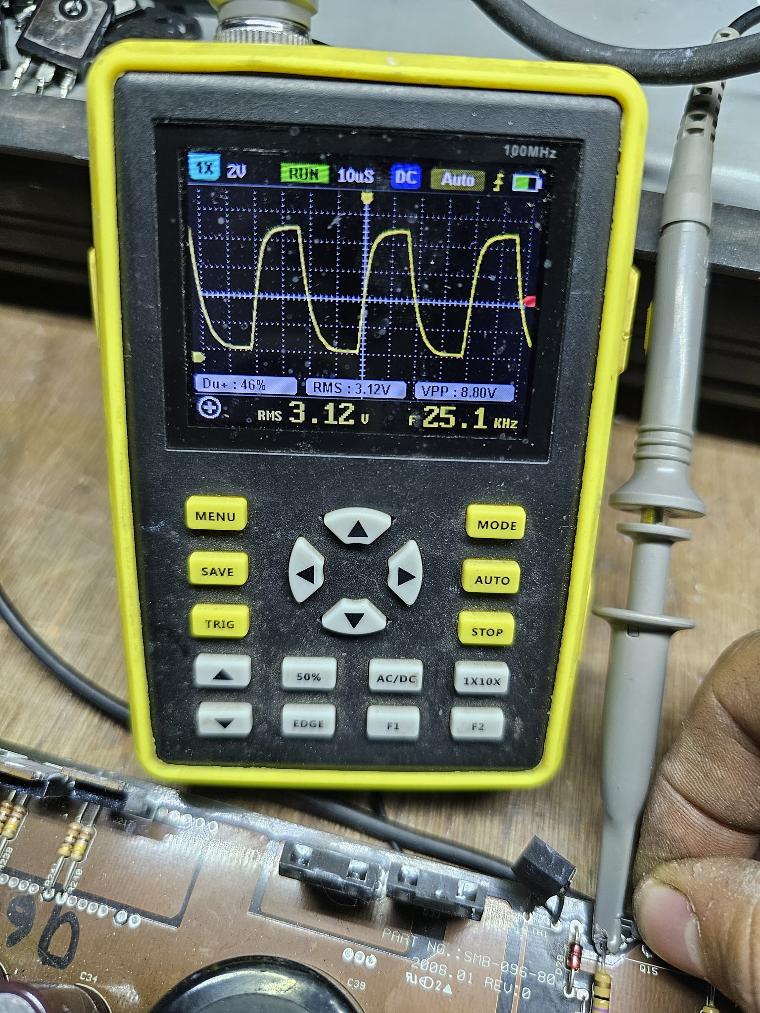

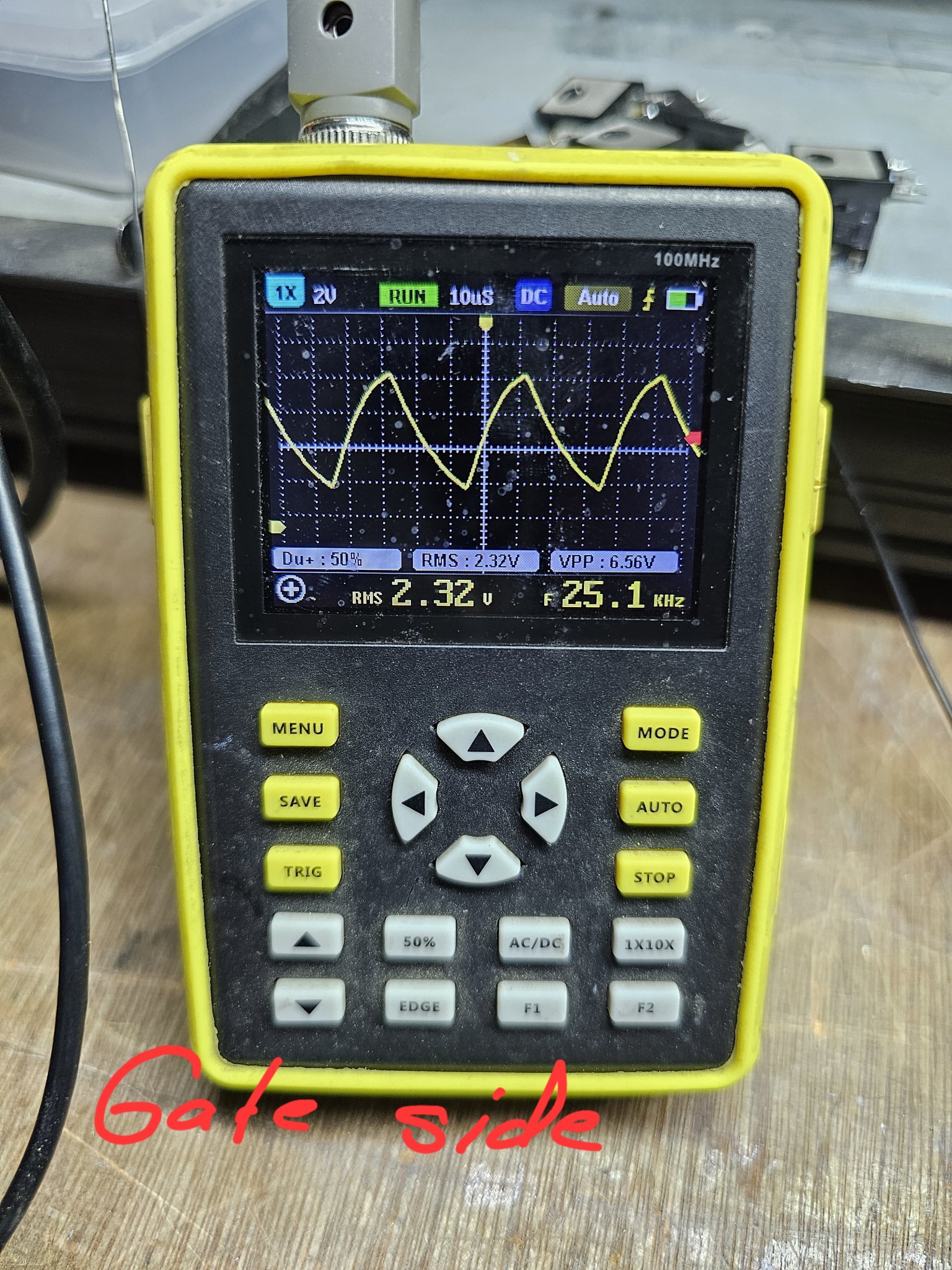

Initially I felt that the Q11 and Q13 fets heated up just a little faster and after about 3 seconds they all heated up equally. I have limited the source to 2.5 amps and with a bulb in series in B+ it turns on, I'm going to do the test with the capacitor. In the output stage I manage to have audio without problems

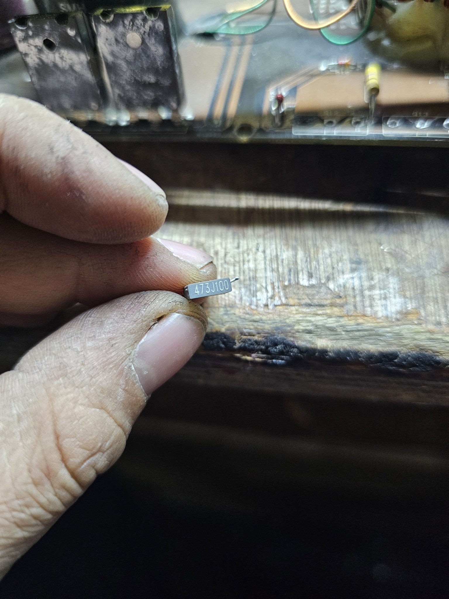

This is what I see with a 47nf capacitor
