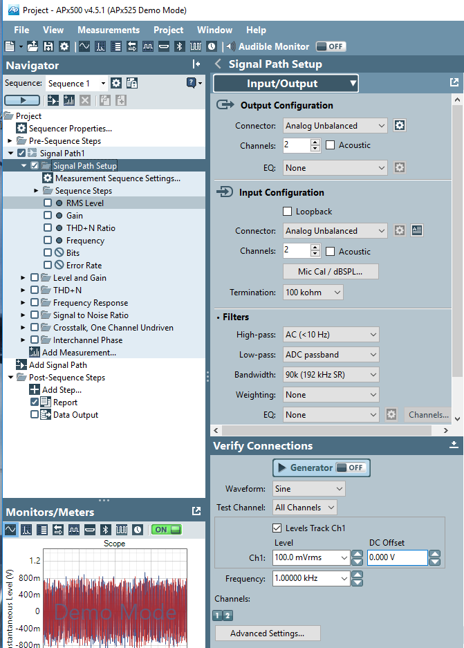

If you search at the AP website, there are many app notes and tech notes where they explain test protocols.
Probably the best way to start is to read up in the manual about the difference between 'Bench mode' and 'Test mode'. In Test mode, selecting the test like Distortion in the 'explorer' type list on the left, will automatically set up the hardware for such a test, and you can then set generator levels, output and input impedance levels, frequency range etc. In Bench mode you can manipulate the hardware at its basic level and you probably don't want to start with that.
This is very high performance software and it is impossible to just start to use it, it will take time. But note that you can play with the software even if you don't have the equipment, using it in demo mode.
Have fun,
Jan
Correction: not Test mode but 'Sequence mode'. Selected at the top right. Then on the left you select the test you want to run.

The APx-515 only has bench mode if you spent an extra 40% on software options. (You can practically buy an AverLAB analyzer for the same amount as Bench Mode will set you back).
AP does have a youtube channel with a bunch of short videos that can help get you started quickly.
Assuming you are in sequence mode, just click the Add Measurements button and you can see all the different types of measurements available. The Stepped Frequency Response gives you H2 & H3 responses as well as THD+N if I recall correctly.

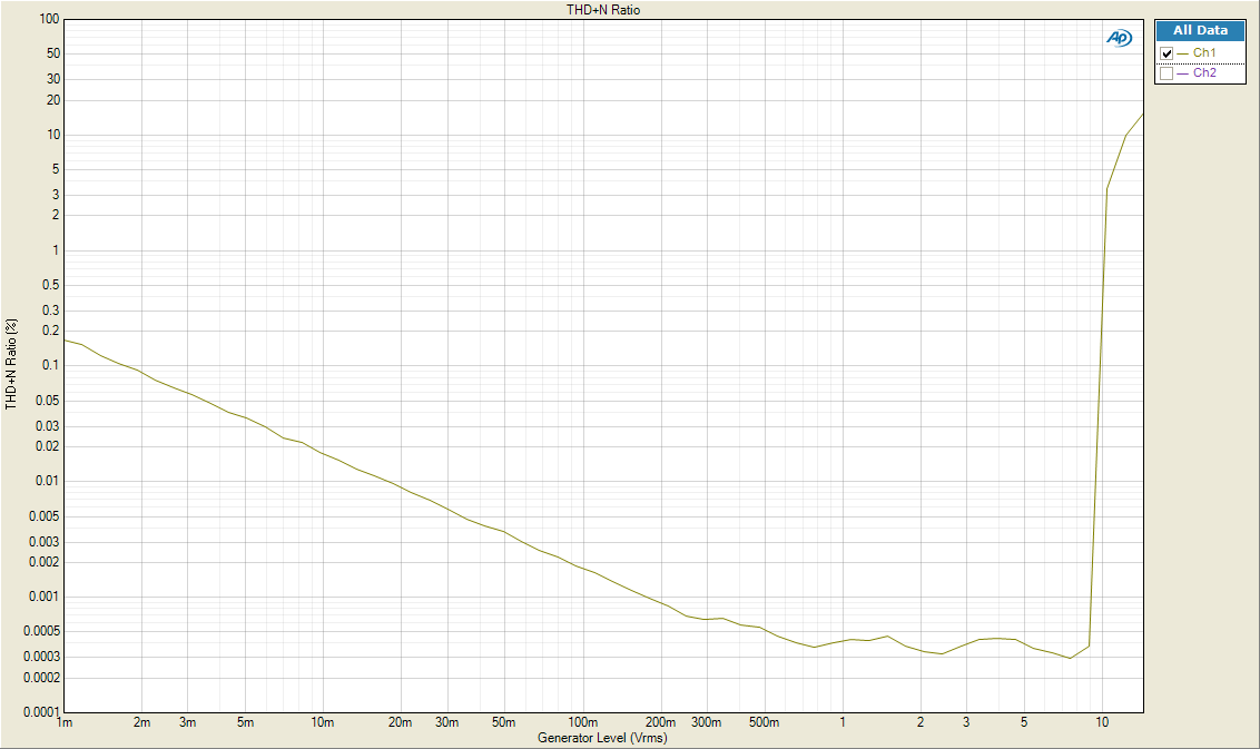

Maybe I am to blind to see after flipping through the youtube channel YouTube
, but my wish is to generate a graph like
http://www.diyaudio.com/forums/atta...adphone-amplifier-pcbs-thd-vs-output-900r-png
This is varying the actual values of THD over the generating level.
Basically a for-loop over different input levels.
Then the sequence is ideally graphing the output (=THD over generating level).

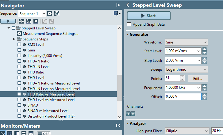

Solution to THD Vs. Generator Level
Hi there,
I finally got it myself.
This measurement is under "Level Sweep".
One can load (add) it as a measurement and then add as a step (=part of a sequence).
attachment.php
Thanks to all!
