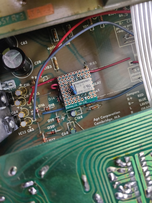

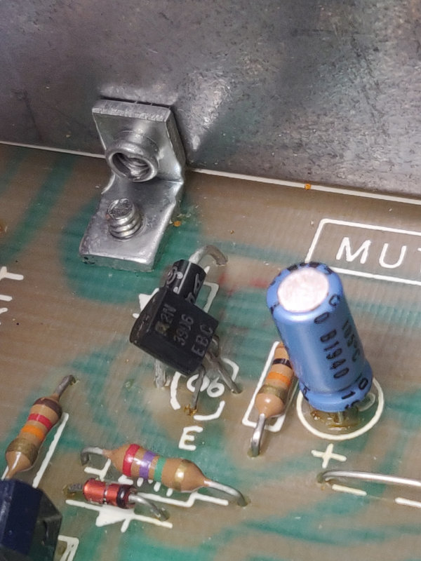

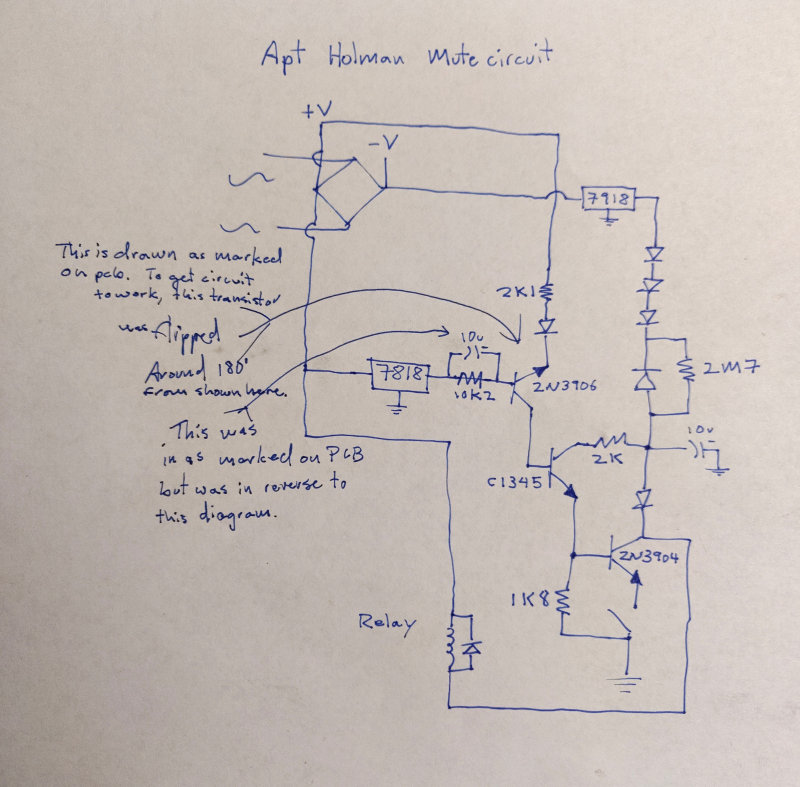

It worked for a little while, and after a recap, I was getting relay buzzing. I removed the relay to inspect, and the plastic base crumbled when I pulled it out (maybe I was a little too forceful). I only had 12v low signal relays on hand from a spare pcb out of a Rotel reciever. So I put the new relay on some perf board and wired a 750 ohm resistor in series with the relay coil. I also inspected the mute circuit and found that the circuit in mine varied significantly from the schematic in the service manual, and on the base of the case. I drew up the circuit following traces and measuring resistances. It appeared that one of the capacitors, (no cnumber marking) was in backwards according to my schematic, despite the cap being inserted per the polarity markings on the actual PCB. So I flipped it around, and still, the relay buzzed. So looked at the schematic I drew up again, and decided to flip around one of the transistors, so it went against the markings on the pcb... Board was marked with an E where the emitter of the transistor was, so I rotated it 180 degrees, and bingo, that did the trick. Now the muting circuit worked perfectly. 4-5 second delay on power up, then click. Instantaneous click on mute button press and depress, and instant disconnect at power down. Measurements show the relay and resistor dropping 19.2v, and drawing 11ma. This puts my relay voltage drop at 10.9v, and the resistor at 8.3v.

I have attached my drawing of the mute circuit on my unit, as well as a couple pics of the mute circuit. The cap and transistor in the 4th pic both needed to be flipped around to get it working.

So are you saying that the preamp was manufactured with those two parts inserted electrically backwards,
(with the board marked wrongly), and the mute circuit thus being nonfunctional? Is this an early production
unti, or were they all like this?
No, not saying that, but it wasn't working properly when I got it, and now it seems to work beautifully. It did certainly appear that the capacitor in the picture was labeled incorrectly. I'm not an electrical engineer, just a hobbyist, but the changes I made, made sense to me based on looking at the circuit I had drawn out. I completed the relay circuit work a few days ago, and it works great now, with 5 or 6 hours of play time yesterday, and a couple more already today. I saw pictures of other mute circuits, and none of them looked like this. It also didn't match the schematic on the case or the service manual. So I had to sketch it out and figure out what looked off myself.
The parts that were installed, were installed per the markings on the pcb. But flipping them around against the markings, per the notes in my schematic made the circuit work. I think the pcb was marked incorrectly. Not sure what else to say, the capacitor and the transistor in the close up pic both needed to be flipped around from how you see in the pic for me to get the relay to work.
