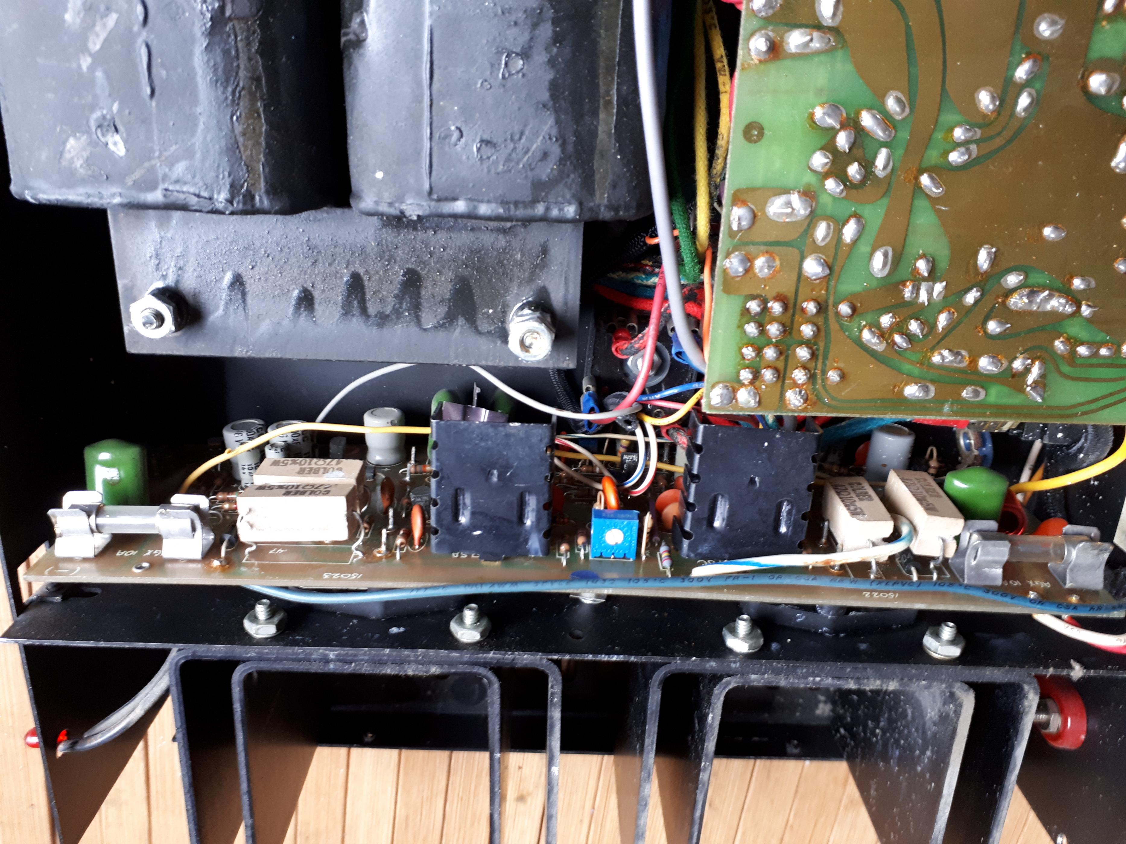

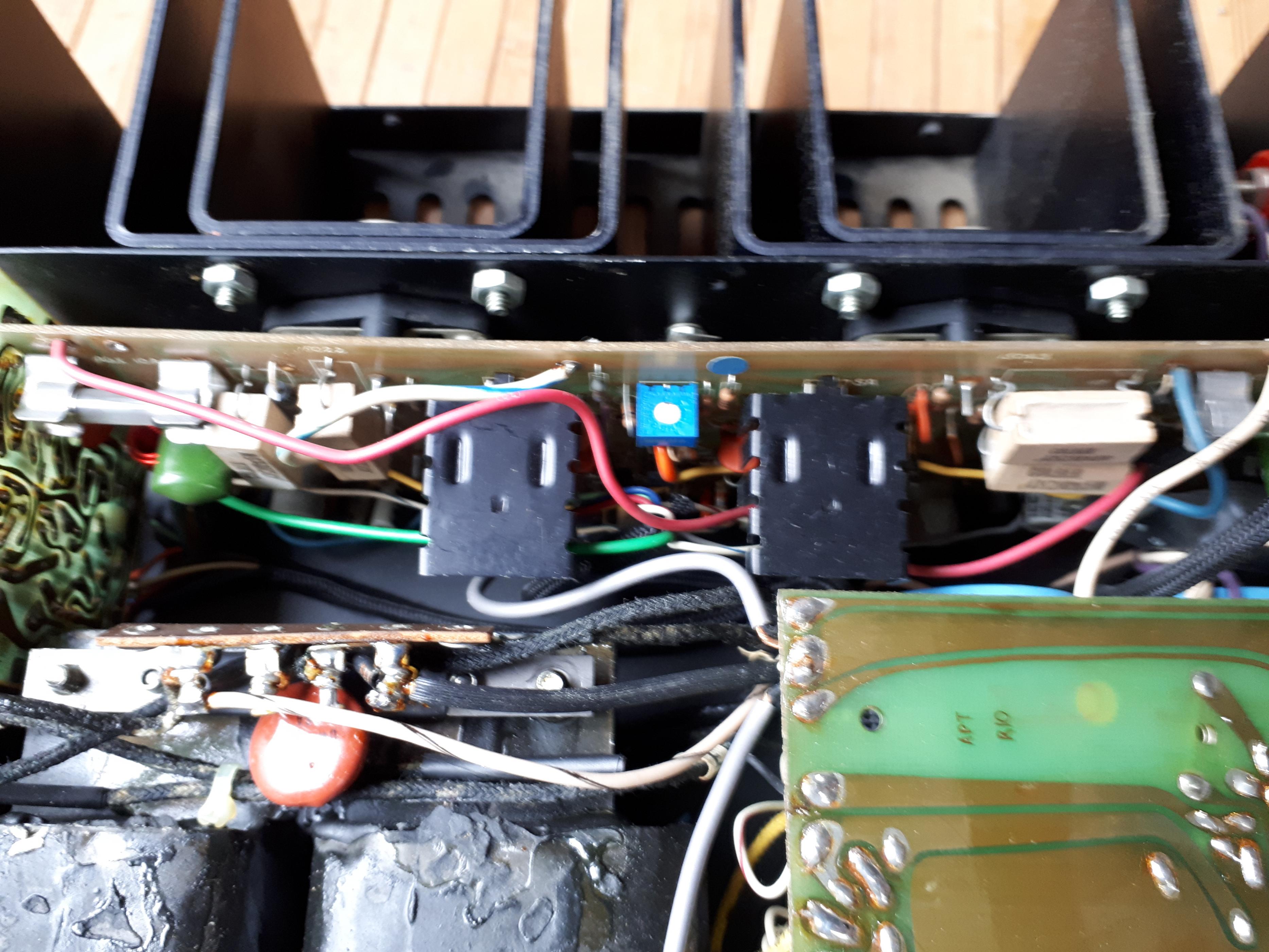

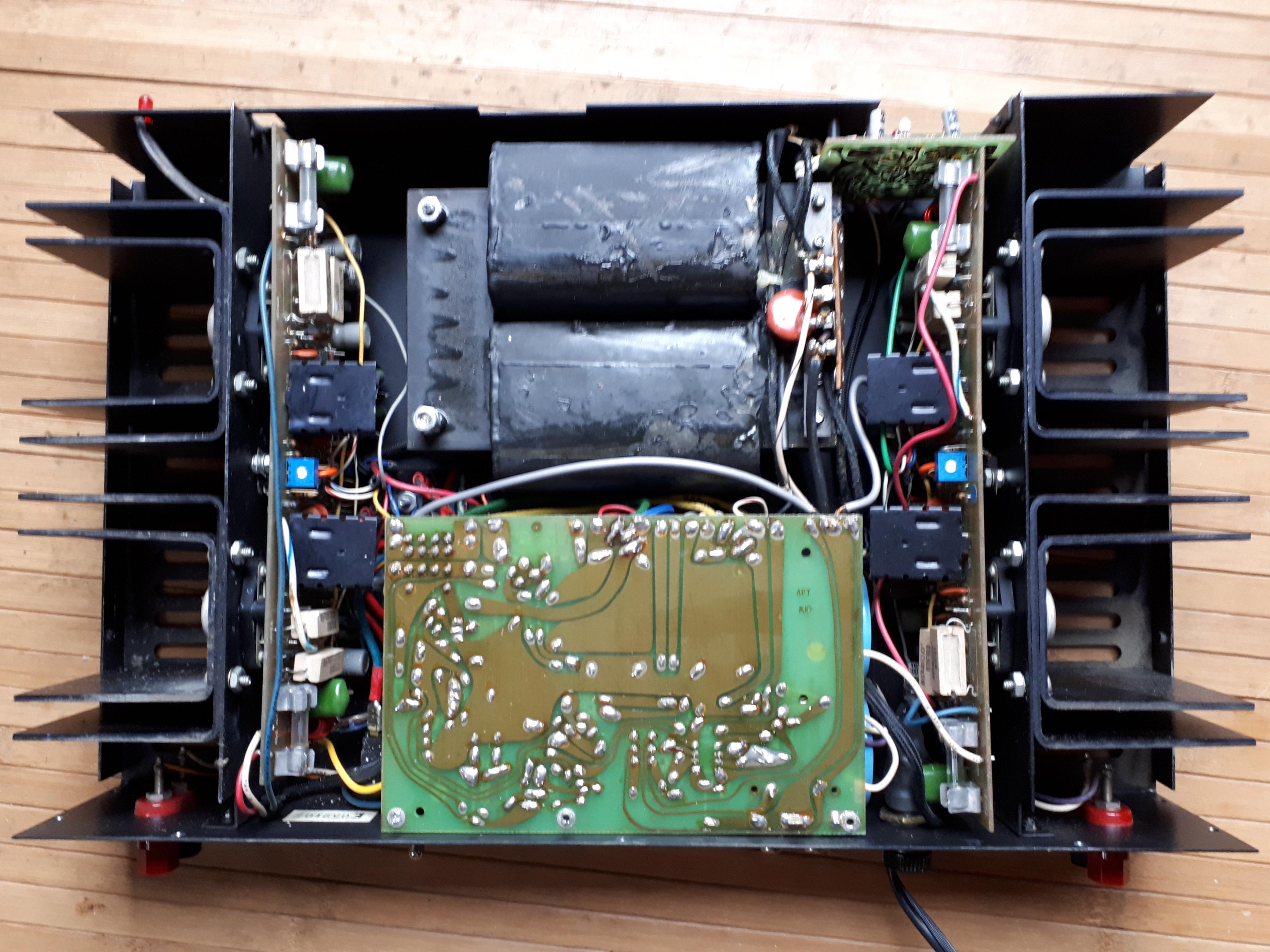

I have gear and experience, but at this point I don't think it's an actual problem. It looks like it's the way the wires are laid out inside the amplifier.

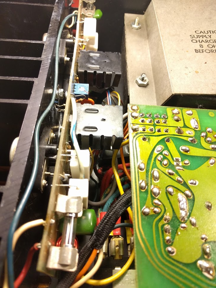

Most wires come out on the 'left' side of power board, so they are much closer to the left channel. All right channel wires are longer and have to go right beside transformer.
There is no real way to readjust those wires. The chassis is packed when the boards and heatsinks are screwed up in their final positions. I tried moving wires around with a wooden pick, and I can hear the change in buzzing for sure when the wires are being moved. There is just not much space to reroute those wires.
Ideally I may have to take out the right channel assembly, the power supply board, and reroute the wires as from the transformer as possible, which will move them by a few mm at most.
This is what it looks like inside between right channel, transformer, power board, and filter caps under the power board.

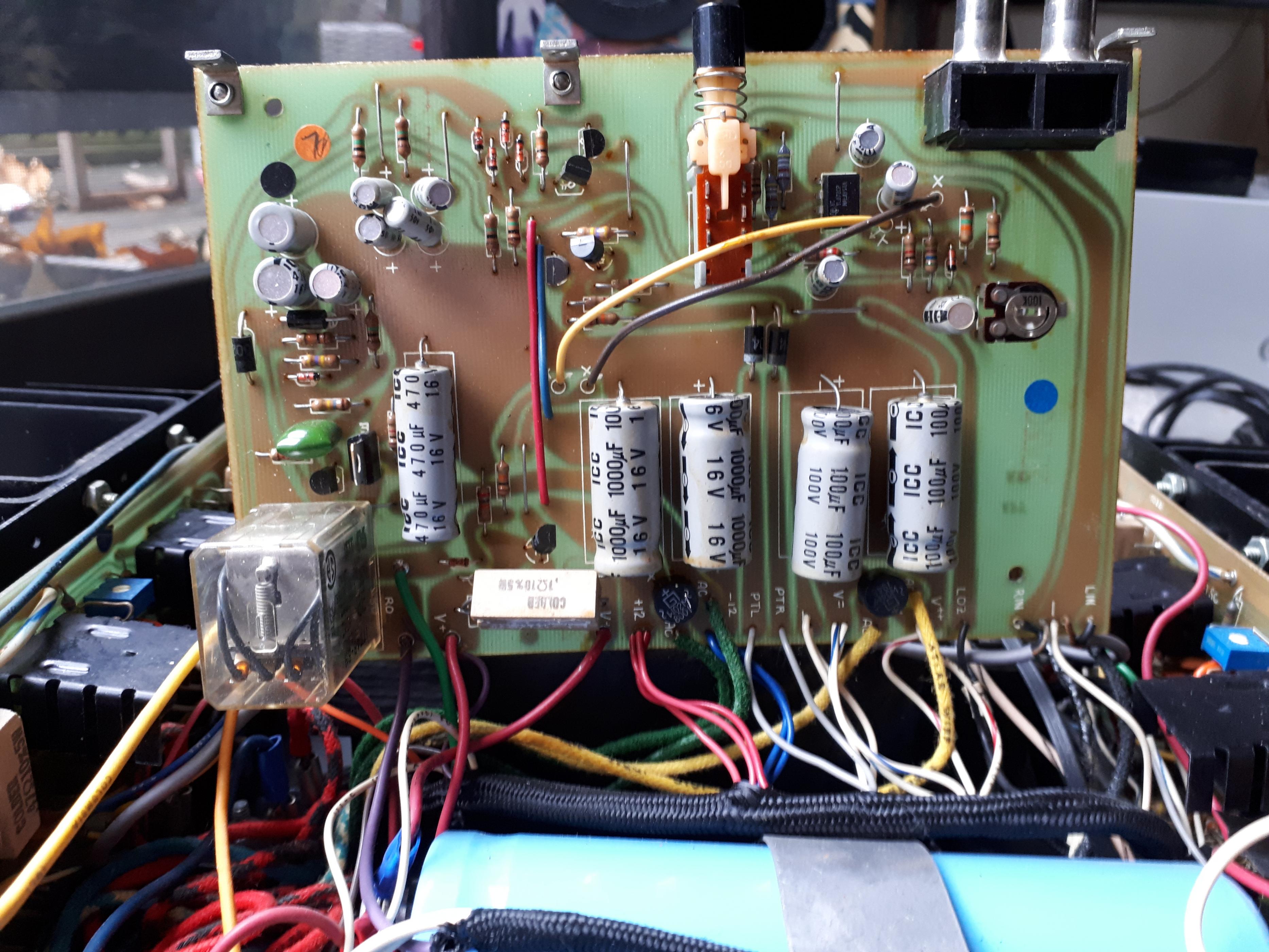

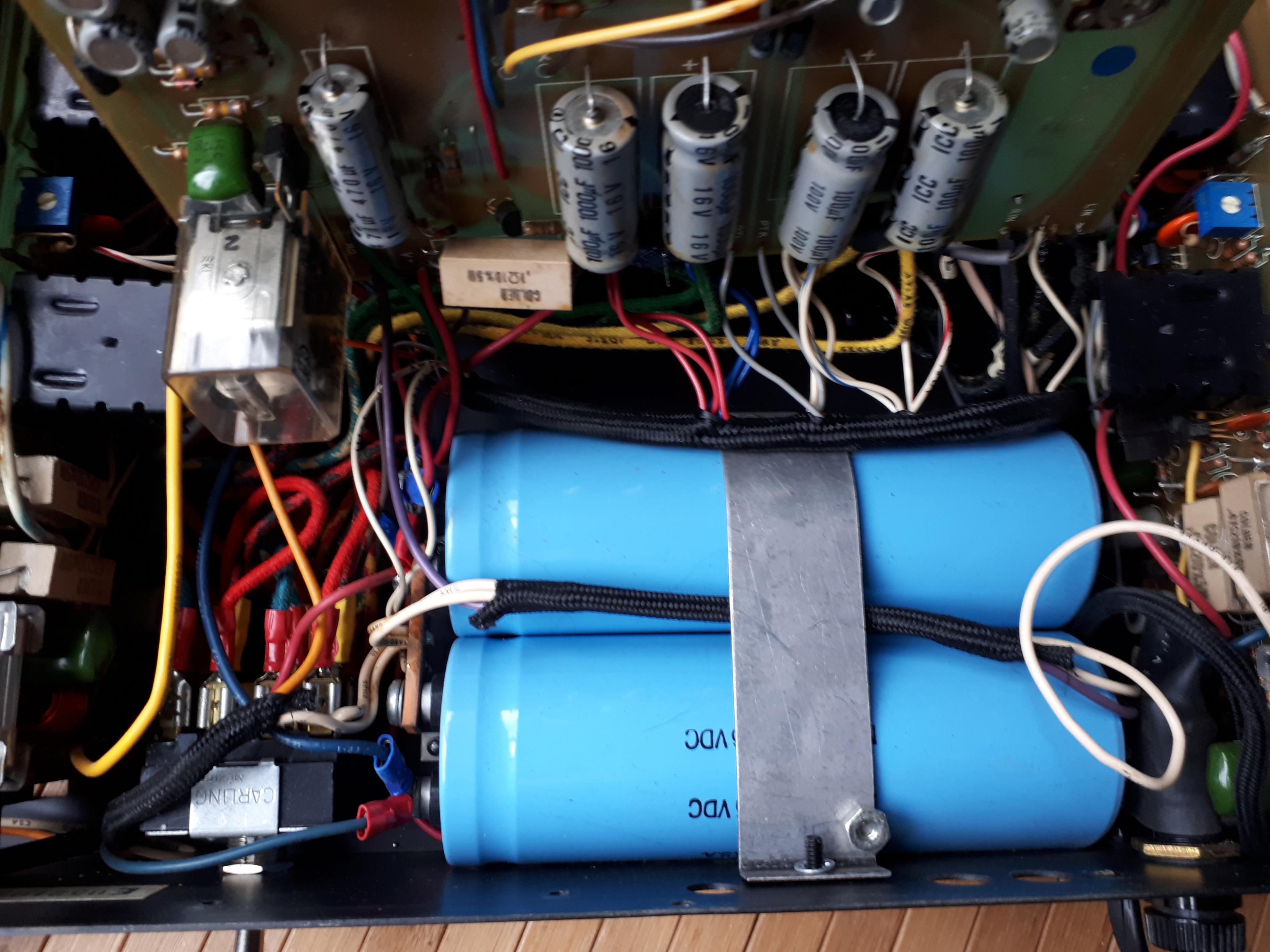

Couple questions about the amp. My left channel started humming, so took it apart and found C26 had gone bad. Left a mark on the board so easy to spot. Ended up pulling all the caps on both boards and am re-capping.
Things I noticed. C16, the 100uF cap on the + input of the diff amp seems like it should be non-polar. I am replacing with a non-polar.
R6/R13 were 39 ohms not 360 as specified in the schematic. I assume 39 is correct.
Q7 on the left channel with the bad cap had a beta of 60 and I was expecting closer to 200. I am replacing it with a MPS-A42 just to be safe.The zener was ok.
While I was looking around I noticed Q2/Q3 on the right channel had a beta imbalance. One was 80 and one was 200. I ordered about a dozen A42's, and am thinking I will find a close matching pair and replace the right channel Q2/Q3. Seems like a diff pair should be pretty tightly matched.
The only other oddity was the NPN output devices were all around beta of 50. But the PNP's were wildly different. Each channel had one device with a beta of around 80 and one with a beta of around 35. Is this a problem?
Thanks if anyone is listening
So after recapping both channels and replacing Q7 and replacing most of the resistors with metal films while I was in there, no change. Disappointed is an understatement. Output was still running -1.5V and humming. So next I replaced the Q2/Q3 diff pair, the current mirror and the cascode pairs. After that, things got better, output offset is now -.5V, but still hums. So next, I added a 2nd 47K resistor across the input because the base of Q1 on the left channel was around -.2V while the right was -.144. By adding the resistor, I got the base voltage to -.1V. Hum stopped, output was around -50mV. So I think what was happening was the DC servo op amp was saturated (it was -9V) and was letting ripple thru causing the hum, instigated by low beta of Q1. Although measuring Q1 with a transistor tester came back around 300. Q4 was hotter and measured 380, so maybe it is the mismatch.
