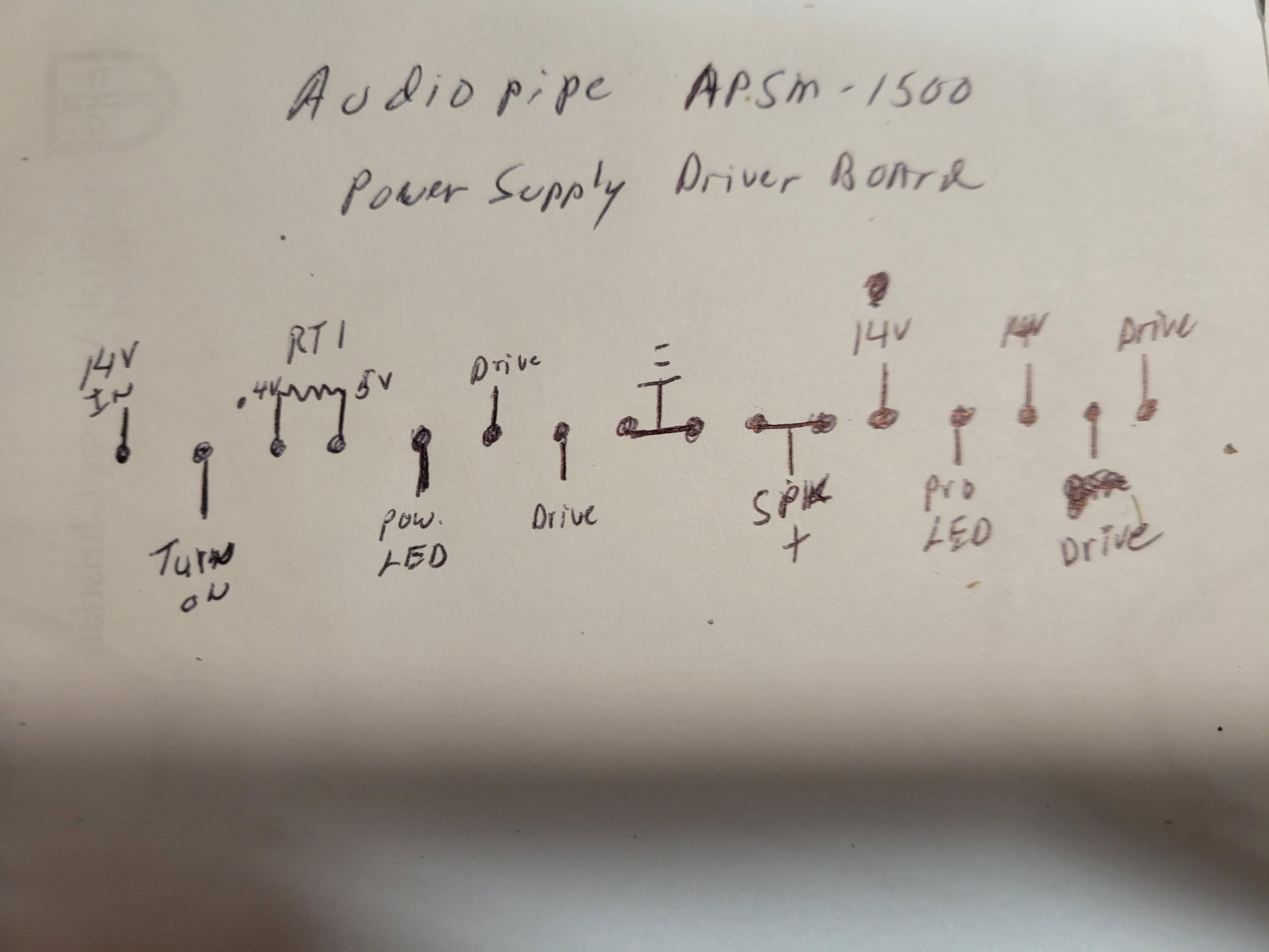

Working on an Audiopipe APSM-1500. Goes immediately in to protect when powering up. No shorted outputs or mosfets in the power supply. No drive to the gates of the power supply mosfets.Anyone have a schematic of the protect circuit?

I just happens to have the SAME amp with the exact same issue, just different brand name (amps are identical 1:1).
I do have new 100% working driver supply cards, tried 2 new ones. Same issue. Goes straight into protect. I worked really late last night on this amp and can't remember clearly but there was unusual voltages at pin 15 an 16. This led to 5v internally to pin 3 for the TL494.
Grounding pin 3, makes the amp come alive and there is a nice gate drive for the PS fets. There is something else on the mainboard leading to protect scenario as i've tried 2 new power supply boards and the amp exhibit the same issue.
The schematic is not accurate. Trying to trace it on the driver board. I know it feeds out of the driver board on pin 5 or 12 depending on the numbering of the board. It goes to R50 and R44 on the main board. Up close to the output driver board. Let you know what I find.
