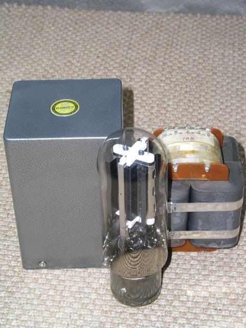

clone Ongaku OPT protype funish already.
this one was use 0.1mm ultra hi-b core for 10K 30W OPT.
this coming week I test & directly compare with my tailor order Tango X-10S.
pls wait for a while.

hi wrenchone,
this will be iron for clone ongaku.
I made this one use 0.1 mm ultra Hi-B CORE + secondary was silver wire.
