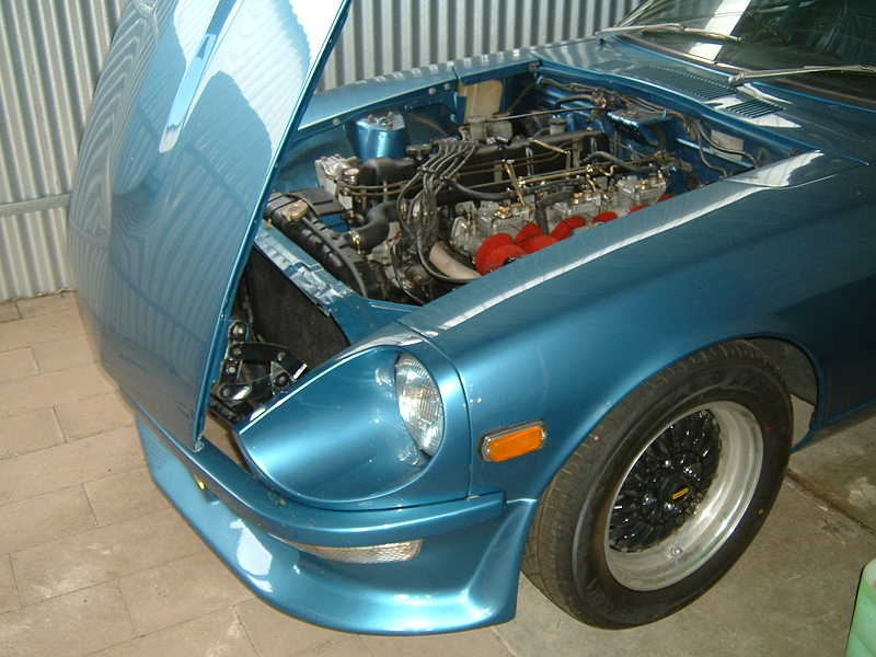

I never thought about until now, but the air horns on the Webber carb in my ’69 Mini look just like the flaired port in my subwoofer.
I imagine there’s a lot that can be done with aftermarket parts to improve performance and tuning using acoustical modeling. However, there’s a ton of variables under the hood of a car that one doesn’t have to deal with in a listening environment. I also imagine the car manufacturers perform extensive tests and tuning to optimize performance and economy. Unlike what the conspiracy nuts will tell you, I highly doubt that there are substantial gains to be had that will not result in deficits somewhere else. Huge exhaust = noise, popping, and size limitations. Huge intake = noise, worse idle, lean running, etc. Exotic cams and variable-valve-timing = cost, complexity, poor idle, etc. With naturally aspirated engines, I think there are a lot of improvements in head design left to be done to improve volumetric efficiency. I saw an article on a cylinder head that used some sort of rotary ball-valves that greatly reduced friction, improved valve actuation speed, and improved the directionality of airflow into/out of the combustion chamber. The head was also thin and light. I haven’t seen anything about it in a long time, so it either doesn’t work, or there were issues with sealing the valves, or Detroit killed the inventor – who knows. . .

Ahhhh…yes, it’s all about breathing.......I agree with most of what speedsmile said.
2 litres is still a bit small for +300bhp normally aspirated. It would be possible, but you’d have to absolutely rev its tits off.
I got a good 280bhp from 2.8 litres (6 cylinders) at about 7000rpm in my 260Z coupe, putting the car in the 12 second standing ¼ mile bracket. Fully (and I mean fully) ported cylinder head (and intake manifold), OS valves, triple DCOE45 Weber carbs, a rather wild cam and a big, free flowing single exhaust is all it took. Had a real nice, broad spread of torque too, happily pulling hard from well below 3000rpm. Would do 155 mph, redlined in 5th before I put a 4.625:1 diff in it to give a better launch off the lights.
I’m currently rebuilding the Zed’s engine to run on LPG though, with my own custom intake manifold design.
Here’s my daily driver:
http://users.picknowl.com.au/~glenk/COMM.HTM
The 5.1L engine makes a good 250kW / 600Nm on LPG with a stock bottom end – just ported the heads and intake manifold, fitted a rather mild hydraulic cam and a big 3” single exhaust system. The car is good for an easy low 13 sec ¼ mile pass, flat 13’s ideal (car only weighs 1350kg – that’s 45kg less that a current Subaru WRX, for example [The Zed weighs 1080kg]).
The intake, heads and exhaust still flow a much greater capacity than what’s being taken advantage of though with the current displacement and camshaft.
I’m currently organising the parts for 383 cu in stroker kit, 10:1 comp and a much hotter solid lifter camshaft, with a reasonably modest duration, but a very high lift and very high velocity ramp rates, for heaps of bottom end torque.
350kW and +800Nm should be on the cards when it’s finished.
Glen
