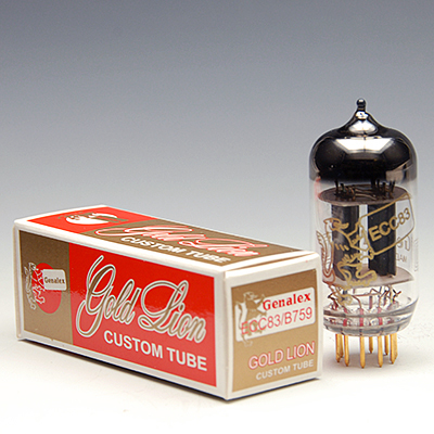

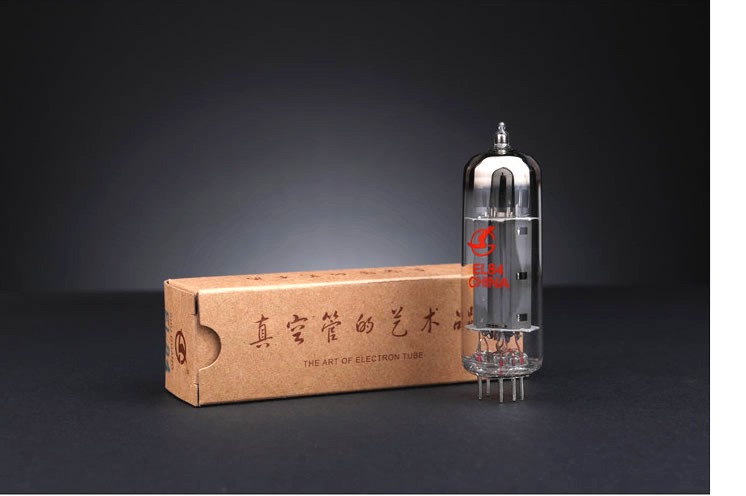

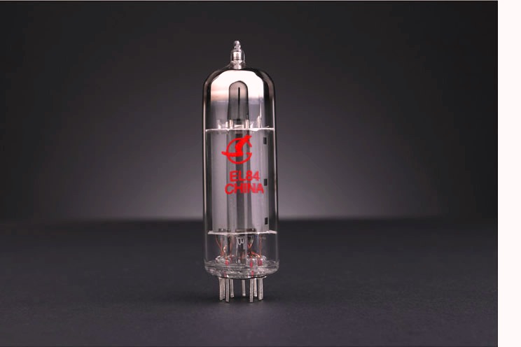

New Year Special Offer:
APPJ PA0901A amp + Gold Lion (Genalex) Re-issue ECC83(Made in Russia) + Shuguang EL84 =USD190 + shipping cost
Black and Silver colors are available.
*** The special offer is valid until 31st, Jan., 2014.
