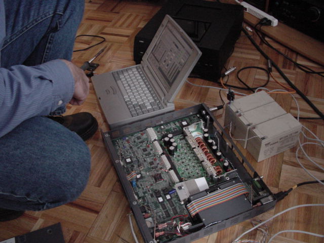

As the perfect solution is still not available how about this:
An older EV DSP with freely configurable internal signal flow with gain, iir filter, crossover, mixer, delay, dither modules - married through i2s to a Panasonic digital amp board in box with battery supply.
Digital input with clock sync to transport. Analog inputs can be added as modules, but not in use now. The DSP has 8 output channels but I'm using only 5 for the 5*130W output.
PC configurable, but without the pc there are two buttons for volume up/down.
Total cost is ~$300.
A two box system (transport plus this box) for a fully digital multiamp chain.
