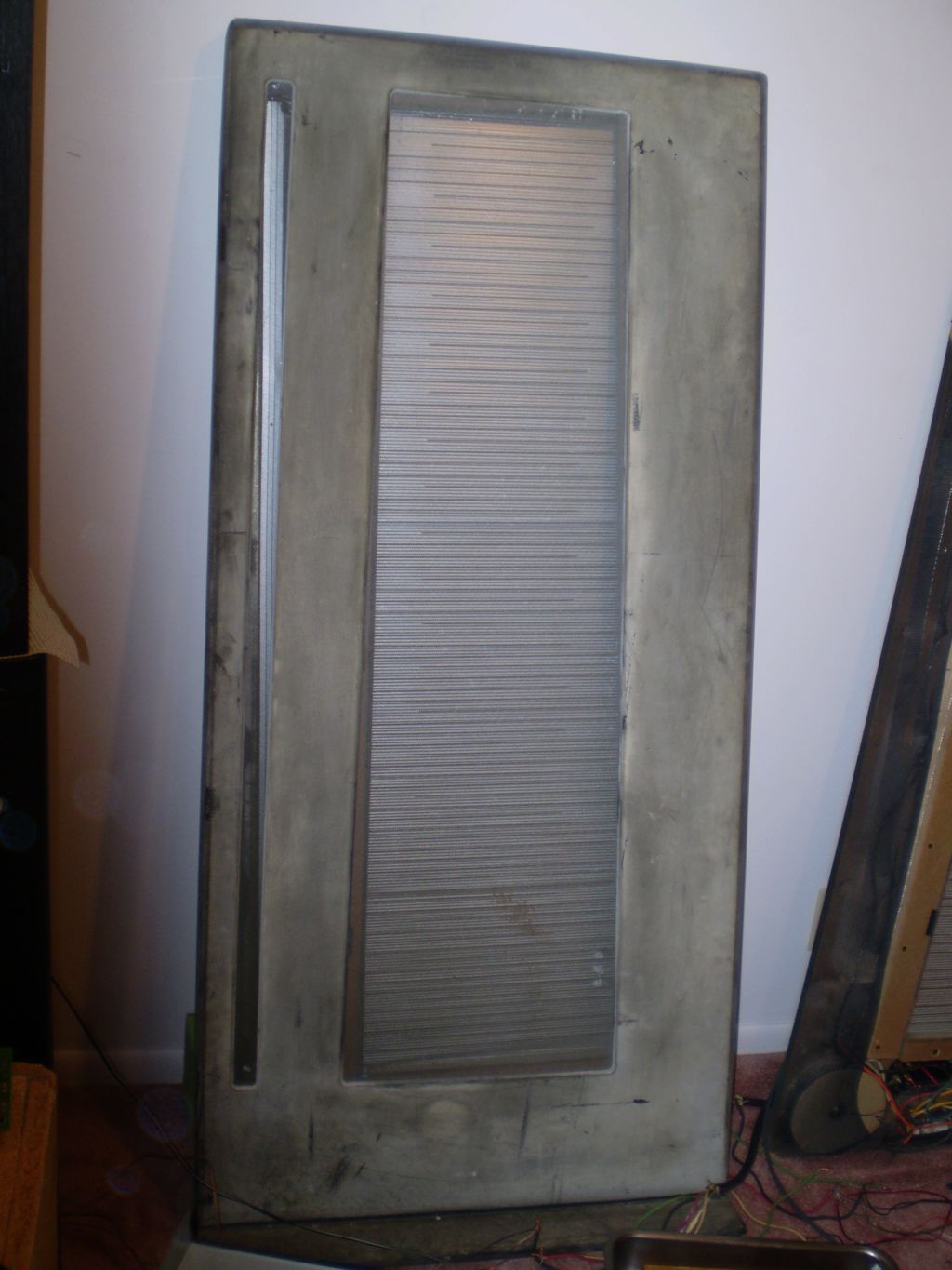

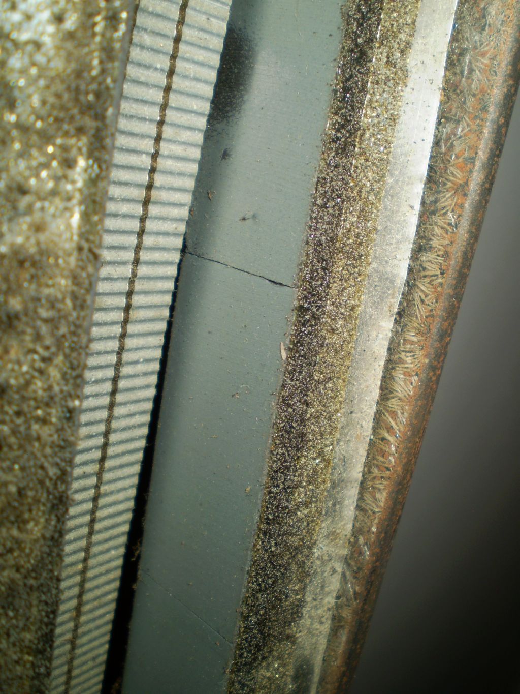

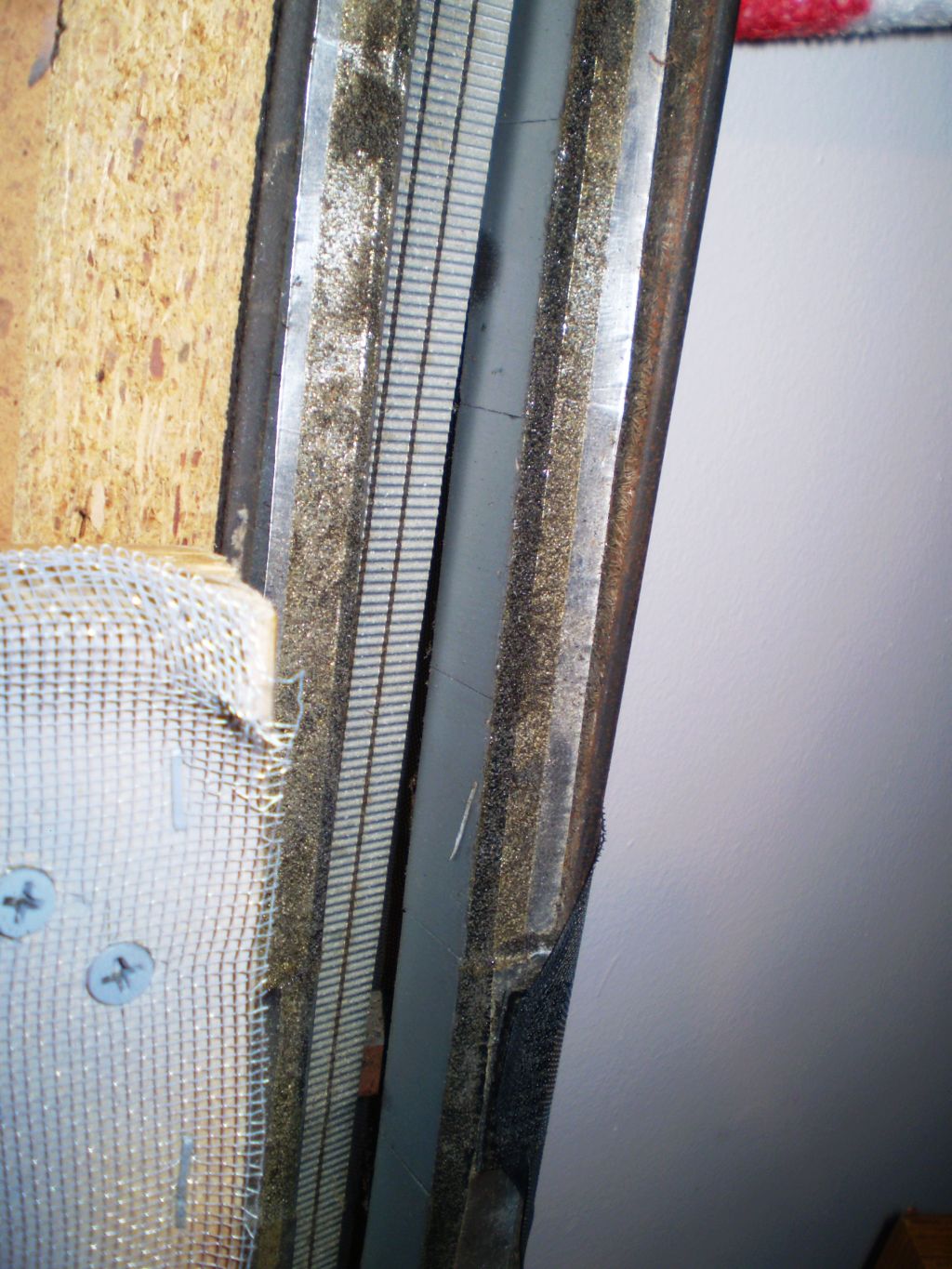

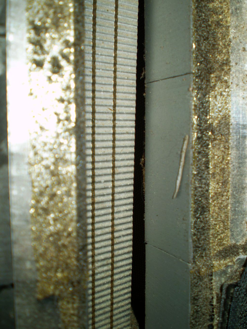

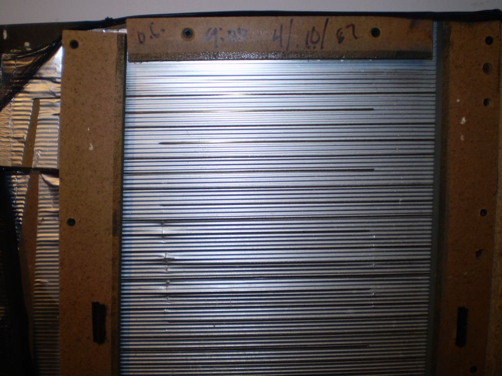

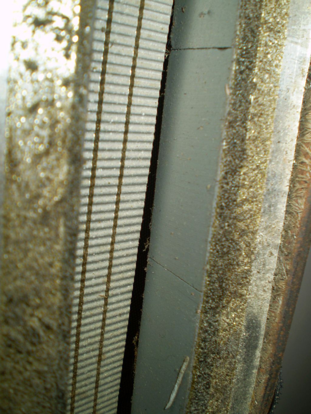

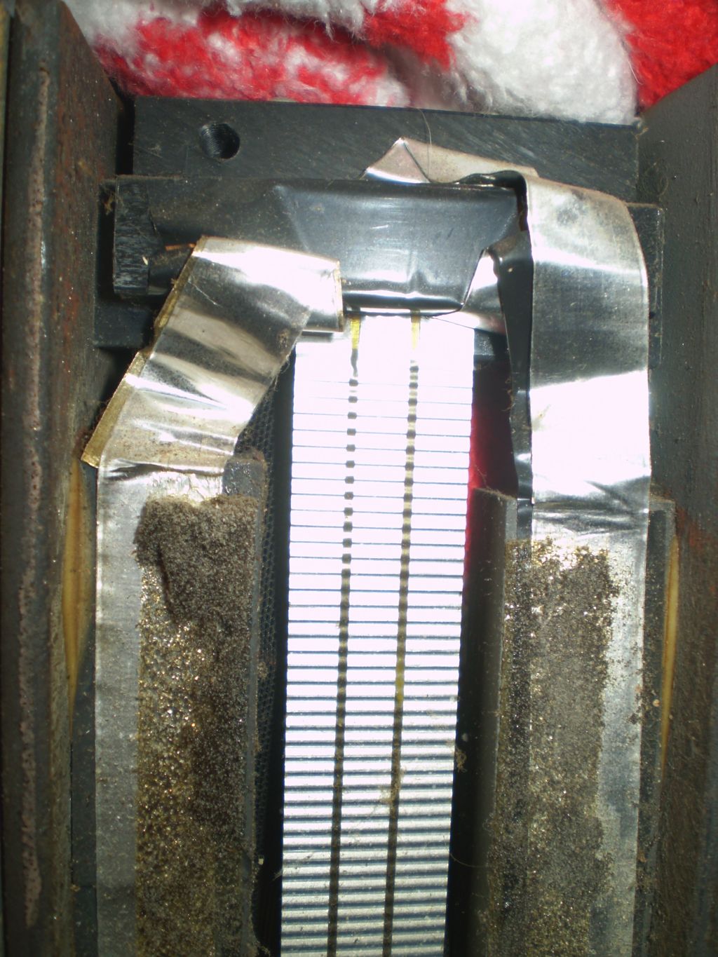

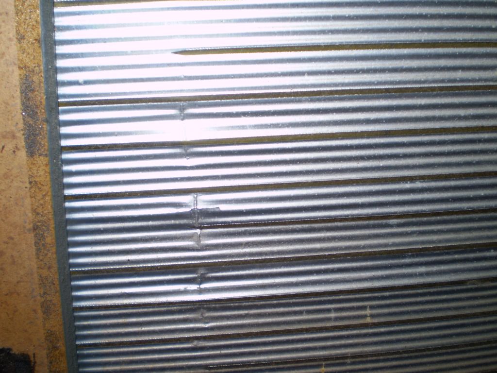

Here are some close ups of the ribbon and magnets, I tried to get an extreme closeup but the Focus was giving me a bad time!
But I can at a later time as I have a few ways to get almost to a microscopic level with it.
These are Duette's.
I got the info by doing some Digging and it was sent to me email from a fellow DIY'er earlier this year in a PDF via Email.
I will dig it up for you if you wish.
I hope these are of some help to you!
Enjoy, Jer 🙂

I like to see the steel structure. It appears to form a C shape an is closed at the top and bottom, meaning the center is cut open for the ribbon?
Can you take more pictures of the tweeter bottom and also the woofer section?
Very useful so far.
Very useful so far.

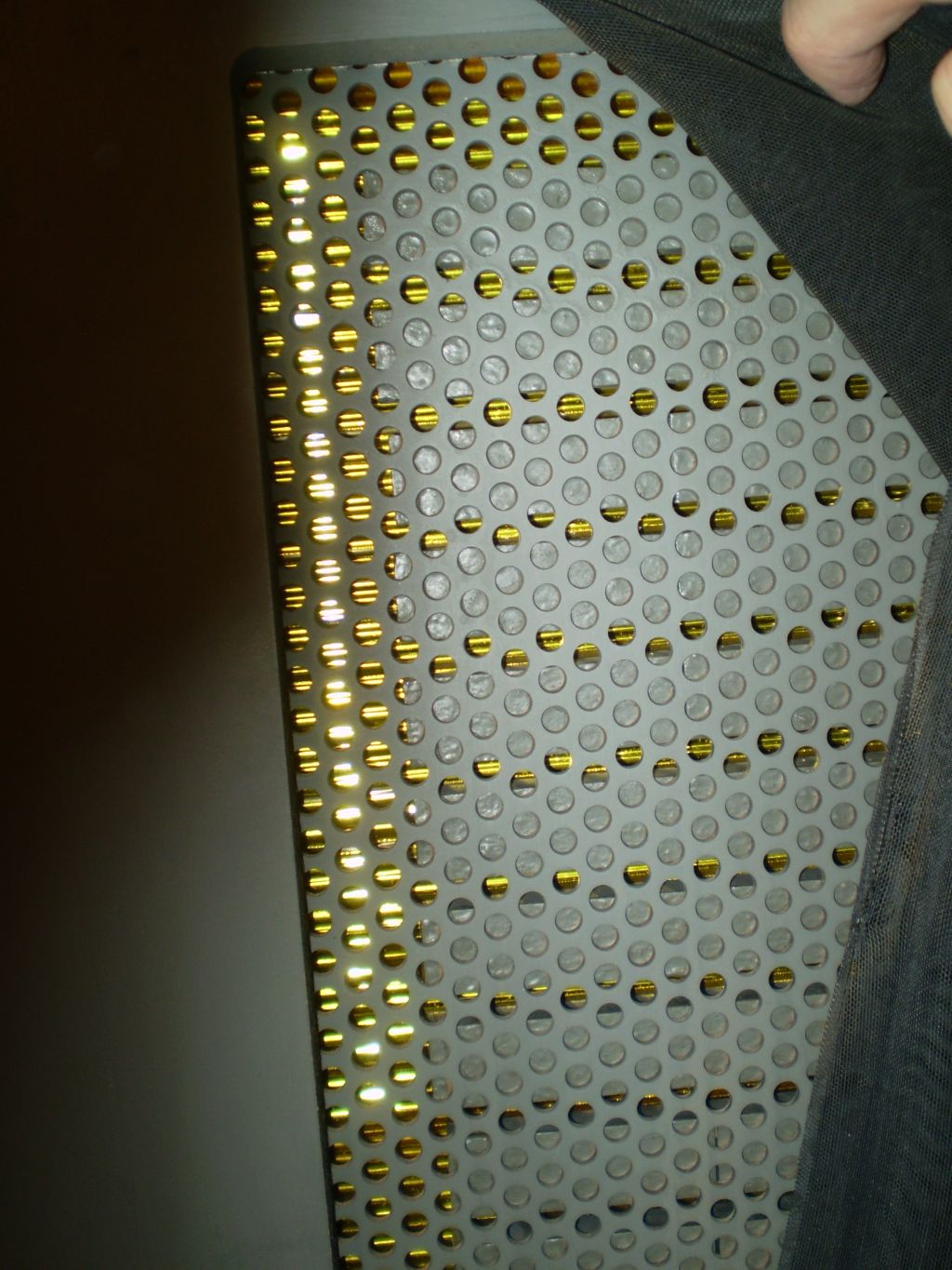

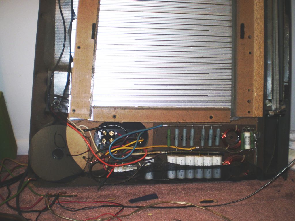

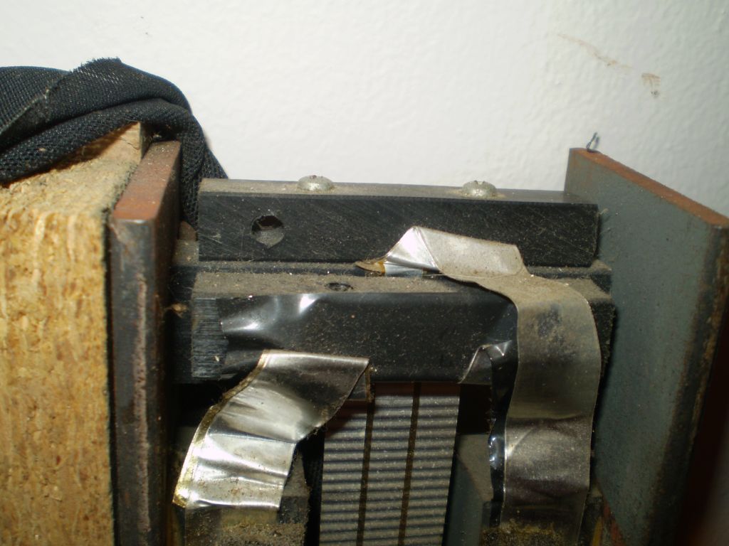

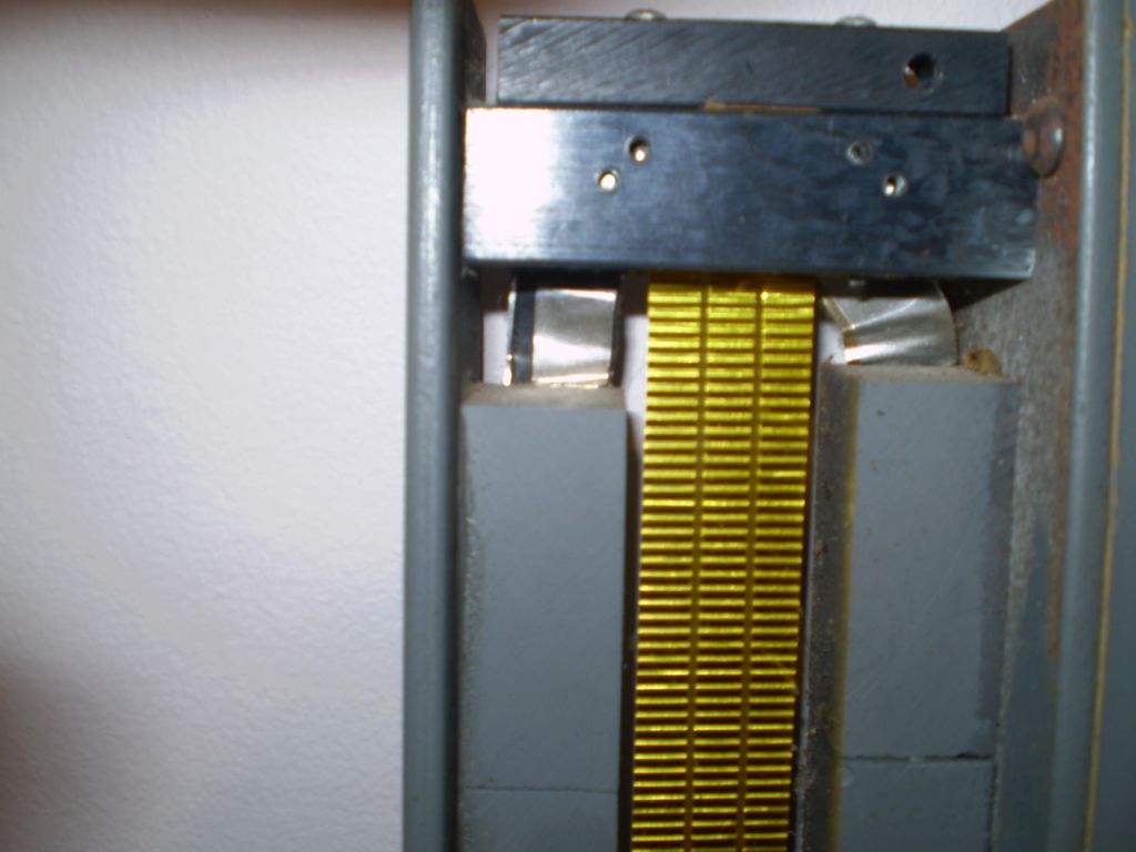

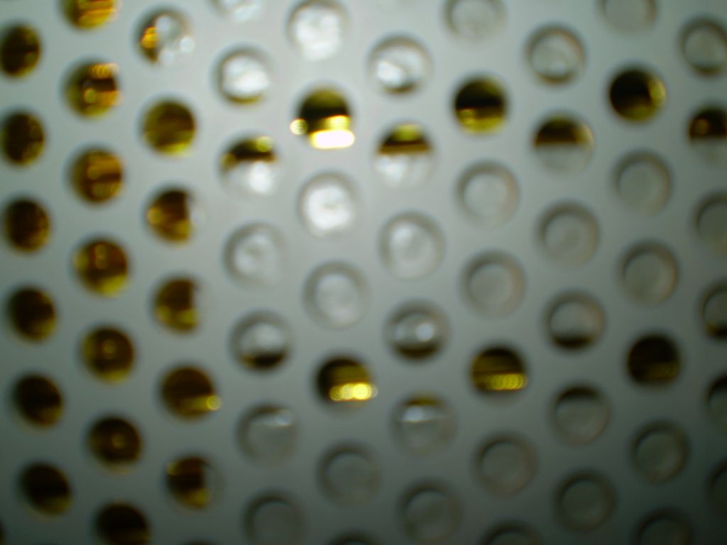

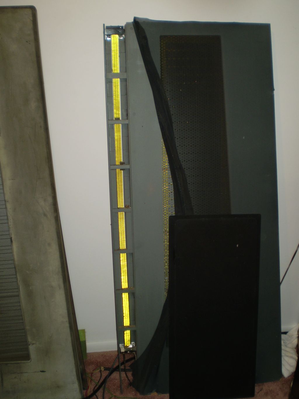

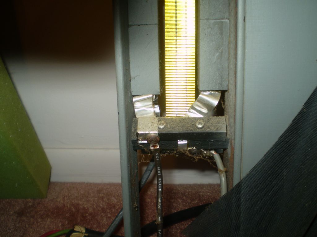

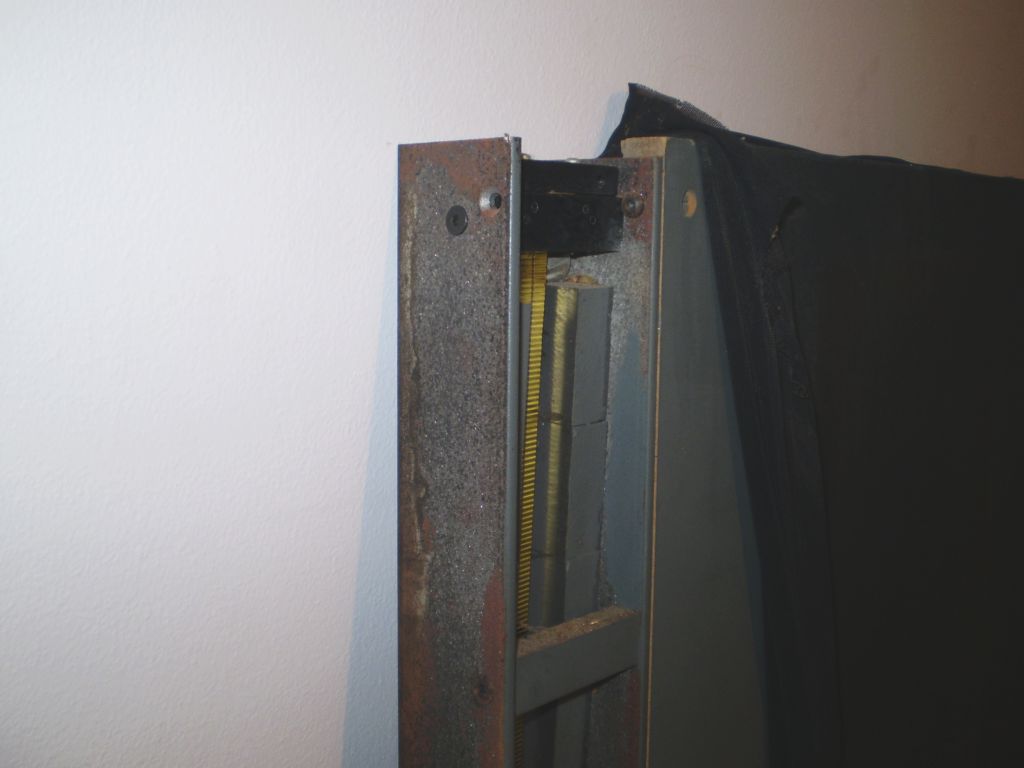

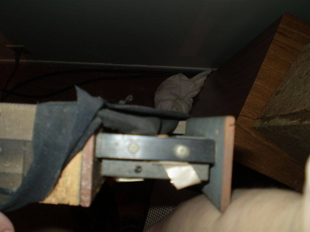

Here are some more pics and like I said before sad,sad, shape. 🙁
The magnetic circuit for the ribbon is open and there are No shorting bars at all anywhere in the structure.
the magnets are attached to 1/8" iron plate bars and the spacers are black plastic or phenolic or something.
I don't know if any glue was used or not as I haven't gotten into them very far yet.
Sorry the one picture that you wanted came out blurry but you can still make it out I would have taken another shot but my batteries died and I had to resort to an old an weak set in order to download the pics, Sorry. 🙁
I will try to get some more when I get a fresh charge on them.
Jer 🙂
P.S I stand corrected ,There are 7 1/2" X 1/2" shorting bars on the back side of the ribbon structure spaced evenly along the length of the ribbon I will flip it over and get a picture for you.
Jer 🙂

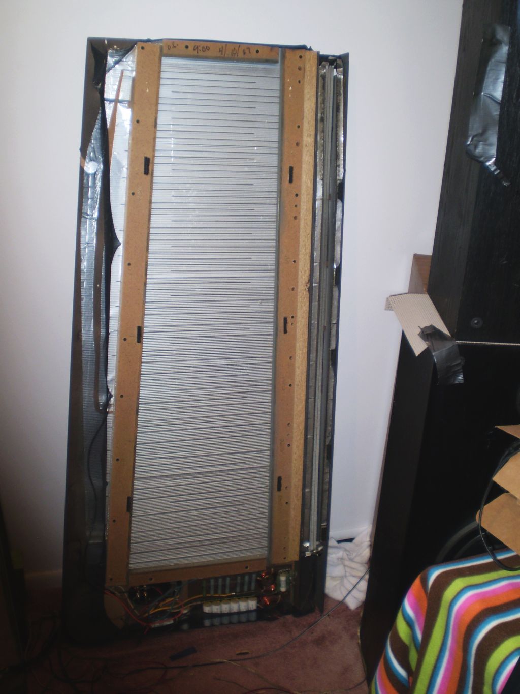

Here is the Backside of the Apogee Duette showing the magnet structure of the panel.
Note the seven shorting bars that I forgot that they were there! He,he
It is a very simple system ,But yet very Ingineous for the time I sure would like to hear a set of this made with some Neo's.

Great pictures.Are the shorting bars behind the tweeter ribbon?

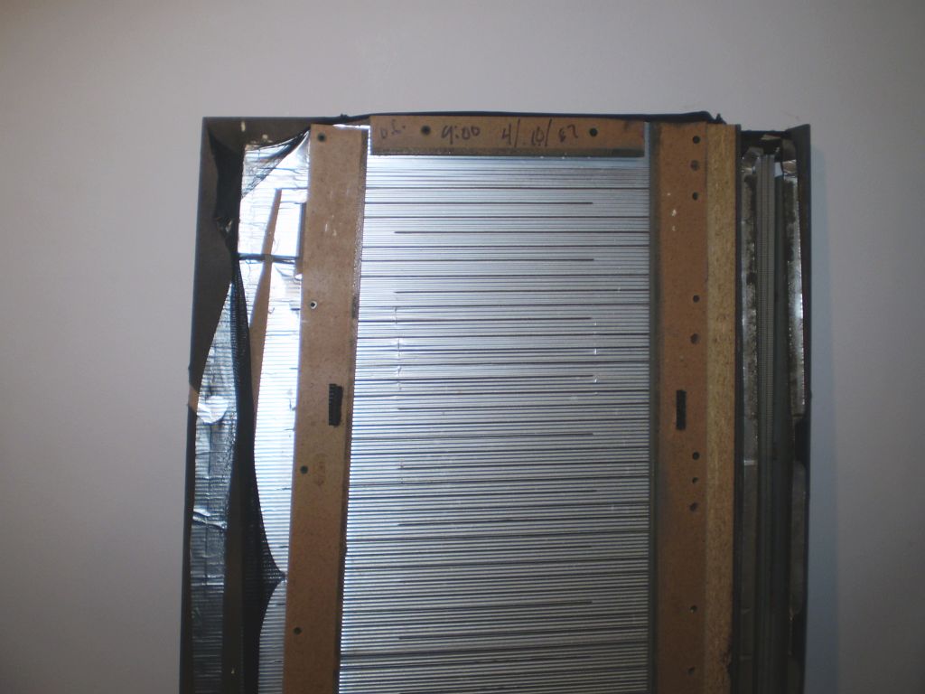

How about the magnet structure for the woofer?

First of all, there is much steal and weight in the tweeter section. Believe me!
Next, the bass structure is so heavy You would not believe.
One person said that that's why they are so much better then Magneplanars from Magnepan. And that's so true.😉
You should know that the magnets themselves are quite heavy. Not to mention the very thick hole plate they are glued to.
If You try to knock on the hole plate in the back of the bass panel, it is totally dead and thus have NO resonance what so ever. That is VERY good indeed!
Try doing that on other planars. hehehe
Maybe will this give you an idea,
Tweeter section,
2 - 2" x 3/16" iron plate.
48 - 1 7/8" X 7/8" X 3/4" ceramic magnets.
7 - 2 3/4" X 3/4" X 1/2" steel support bars.
Woofer panel,
1 - 1' X 4' X 1/8" preforated steel panel.
123 magnets in a 41 X 3 arrangement.
Crossover,
1 - 6" dia. and 2 - 3" dia. all copper inducters plus capacitor,resistor and other hardware.
And enough wood for 2 1/2 layers of 2' X 5' X 3/4" MDF !
Not much but it all adds up.

Yes, The shorting bars ar behind the ribbon.

No,I am not going to redo the frames,
I just want to some how retension the woofer section if I can as they have a slight rattle.
I don't want to damage the original Diagphram or have to try to replace it.
Trying to locate just a 12' X 18" X 1mil piece kapton may prove to be very hard to acomplish not to mention the cost.
I have some 1" and 3" or 4" stuff and it is an extremely durable material.
It has been said that their edges are suspended by foam and all of the foam that exsisted has now withered away.
Unfortunately there is no easy way to get to the backside so that I can reform the creases and redo the edges.
Inorder to do this I may have to cut the MDF frame inorder to lift out the magnet structure and then remount the two pieces on a new backing piece.
I am not quite sure yet on the process I will choose yet,But it might be the only way to go as I really don't want disturb the diagphram and its mounting frame and geometery as it is not that badly damaged yet and still works.
Also when I first got them home I didn't have them properly setup and they were just leaning against the wall.
And the extra backwave preasure could have been the cause of the rattling as well as from being overdriven abit much as they are 14 feet from my listening position and suffered greatly from dipole cancelation in this configuration.
There as also the possibility that there may not be anything wrong with them because the amp ( an Ashely FTX-2000 ) started to devolep some probelms and eventualy quit working on my main stack of speakers and that was when I had to switch everything over to my Crown DC300a.
a.wayne,
I agree, The returns should be run outside of the magnetic field as to not modulate the field even as slight as it may be, Also I believe that some form dampening may occur to the signal as well if it is routed within the field.
The returns on the ribbons are run along the tops of the magnets on their centers, Although they are not directly in the magnetic circuit, IMHO I think that it is still to close for comfort and that it is just heavy gauge aluminium tape stuck directly to the magnet with no insulating material between the conductor and magnet assembly.
I find this to be a pis poor design although it has been working since 1987 when they were built.
Any Thoughts? jer 🙂
a.wayne,
Any Thoughts? jer 🙂
