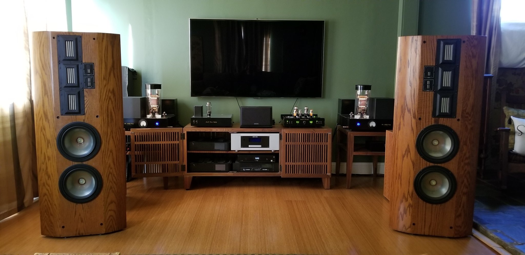

I have a pair that allow me to drive my big Infinity RSIIb speakers (dip to 1.6 ohms in places) with SET monos.
200WPC SETs, but still SETs.
See picture.

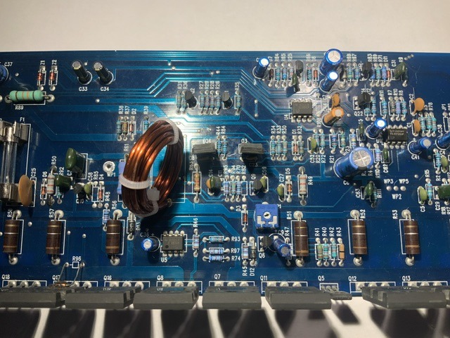

Use a Sunfire 300-2 amp and change out the air coils on the amp cards only, not the TDC!
Use 11 gauge on a 1” former 31” long magnet wire along with changing R49, R50 to 1.8k 1 watt for both amp cards (4 PCs.)
Relaxes the protection limit
Runs cool as a cucumber and sounds like an ultra smooth high powered tube ampIMG_1688.jpeg

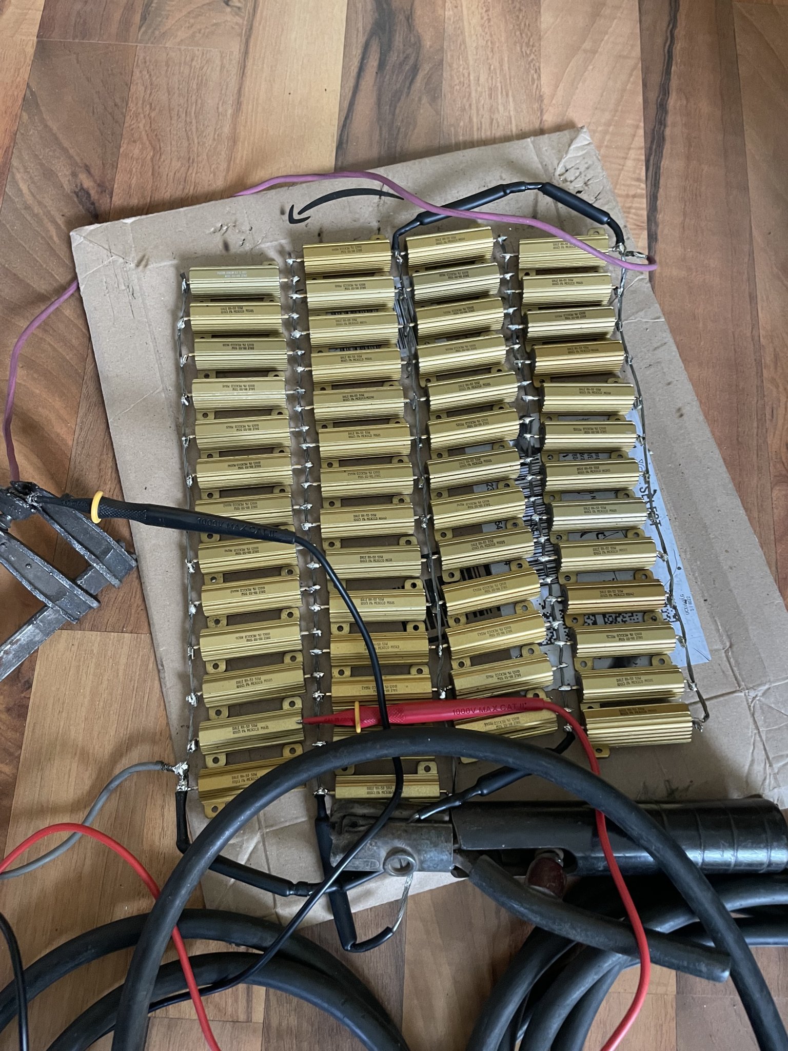

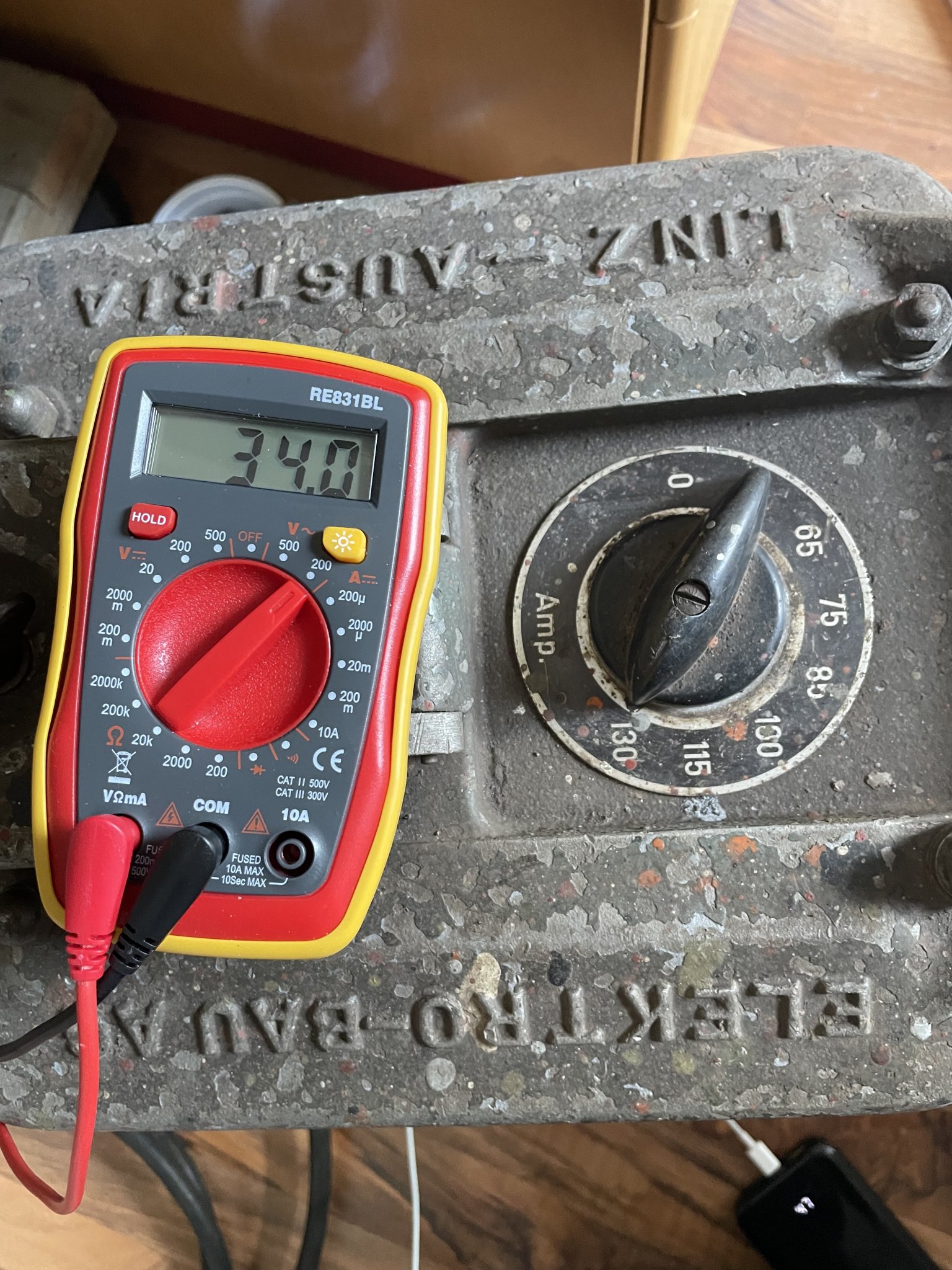

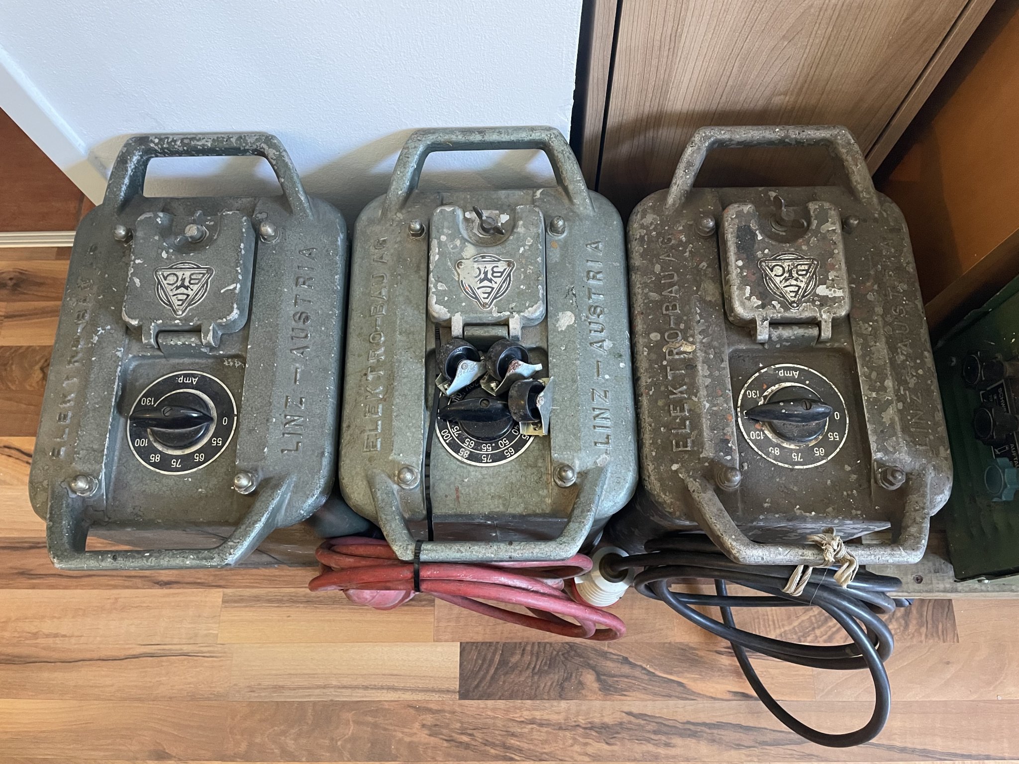

🤣I happened to have a few vintage arc welders, that was actually what prompted me to this current round of audio DIYing after my absence of 30+ years, trying to see what I could do with them.
They hum, but not quite in unison🤣 perhaps you know a way to stop them humming?
